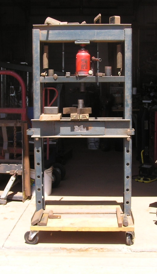

Good work, bumper!
And you could probably even use that mobile "press" to go rv'in in a pinch.

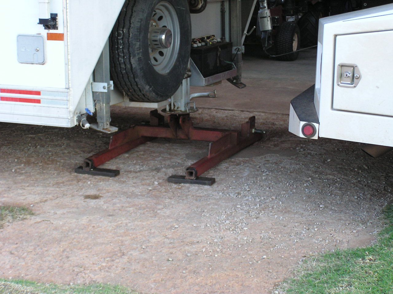

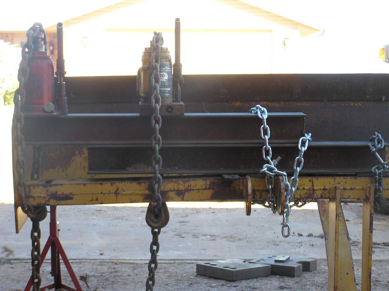

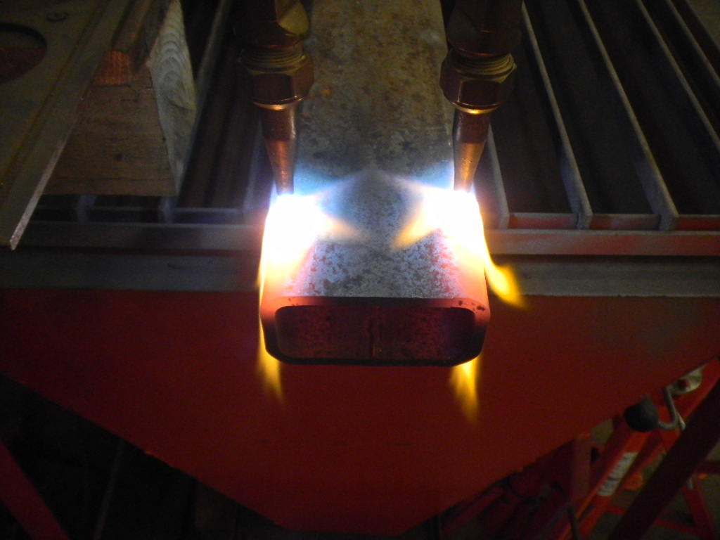

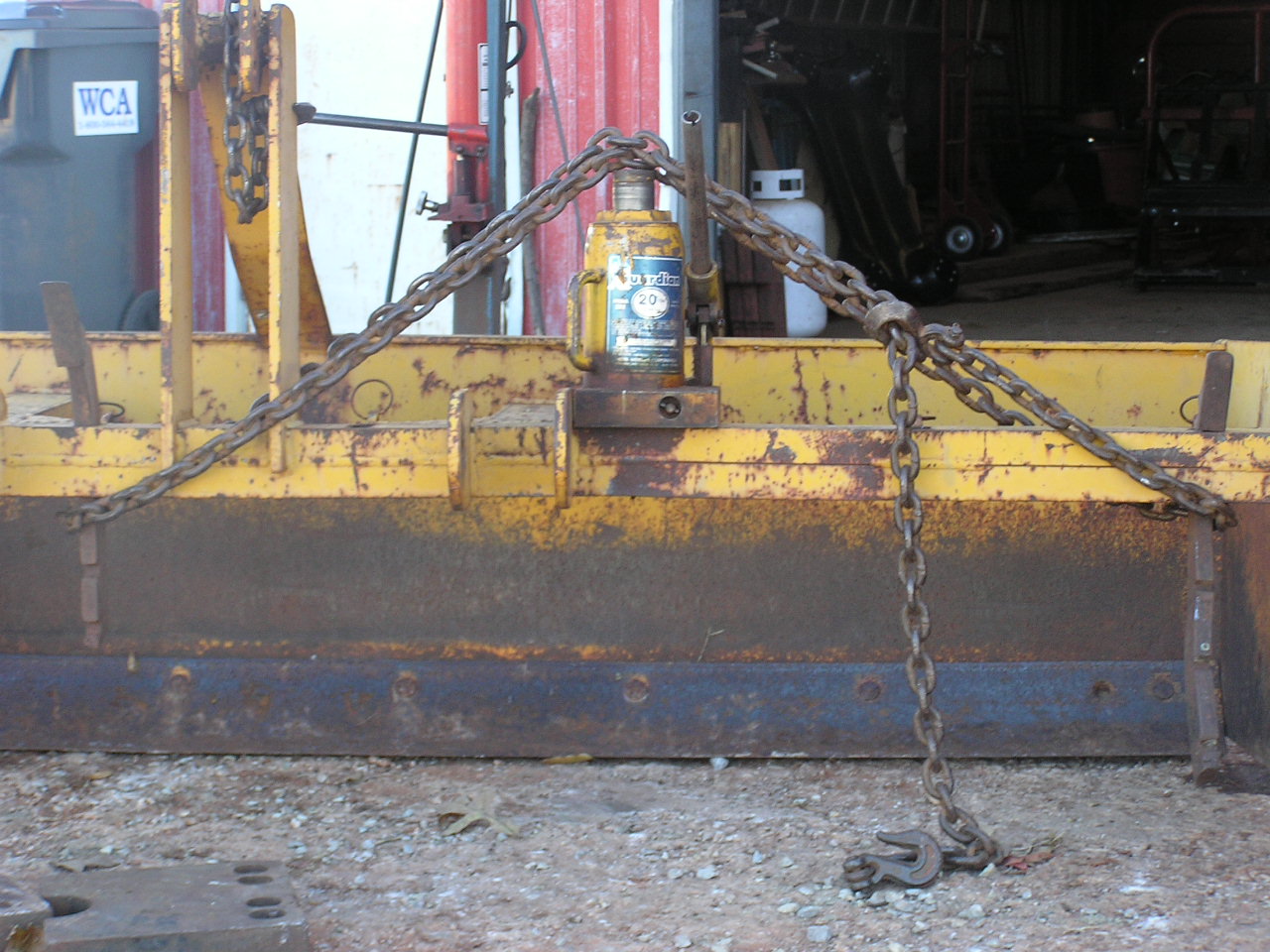

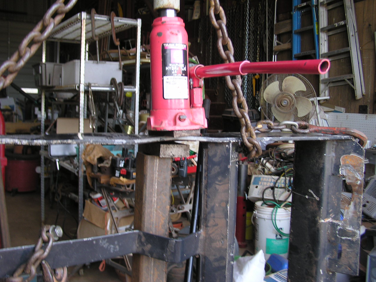

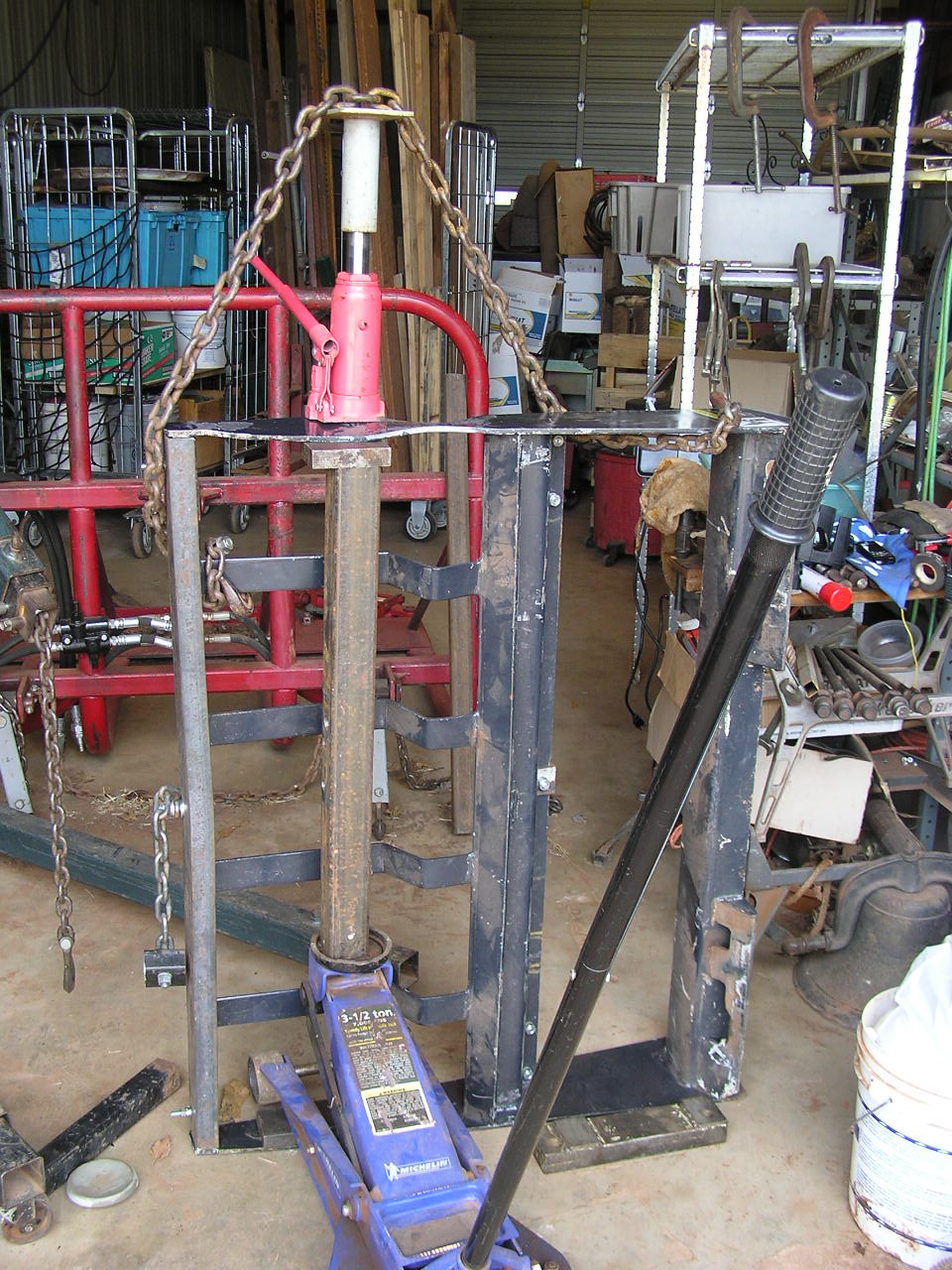

Xfaxman you are working way to hard! You need to get an oxygen & acetylene torch, and this book. Learn how to heat shrink material.

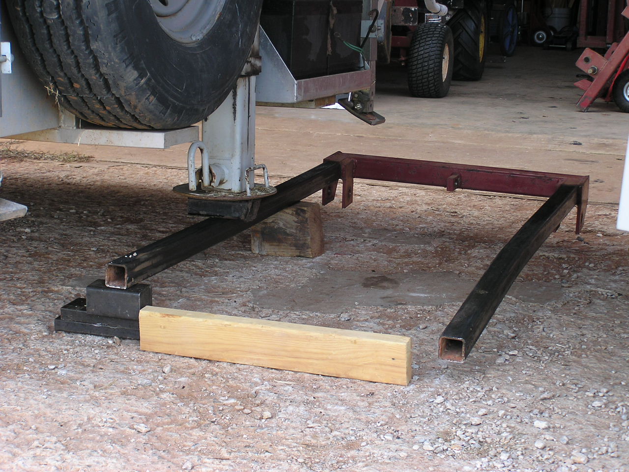

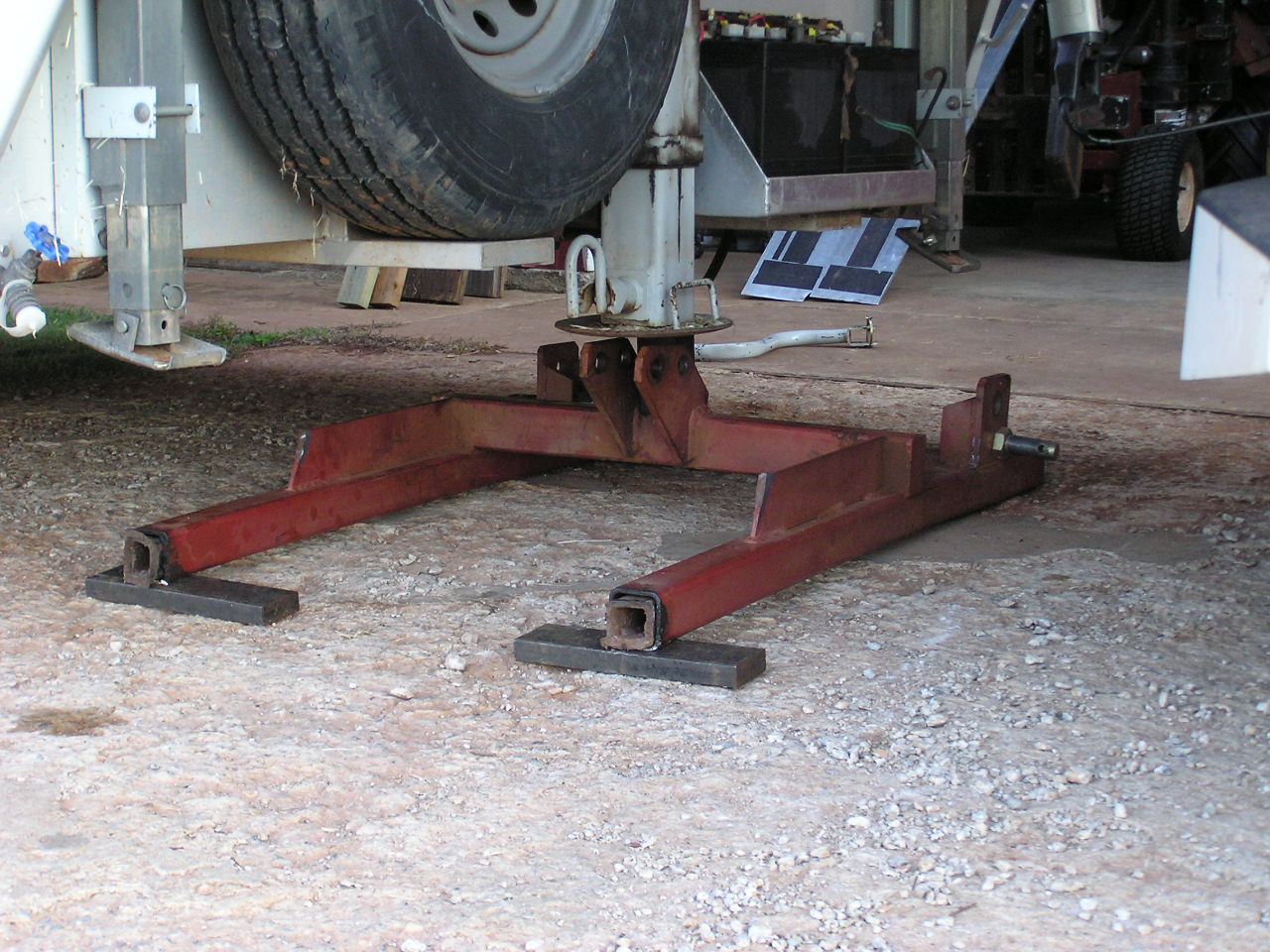

Nope, not too hard. I figure if it got bent cold, I can straighten it cold.
I do have a Victor O/A torch on a cart, but have not used it in years.
I straightened this bent fork for my neighbor, by putting it in the Gorilla Grapple with pieces of steel to get it where it needed to be, then used hydraulics to do the work.

BTW, about half your straightening "rigs", viewed in two dimensions, look like if a fly came and landed on one there would be a horrendous noise and flying chunks of steel!! :D
bumper
Yep. there have been times something would slip and I would have to re-rig it. Or maybe it was a fly! :laughing:
