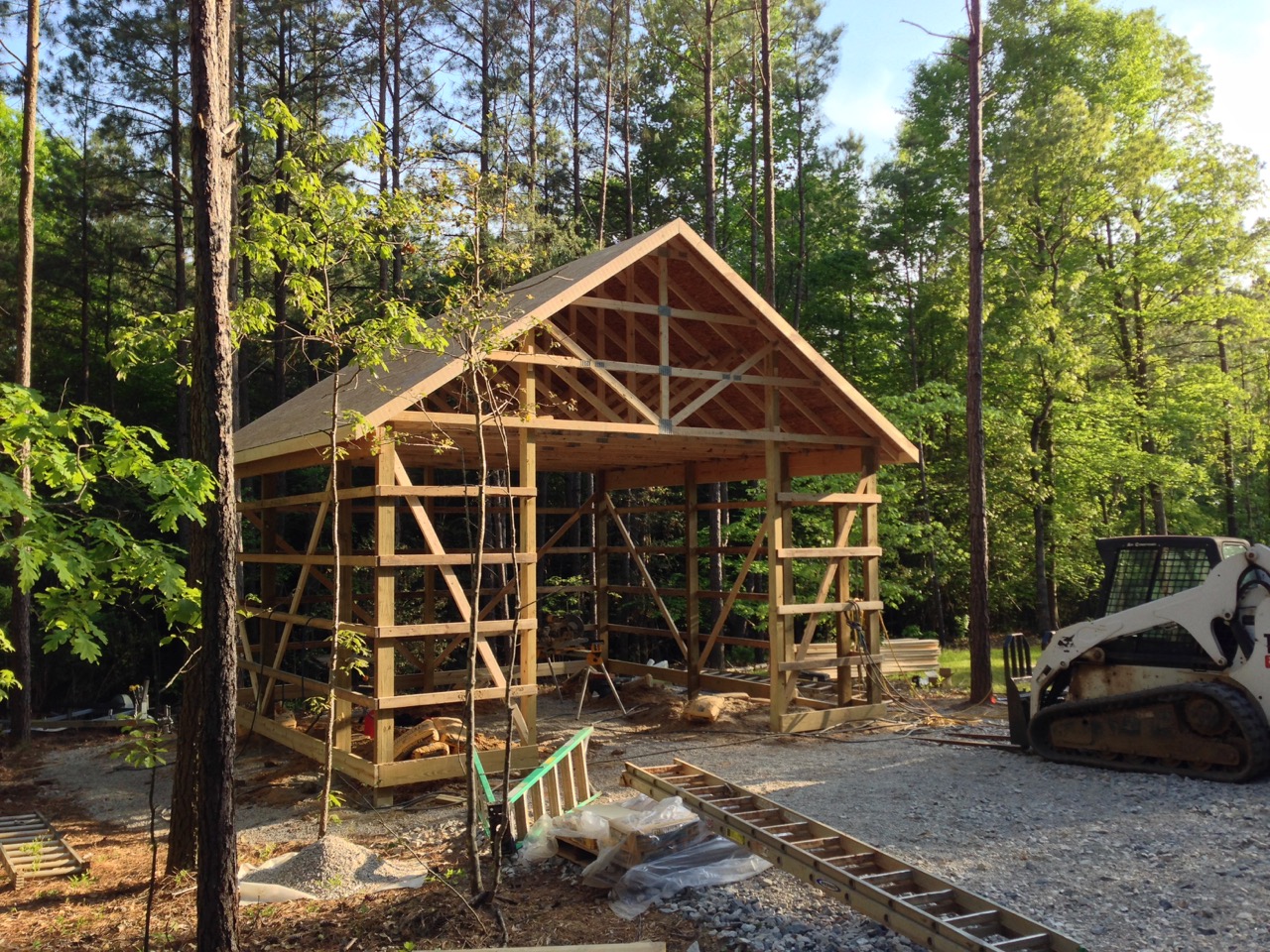

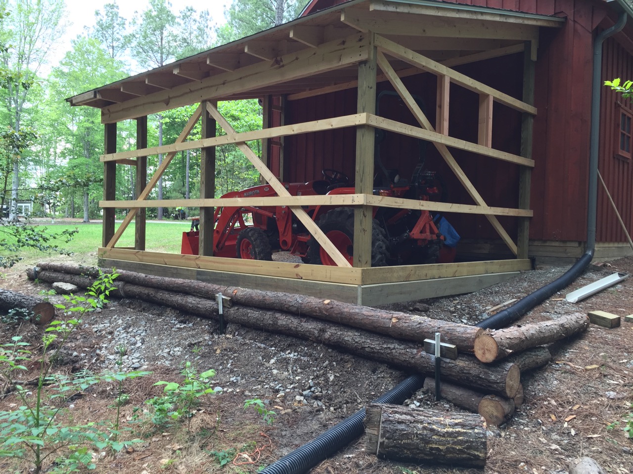

Headers are not needed on the gable walls, so you shouldn't even need to worry about it. Eave walls get headers and purlins, gable walls only get purlins.
I would notch in the header, but use a double 2x header and only notch in the first board. The second board will then sit proud of the post and be inline with the wall purlins.
I attached pictures of pole barn frames using both trusses and rafters.
