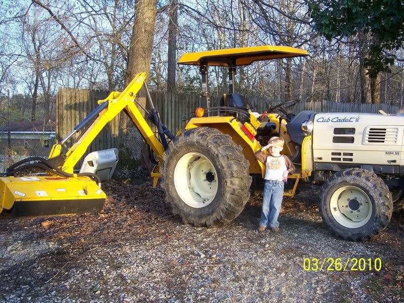

this is what i use to cut along the waters edge on ponds and levies.I use the standard bush hog to cut the backsides of the levy. Im sorry these darn things arnt cheep so it wont be what your looking for.
Used from a county shop would be much cheaper than new.
