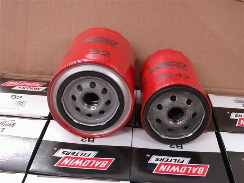

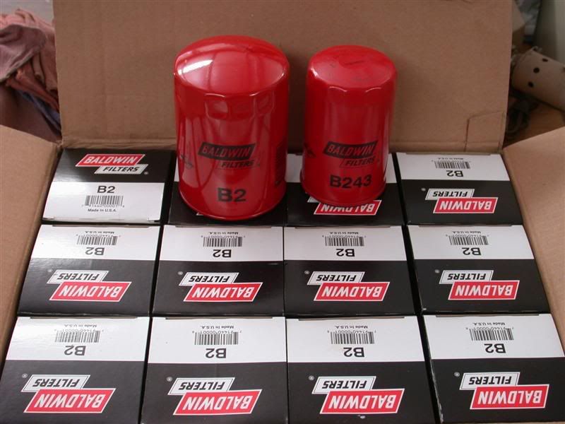

I had a conversion oil filter installed on my Kama that took a Baldwin B243 filter with 3/4-16 thread. I found a larger Baldwin filter (B2) about the same size as that B202 with the same 3/4-16 thread and bought a case for $3.51 each. The larger filters might be desirable, especially at those prices.
For comparison, I took these photos when I got the B2 filters to replace the B243 I was using on the Kama. I didn't take any of the B202's yet, but you can get an idea from these photos. The sealing gasket is the same size and the filtration material is the same ... just a much larger filter.
