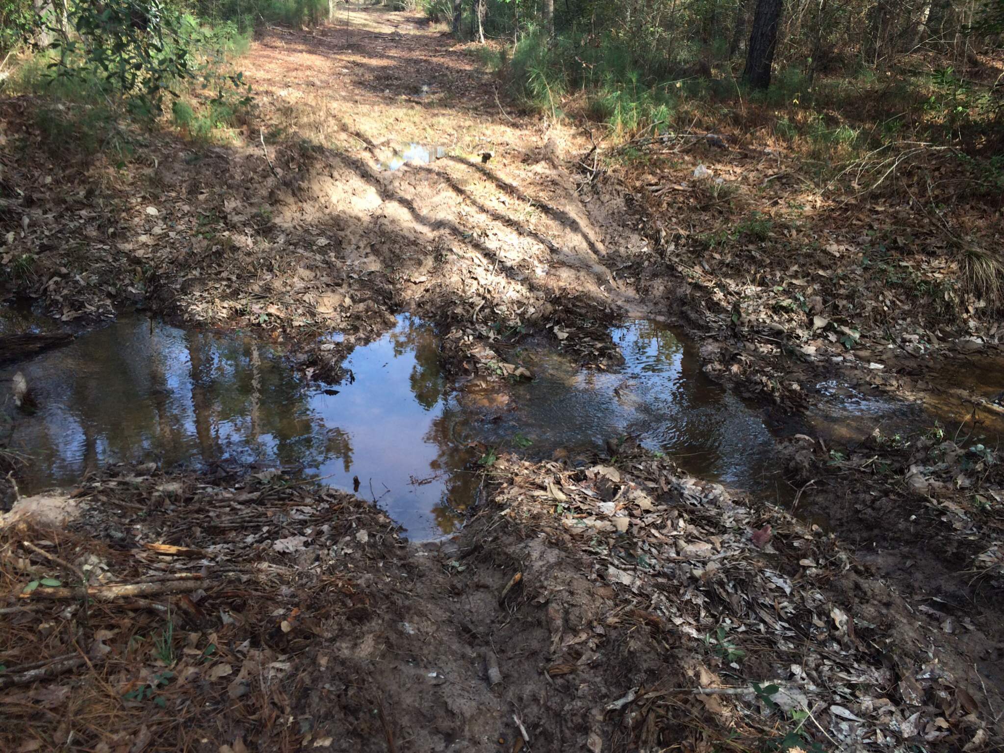

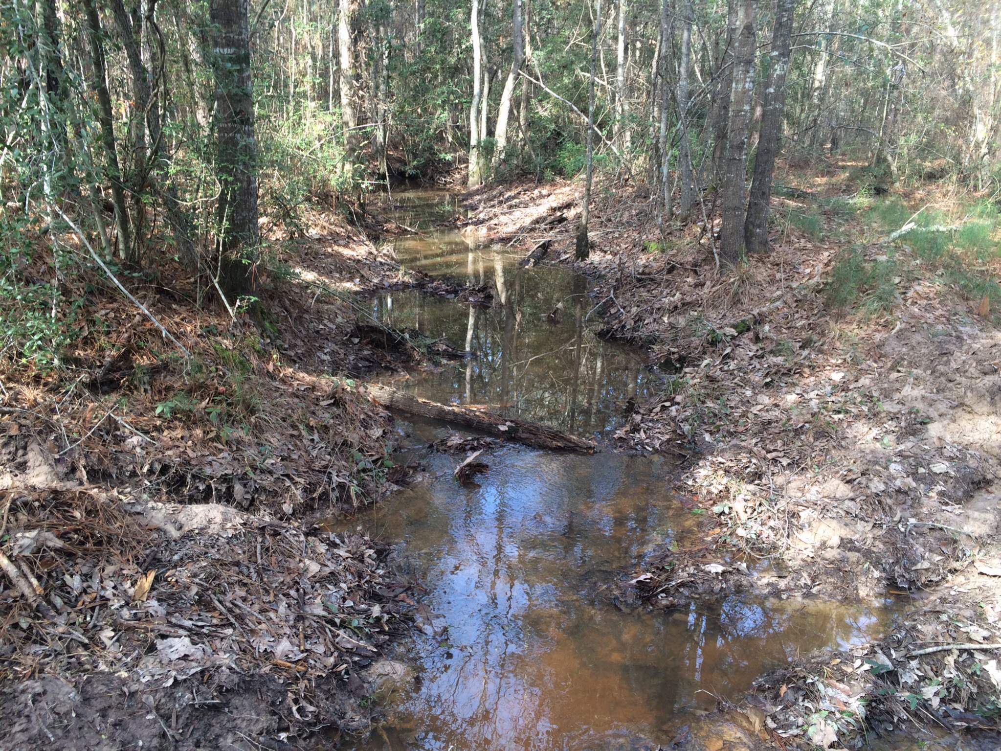

Need to put in our main road to our house and cross this creek. It is normally a dry creek and only flows during large rains. Creek is very flat so current does not look too fast. Bank to bank is about 10 ft and depth looks like about 2-3 feet. Any suggestion - culvert, pipe arch, box culvert? Also any idea on size?

Some question for you
Are there any culverts on same creek close by? Are they working without problems?
How many acres does this creek drain.
What is growing on drainage area? Trees have debris which must get through structure.
What is the highest amount of rain expected in the area
Any other access points if culvert washes out in high rain event

Not knowing the amount of water in a large rain, but from the pics the flow area appears to be about 3' w 12" deep
A single pipe arch might work 36" at the base but your cover height needed for heavy loads (cement truck) may be 20" or more. This may be too high making a ramp or needing a lot of fill before and after the stream.
Two 18-20" side by metal culverts with 12-16" compacted cover height would allow the grade to be lower.
Concrete box or similar would probably be best for heavy loads and need less cover - but best to check on the specs for cover on these.

When the creek is flowing the fastest- what is the depth and width? That is what you have to plan for in sizing your culvert to avoid wash outs. Corrugated culverts come in all sizes - even on craigs list. I have only opinion- but I would think that you would never want as much as a 1/3 of the culvert full during peak flow to avoid a washout.

About 30-40 acres of pine plantation. No culverts upstream. Will have to cross creek to get out, planning on putting second crossing in later. 90 % of the time the creek is dry. - I was told that someone actually hand dug the creek out years ago to drain a lake on their property.
We just bough the property last April so haven't been out there enough to see creek, although last weekend was the first time I have seen any water in it. That being said this will be our main road so want to do the crossing correctly. I was thinking about 4x3 box culvert with concrete wing walls, but not sure the cost -- don't want to go cheap but need to stay within reason.

I'd ditch the culvert :) plans and go with a concrete slab. Initial cost is higher, but there's less maintenance. Volume is not an issue either.

Since the approach(s) will also flood I don't think a bridge would have any advantage. I would go with several smaller culverts(18-20") side by side, then pour concrete over them. During a real flood they will just go under water and let the debris go over top of them. Of course during the flood you won't be able to drive in or out but as long as you are prepared for that it's not a big deal. Many driveways are done this way in my area and none have washed out.

Neither approach/road shows any sign of floddong - both are covered in pine straw

Back to the OP...I was wondering if a concrete-floored ford wouldn't work for that crossing. You could install when things are totally dry and the only potential problem would be during rainstorms (or snowmelt?) when the water might be too deep/swift to safely drive through.
