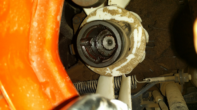

I removed the shaft but I can not figure out how to get the fan off. Any suggestions?

That would be nice but my fan bolts are inward against the transmission.
   / Help with BX25D Transmission Fan #4
If I am remembering correctly, the one I did had a bolt either through a notch on the transmission input shaft or a bolt tightening the collar to the shaft and it was not easy to get to with the floor pan off. Looks like you took the CV joint apart and the rest of it needs to come off.

Your right David there is a bolt holding it on. The cooling fins are in the way to remove it from the bottom. I have to take the floor pan off to access the bolt from the top.
   / Help with BX25D Transmission Fan #6
swatter, You're right. You gotta access the bolt from the top of the transmission housing. I'm fixin'ta hafta do the same thing. A reliable tractor mechanic I've met has, so far, steered me correctly on everything I've asked him about my BX2230. He said that you HAD to take the floor pan off of BX series tractors to replace that fan.
