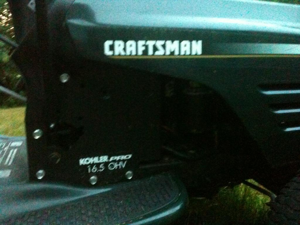

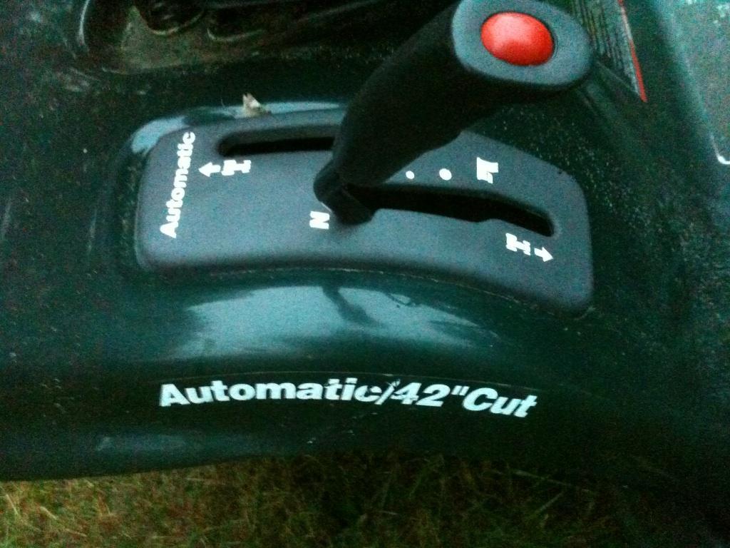

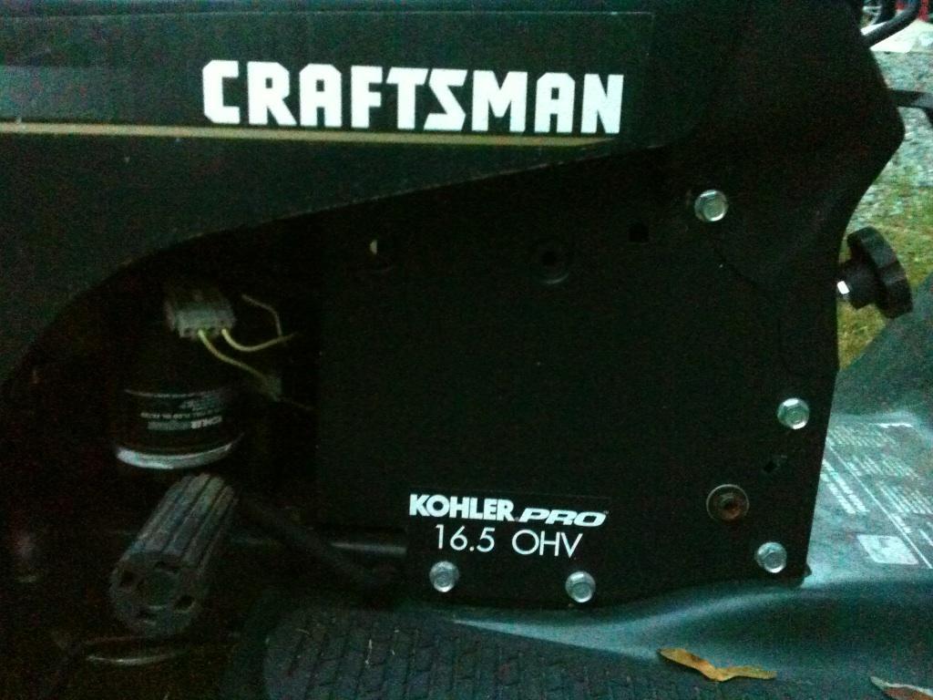

Hi all, friend of mine came to me with a broken axle on this unit wondering if I could weld it. A replacement part would be a much more viable option, but he couldn't find a parts source used or new. Can anyone point us in the right direction?

Should be able to order it directly from Sears based on the Serial Number of the machine.
Otherwise, there are dozens of AYP dealers online. I would be willing to bet, you will have to buy the entire transaxle assembly though....

Depending on where it broke, you could weld a sleeve over the break.
   / Help with broken Sears axle?
Yeah, that was my original thought and why he asked me about it. By the sounds of it, there is only 1/2" between the break and housing. It'd be tough.
   / Help with broken Sears axle? #7
You may be able to read the tag on the transmission to get the model number for the tranny, then look up parts for the tranny. Most likely it is a Hydrogear, and individual parts should be available through any hydrogear dealer, which would include Mtd, Poulan, Husqvarna dealers.
   / Help with broken Sears axle? #8
My local repair shop has what I call a lawnmower graveyard to pull parts from. Just an idea.
