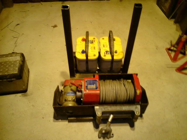

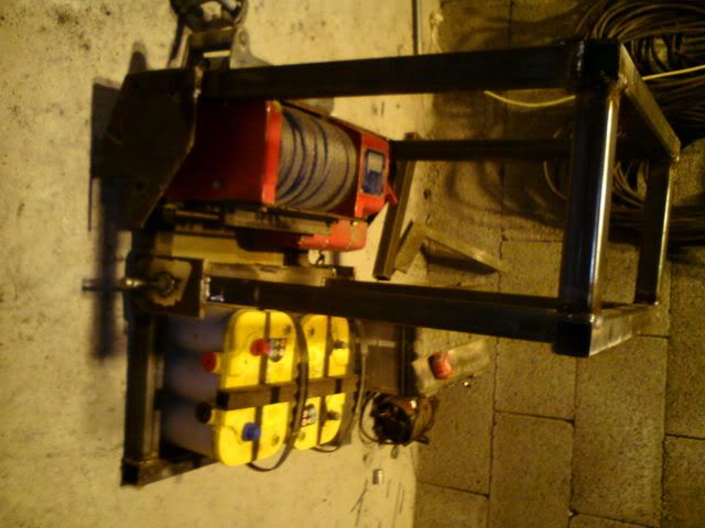

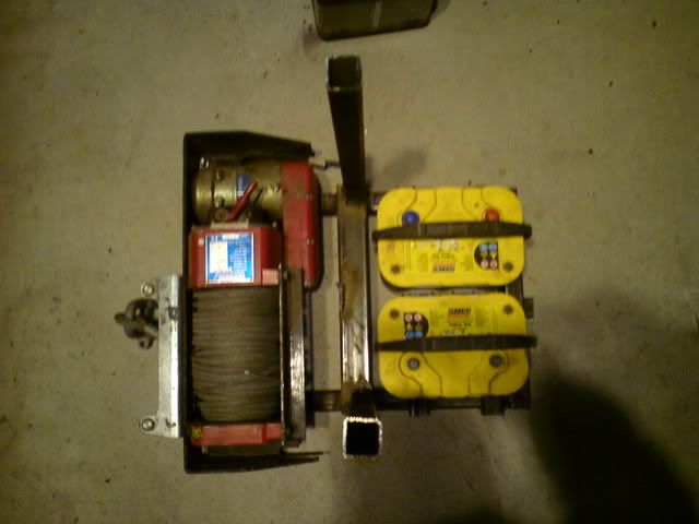

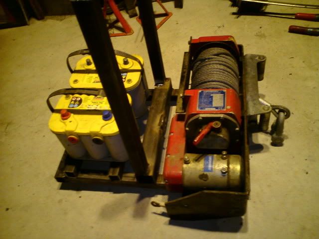

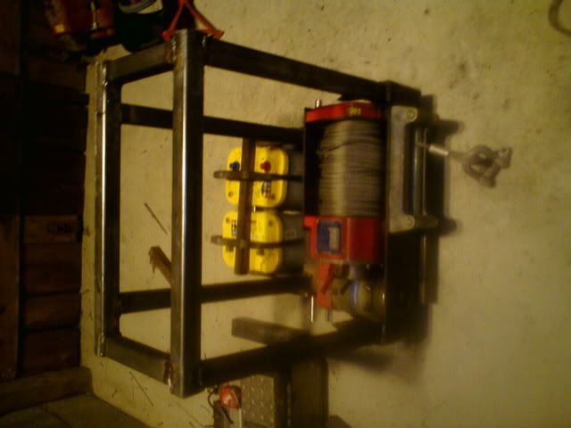

I started today with the winch platform. Still needs to be beefed up but the base layout looks good. Tray is fully welded to the platform, which needs some triangles for strength.
The 3pt takes between the batteries and the winch, if things work out as i see it now the whole thing will not stick out more than a counterweight barrel and have the same weight, so i might have eliminated the need for a "useless" block of concrete.
Winchtray is 60cm wide and the frame / 3pt attach width is 45cm. main beam 60x60x3mm other profiles 40x40x3mm
PTO should run in straight line to the middle frame, so in the middle with the generator and alternator both mounted off center above the batteries (to respect the rotation direction of both and not have a complex PTO to pulley set up) The compressor can run above the winch where i will also put the pressure barrel.
Toplink attaches to top of middle frame in line with the PTO shaft.
(batteries will stand on a plate attached to the bottom of the frame. For the picture i had to put them on 2 pieces of profile above the frame or the winch pivots the whole construction.

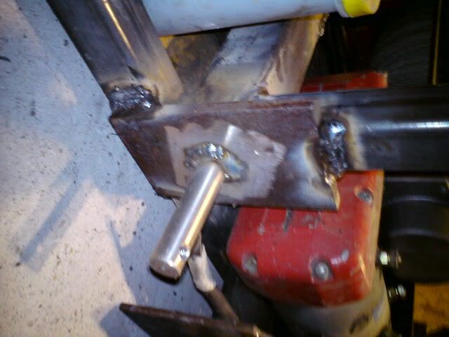

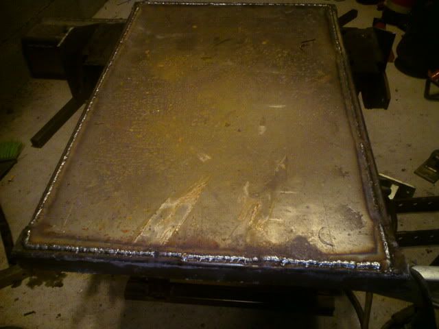

Small progress,
Bottom plate welded, after more than 2 years i fired up my MIG and for this plate work they really are THE tool, almost forgot.
Now, the frame is also more or less in final shape and should give a tight fit for the gen and pulley work involved, hope it works out.
The 3pt pins welded on a reinforcement plate of 10mm. Also the top hitch swivel point was mounted and the battery tray got battery tie-down.
I am now trying to dismantle the generator from the crashed engine it is attached to but that will be a matter of patience or brute force with a portion of luck. Looks as the main generator shaft is fused to the cranckshaft of the engine with no way to reach it without damaging the rotor. All what was assembled should be able to be disassembled so we keep trying.
