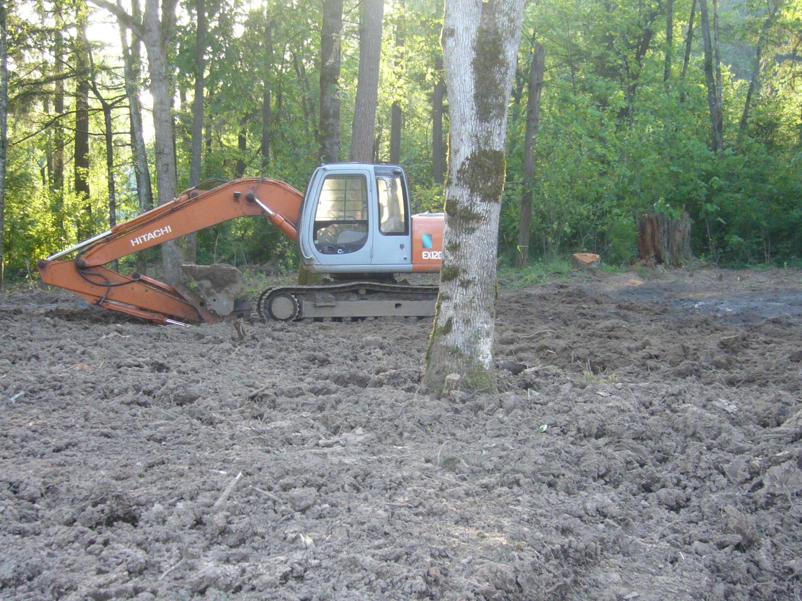

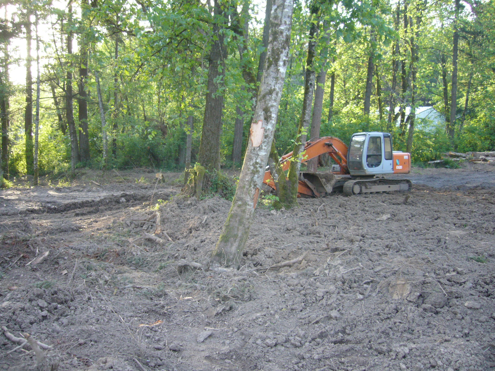

Hello All
I justfinished my house and shop install and this is what I have left. 2 Acres of this. I am ready to buy a tractor and am either getting a new mahindra 2015 or used Kubota B6200 I just do not know where to start. The ground is dry and dirt clods. The land was solid brush and large fir trees. The trees where pushed over so MOST the roots are gone. Still alot of debris in the dirt. Do I just start tilling? box blade with teeth?
Please ask me any questions as I do not want to buy a bunch of extra implaments and do it twice
Thank you

/ HELP!!! Where do I start? #2
What do you want the end result to be?
If it is mostly cleared and rough soil as pictured, and you just want it smoother, you might be able to get away with dragging a chain harrow over it. This would break up the dirt clods and smooth the ground a bit. The tines on the harrow(depending on how you drag it) would also catch a bunch of the loose debris and allow you to drag it into piles for collection.

/ HELP!!! Where do I start? #4
Maybe hire small dozer for leveling etc.(save a lot of time and wear and tear on tractor also attachment) than rake or box blade for the finishing touches.

it is mostly cleared and just a bunch of clods and sticks. no stumps. i want 1/3 nice lawn and 2/3 fiels grass. the land was fir and shrub brush. should i lime it before i start?
/ HELP!!! Where do I start? #7
Do a soil pH test to see if it needs lime or fertilizer. Most areas have a county agriculture extension service where you can get soil samples analyzed for $5-10 each.
If you aren't in a hurry to have a nice yard, you might be able to disk it and drag it with a harrow (as mentioned above) just to smooth it out and then gather up the roots as they rot or dry and get brittle.
/ HELP!!! Where do I start? #8
I'd hire someone with a BIG tractor and a BIG, HEAVY disk to disk it for you... a heavy enough disk will cut roots into arms-length chunks of wood....
Then, you can use a smaller CUT/SCUT with a landscape rake to rake the roots up, and its FEL to pick the piles up and dispose of them. You can finish the smoothing with a home-made drag harrow made from a piece of chain-link fence, old box-springs, etc.
/ HELP!!! Where do I start? #10
I'd start with soil sample to determine what amendments you need to add. (lime, horse manure if available locally and cheap or free, whatever)
till in the amendments - even if it means hiring someone to do it, then rake or harrow with your new tractor -- orange or red, both are good machines. (I'd lean towards new, but that's because I prefer to fix my own mistakes, not someone else's - but budget can define that, as well) I'd also consider buying the rake and building the harrow so you can have both on a budget.
don't know where you are or what kind of pasture you're going to want, but I seeded both my yard and the bald parts of the pasture around my construction site with perennial ryegrass. Doesn't make bad lawn and has nutritional value for critters. TSC also sells a pasture mix that has timothy, ryegrass, clover, etc... for a reasonable price.
/ HELP!!! Where do I start? #11
I would start by walking around and picking up some of the larger sticks and cut off roots. They can get stuck in bad places. As far as leveling it out. That ground looks prettysoft. I would try and use a box blade and maybe a rake. Set the blade and just start driving around. The tractor tires will break up some of those clumps the rest will break up as you blade them. I good heavy rain also helps.
/ HELP!!! Where do I start? #12
Lots of good answers so far but I like tilling with a HEAVY tiller.
/ HELP!!! Where do I start? #13
Hire someone who has, or rent one yourself, a harley rake. What it is is a reel, about 4 " in diameter, with teeth about as big as your thumb, made out of tungsten carbide. When this reel rotates, it knocks debris forward or backward, depending on the direction you are travelling. I use one on my Asv Rc30, the smooth finish grade it leaves is unbelievable. What doesn't get buried can be pushed to the edges, for removal, or just shoved into the wood edges. These rakes are available as 3 point hitch models or for skidloader attachment. Well worth the rental fee, my 4' model could do your whole project in about a day, if your pictures are true representations.:cool: :cool:
