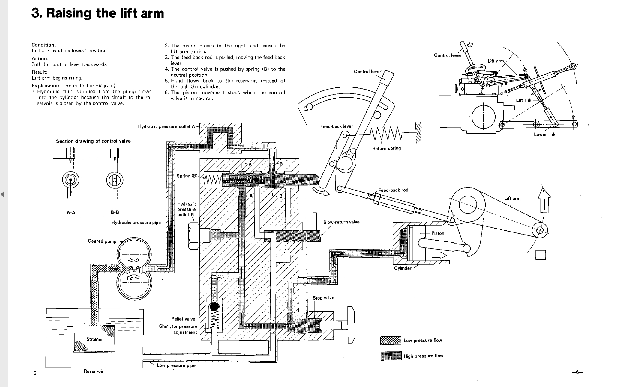

The flow control knob when it is operating correctly only controls the speed of the drop of the 3pt arms. It is for drop rate only. Your 3pt cylinder sounds like it is losing fluid and then refilling. That could be due to the drop rate knob being bypassed internally because some of the O rings on the drop rate shaft are missing.
It could also be due to the main 3pt lifting valve stop being missing or misadjusted. More about that below.
If I turn the tractor off and leave the flow control knob all the way closed, my blade stays up now without creeping down, so the new seal fixed that problem.
The new seal - I assume you mean the piston seal - sounds like it fixed the problem of fluid bypassing the piston-to-cylinder walls. But that new seal doesn't do anything for the other leakage path past the drop rate knob O rings.
But, if I turn the tractor off and then open up the flow control knob, the blade drops to the ground. I tried posting some videos but they're not allowed. Which valves are you thinking of: the flow control valve assembly or the 3 pt lever control valve assembly? I attached assembly views of both valve assemblies.
Maybe both. The drop rate knob is easy to remove and service. Basically a long needle valve with some O rings on it. The only reason I suggest that drop rate knob at all is because it could cause that problem and it is easy to R&R. Always do the easy things first.
If yours has an internal cleanable crud filter screen in the hydraulic sump make sure that is clean. Often overlooked & could also cause the problems you have. I think the older Fords have that screen.
Frankly, yours sounds to me more like the 3pt lever control assembly is out of adjustment. Or a relief valve is stuck open....can you hear anything? The control \could even be missing one of the springs or nuts that adjust spring preload on the main lever control assembly. That happens so rarely that most mechanics - including myself - rarely adjust one. I'd probably start by comparing all the external springs and nuts with a known good one.
Here is a general overview of how any 3pt hitch operates:

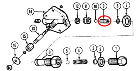

Everyone, thanks for you suggestions. I found the culprit. It was this little spring (circled in red) that pushes against the steel ball inside the flow control valve. It looks like someone took it apart in the past and when they put it back together they must have crushed the spring with the valve body (#6 below) because it was all deformed/mangled. Works fine now.
