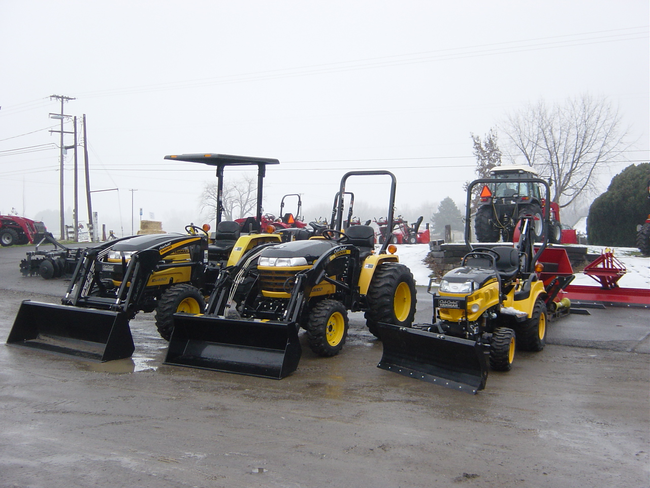

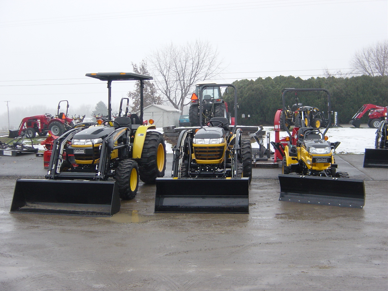

In our end of the world it goes, Sub compact, Compact and Utility. I attached a pic showing all three for frame size reference. Utility typically has a shorter wheelbase than an Ag tractor of the same horsepower (John Deere 4000 series is Utility and 5D/5E series is Ag or Mahindra 35 series utility vs. the 30 series Ag) because it was designed to turn tighter and be less intimidating to operate. Ag has a longer wheel base for doing a better job using tillage and hay equipment where the shorter the tractor the bumpier the ride. Everybody uses different terminology so it is key to sit on the different models.
The other part I left out which is the most important is to sit on everything. Tractors are not cars and each one is going to fit differently. Some will be awkward and some will fit like a glove. The right and wrong tractor cost exactly the same :)
Buck
