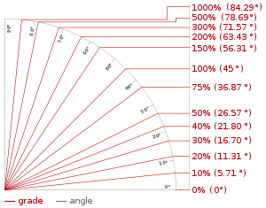

I suggest everybody reviews this chart before they get on their high horses.
Ovrszd, I guess I should clarify my earlier post. I was mowing up and down the slopes and not across. They are far to steep to try and mow across but I don't have any problems in 4wd going up and down other Than trying to stay in the seat!
   / Help sizing rotary cutter for my tractor and terrain #23
LD1 already ready tried to set them straight on degrees vs percent :confused3: :mur:

Yep. Good chart. Sure makes 20-30 degrees look like nothing though. But having mowed some 25 degree slopes, when on the tractor it feels alot steeper. Park the tractor and step back and look and it dont look nearly as bad. A 4/12 pitch metal roof is a mear 33% ~18 degree grade. But it sure feels alot closer to 45 degrees when walking on it.

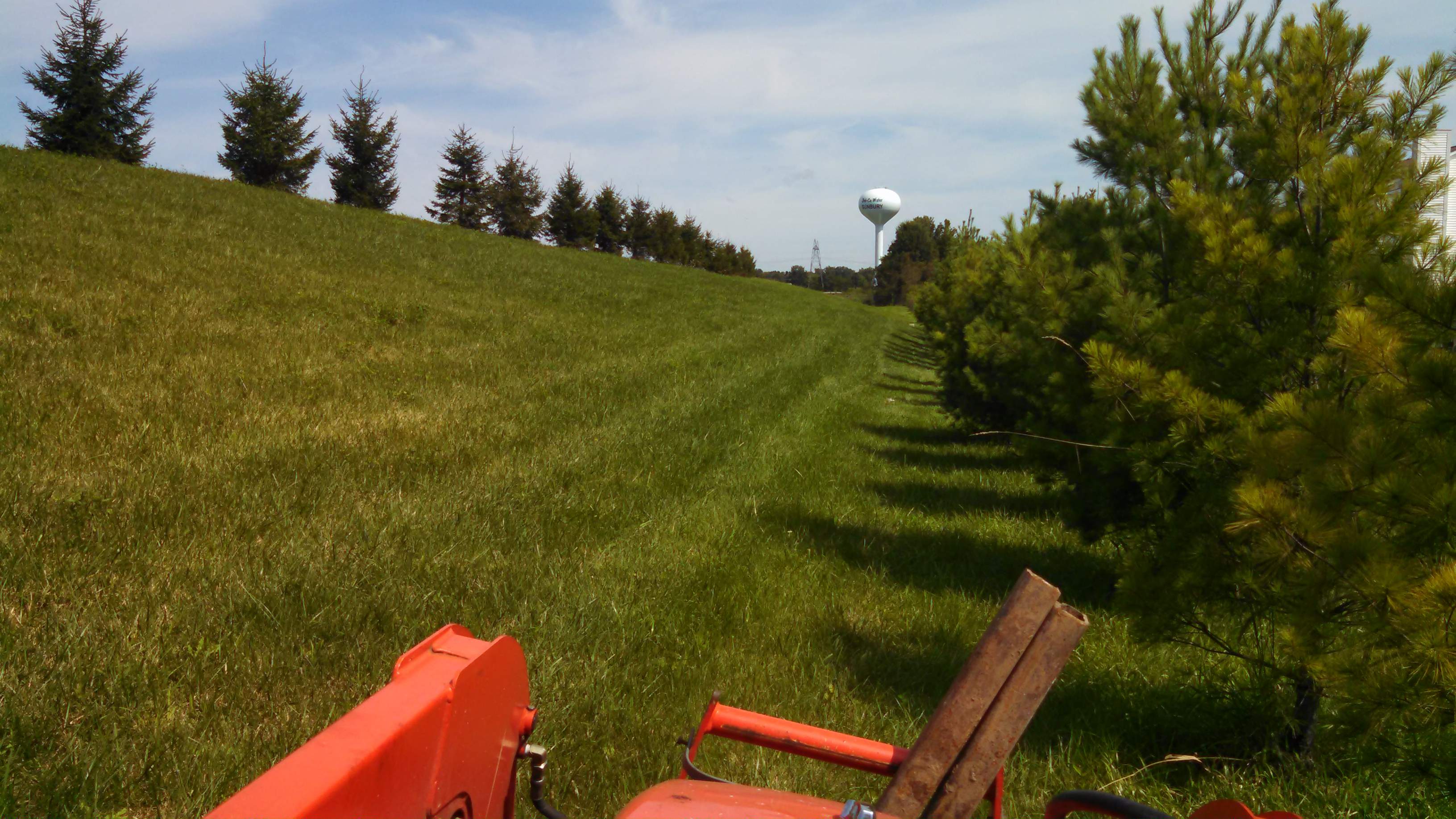

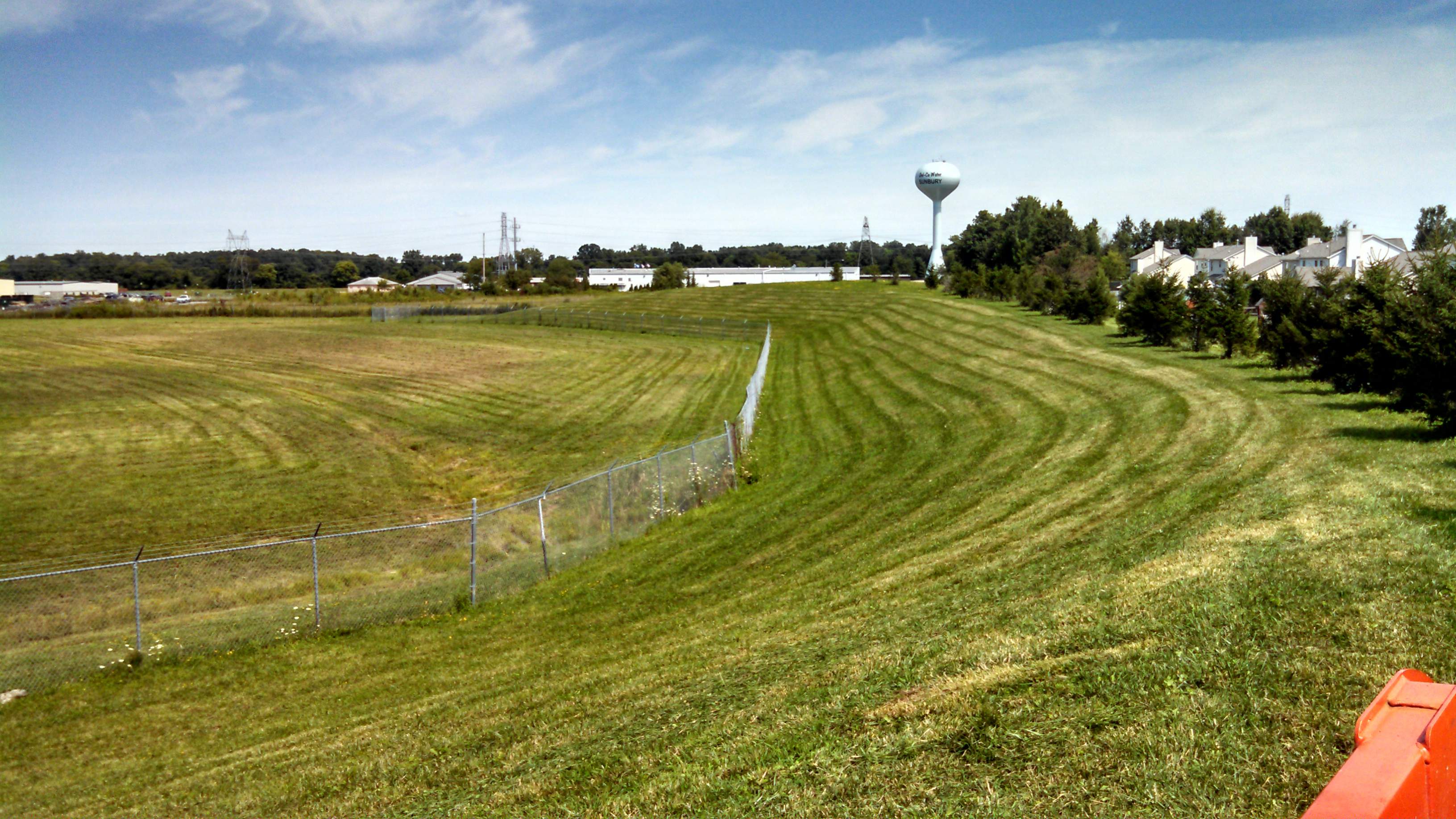

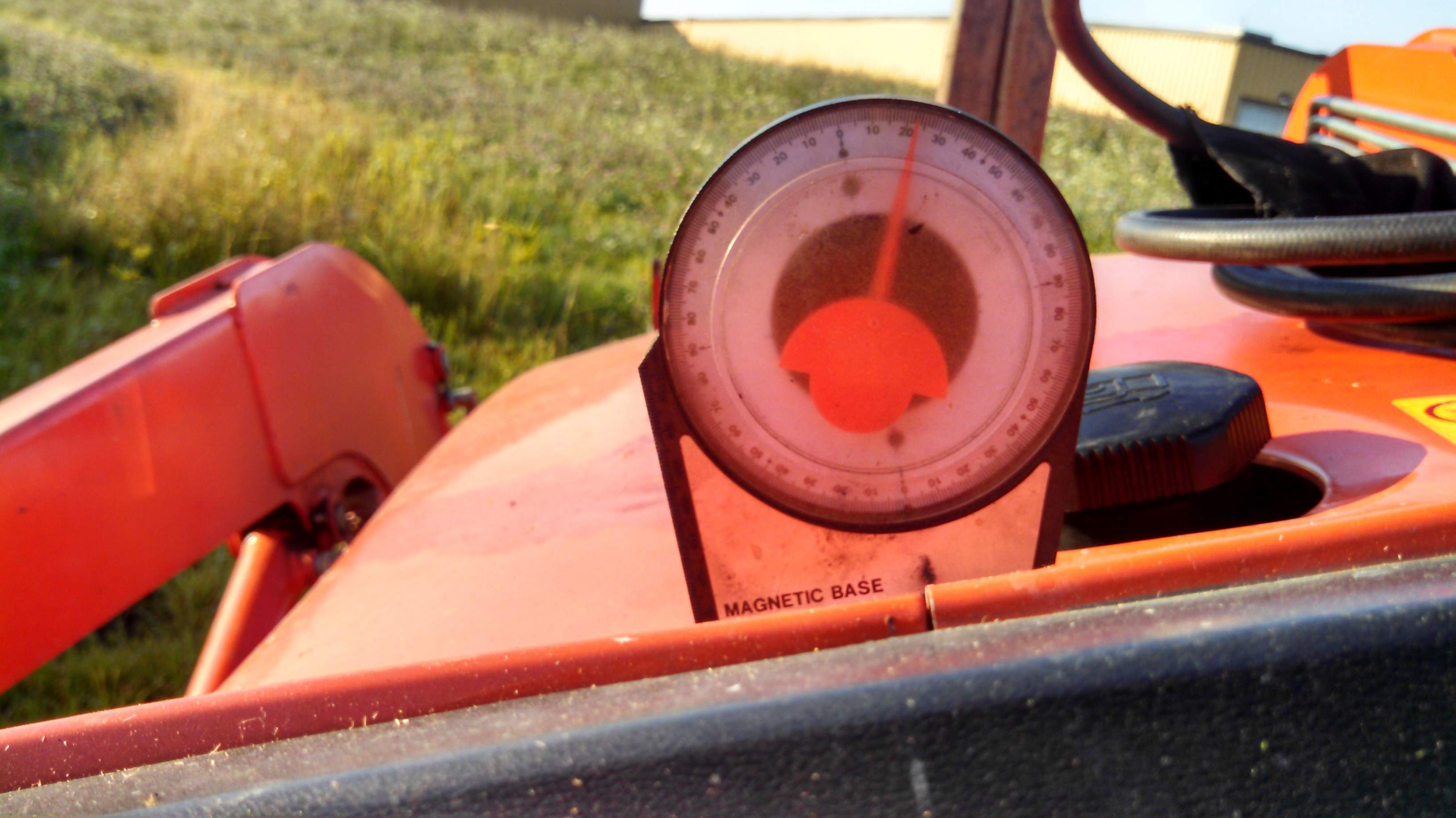

The steepest parts of this hit 25-26 degrees. So near that 50% mark. Average was in the 20-22 degree range (36%-40%). While it can be a bit dicey when wet, when it is dry the 36%-40% is no concern. Only a few of the areas that peak 25-26 degrees do I feel a bit of pucker.
IMG_20140815_074408_988.jpgIMG_20140815_112236_314.jpgIMG_20140815_113717_911.jpgIMG_20140815_121136_248.jpg
