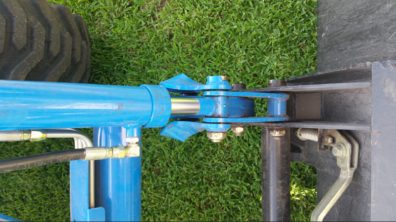

This owner said he was only pressing against a cedar stump.
Wow! I got to admit that's pretty impressive! That guy must have went full speed into a light pole or something. Maybe they need to start making these tractors with airbags...
