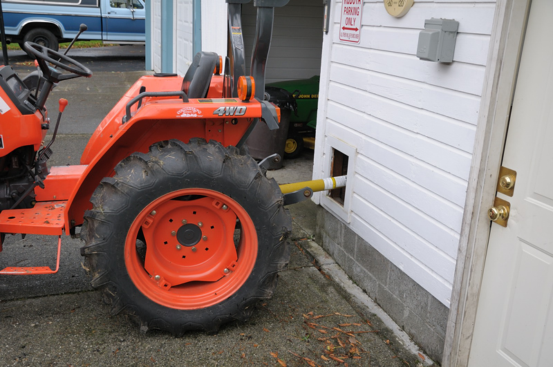

I agree w posters who rec a quick hitch. You don't want to be wondering what an un-attended machine is doing. Is your heavy, wide, weighted, vibrating genset creeping slowly away from the tractor, etc?
Besides, w a quick hitch extending the arms ~3" you might not need to cut the driveshaft. If you do, it's a 15-20 min job. Play it safe since you won't be watching the action.

FWIW, Kubota may offer a "kit" for extendable links for your 2670- I know they did/do for the L3400. I too would be concerned about an unsecured gen set moving around, or worse, so using the 3-point seems safer, at least until you have some experience to go with. Having something go wrong while you aren't there could be a real catastrophe! And, PTO's seem to get easier to install and remove with some practice. And Fluid Film.
/ Help setting up tractor for multiple attachements #50
Just a thought. Is there anywhere you could set the generator up and leave it connected to the house and just build a little roof or dog house type deal over it. Then you could bolt it down to a couple railroad ties going cross wise or something similar and when you need it you just back up and hook up the PTO.

BKBoiss. No unfortunately not. I'm going to pull it of the garage and hook it up to the electrical outlet which is next to the garage (if that makes sense) It will run outside the garage... but stay inside
I called Kubota.. they will do my PTO shaft for $10.00. I can't go wrong with that. I like window shopping there anyhow.. so its a win win.

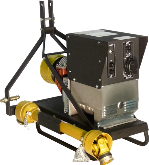

The one I purchase was the IMD 16 KW with AVR, 3 point hitch assembly and PTO shaft.. All out the door was $1852.02 USD.
IMD 16KW PTO Generator
This is what it looks like. Same setup
It already has a platform.. I just want to make it mobile. So that is why I'm adding the dollies.
