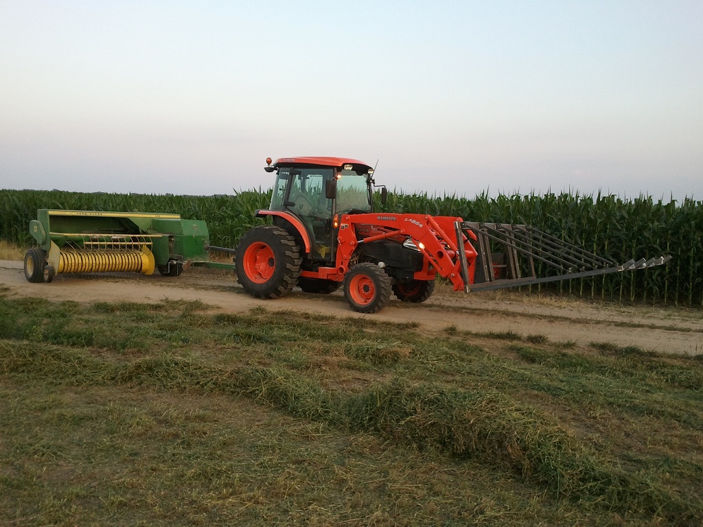

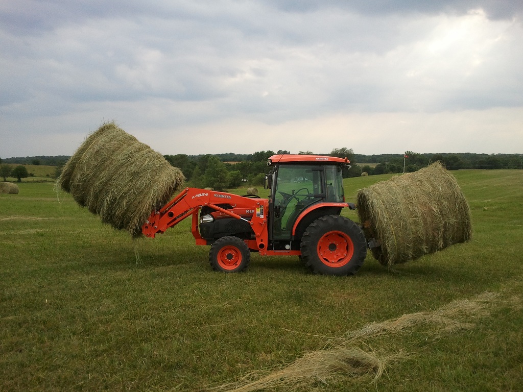

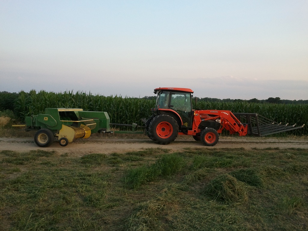

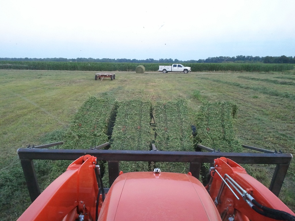

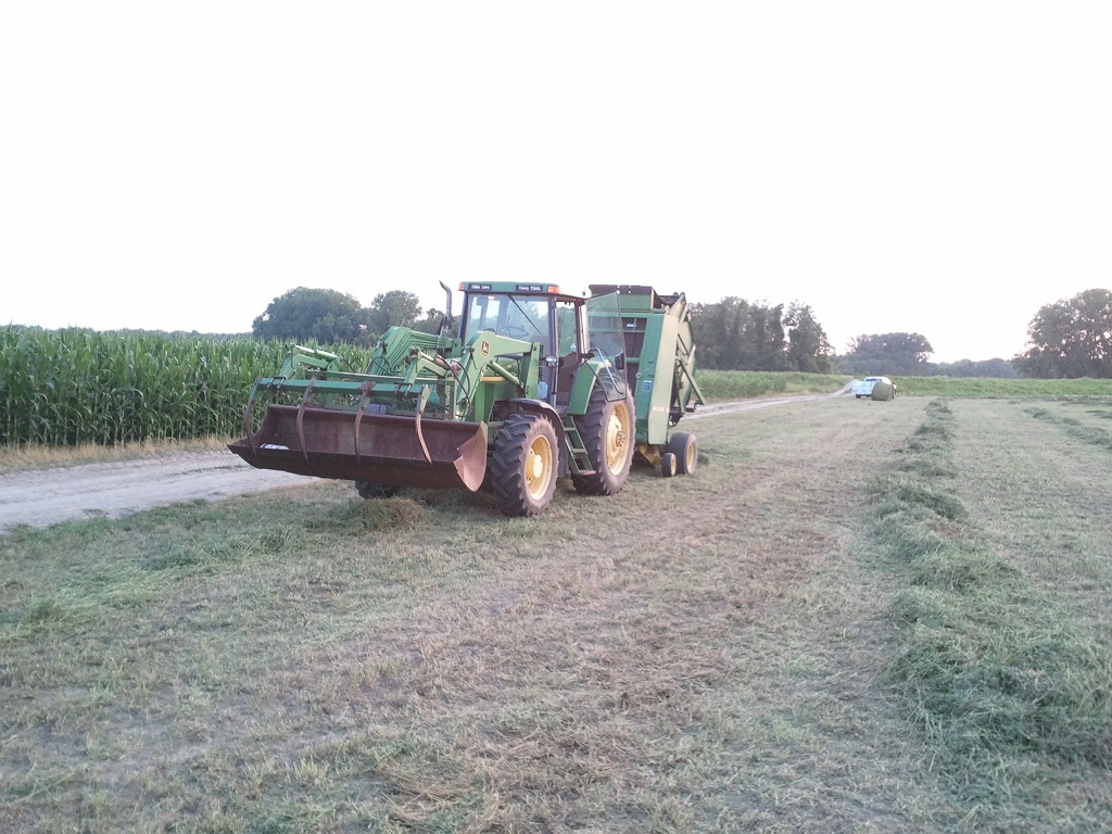

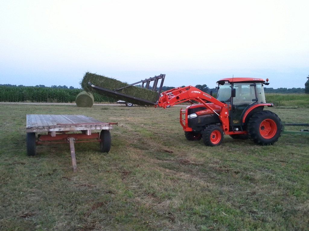

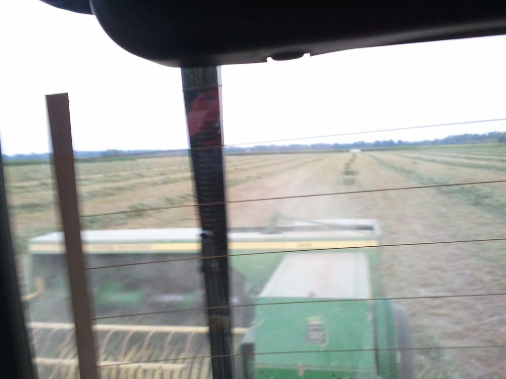

I have a L5740-3 Grand with the hydro tranny. (Which I believe to be the only tranny option on a Grand L, I could be mistaken.) FEL and my rear tires are loaded with RimGuard, adding 1300lbs ballast. Anyway, I have baled over 2500 square bales with it this year. Picked roughly 1/4 of them up with a bale sweep on the loader. (The rest the customers pick out of the field.) I've also loaded hundreds of round bales out on a bale hauler. I guess you could say I've got a little first hand knowledge of haying with the largest L.
With that said, I would not recommend going with anything thing smaller than the L5740. Even though a square baler doesn't need more than 35 hp to run, it takes a lot more power to get it down the road to the field. Especially if there are any hills to pull. Mine drops to 7-8mph on some hills here. I LOVE the Hydrostatic Plus tranny! You have way more control with the pedal than any manual tranny. It's super smooth. Makes baling nonuniform windrows a breeze. I also hay with a JD 6300 and JD 7410. Using them for raking and round baling respectively, there is a ton of clutch use for slowing down when necessary, making turns etc. I wish they made Hydros in bigger tractors. So you might go drive a HST Plus before you rule it out.
Lastly, if I haying was the main or only use for my tractor, I would step up to an M. More room, comfort, power etc. Unfortunately, snow removal is the main intended purpose for my L5740 and I have to be able to trailer it, loading and unloading 10-15 times a snow, and get into tight places. I specialize in getting the snow out of the tight spots out in the open where the big iron can get to it.
I love my L5740, but I will give you an honest, experienced evaluation on it if you have any questions. :thumbsup:

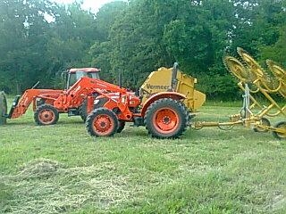

I'll have to take my 2 M's back then(M7040,M5040)haying2.JPG.... Guess it doesnt have the right gear range to pull a 15ft batwing efficiently either(M5040)mwing bottum 3.JPG or run an 8ft cutter(M5040)cutter up all the way.JPGor run the correct speed to spray(M5040)5040&sprayer top view.JPG or the baler(NH 315)squarebaler when picked up and all clean.JPG

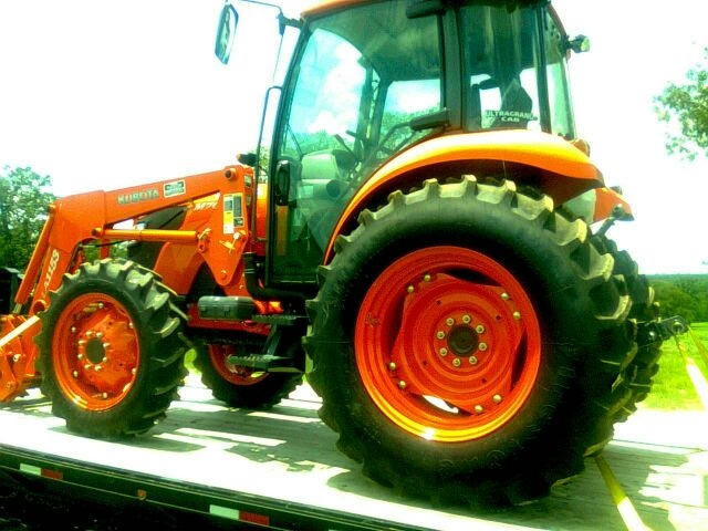

Well I traded the M5040 in today and desided to get another M for Hay tractornew 7040.JPG.
They had a L5740 there that sure was a nice tractor....
/ Help selecting an L-series for haying #18
Well I traded the M5040 in today and desided to get another M for Hay tractorView attachment 273392.
Boy that's a good lookin ride you go there. Glad to see you grabbed a cab. Besides the obvious dust and dirt, the hornets have been horrible this year in one of our alfalfa patches. It also enjoyable to hay, when your in the a/c listening to tunes. :thumbsup:
The L5740 is a great tractor! Still kinda want an M. Especially for cab room... Power... better ride... air seat... um yeah sorry. Started to wander there.
