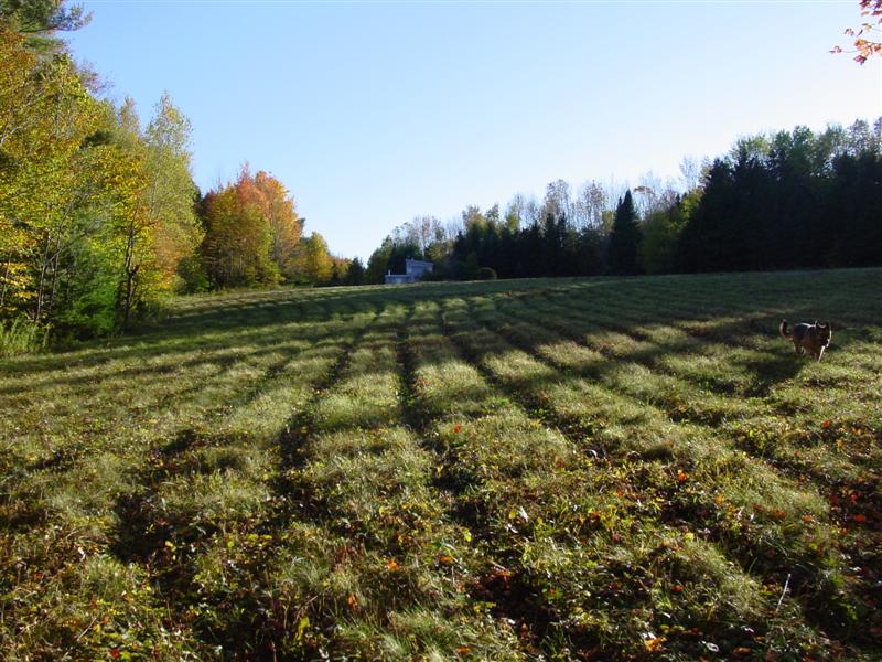

In your third picture it looks like you can see the high spots left over from prior bush hog. Usually the tires compress the grass, the hog does not cut as well there, then the grass stands/grows back up higher there.

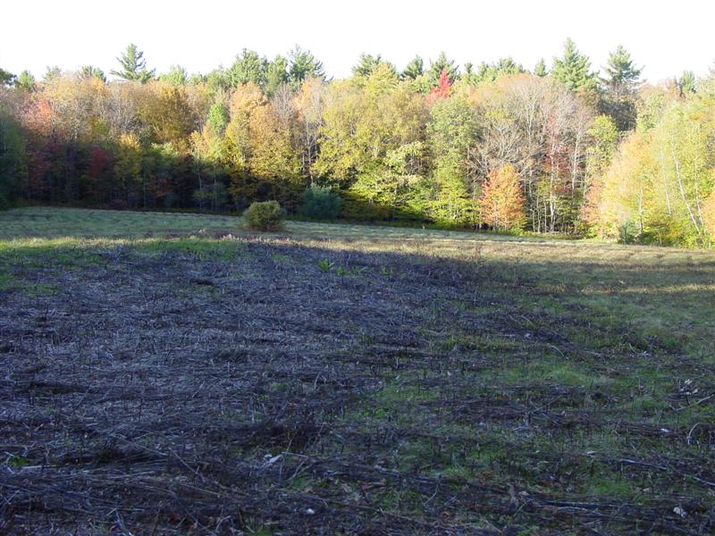

G-force said:
Let me first start off by saying, I have never bought or owned a tractor. I am as green as it gets on the subject.
I have been reading around, and I have searched, but I figured I could start a new thread with some pictures of my specific needs.
We live on 5 acres. I would estimate at least 2-3 acres being sloping fields of brush that gets as tall as 4-5 ft in the spring and summer time. I will probably be clearing these fields 2-3 times a year as well as doing other small tasks around the property. Nothing major.
My concern is that the incline of some of our fields is so steep that a tractor will not be stable or safe traveling on some of the more extreme sloped areas.
Here are a few pictures of my land for reference. I took them today. Believe me when I tell you it is alot steeper than it looks. When it is wet, it is very hard to walk down without slipping. My ATV can even be a little scary going up it. I am an experienced ATV rider, and I would never ride sideways on some of the slopes.
I have been looking at the JD 2320 and 3X20 tractors with HST. Specifically the 2320 with 200x front loader and tow behind rotary cutter. I have found a local deal on this machine with only 35 hours and am really considering pulling the trigger on it. Do you think this machine could handle my tasks?
I appreciate any feedback I can get.
Those slopes look to be 15 to 20 degree. 20 is about the limit I would run sidehill on a loader tractor. Without loader you can go up to about 28 with care. I cant imagine you having any problem with an atv on those slopes unless you insist on speed.
