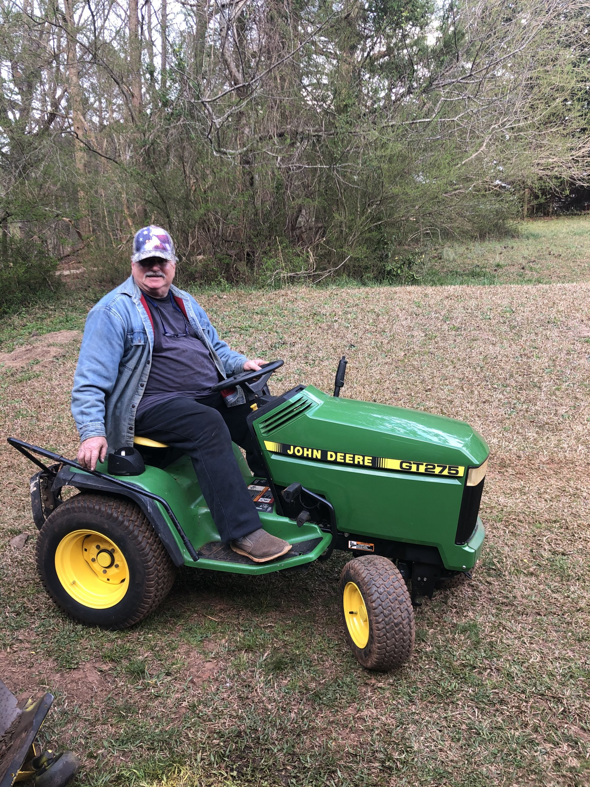

Here’s my ‘97 model yesterday. 6 acres since new, 3 of the 6 are pasture. Just replaced lower shaft seal and rebuilt the deck and sniffed a lot of yellow paint.
