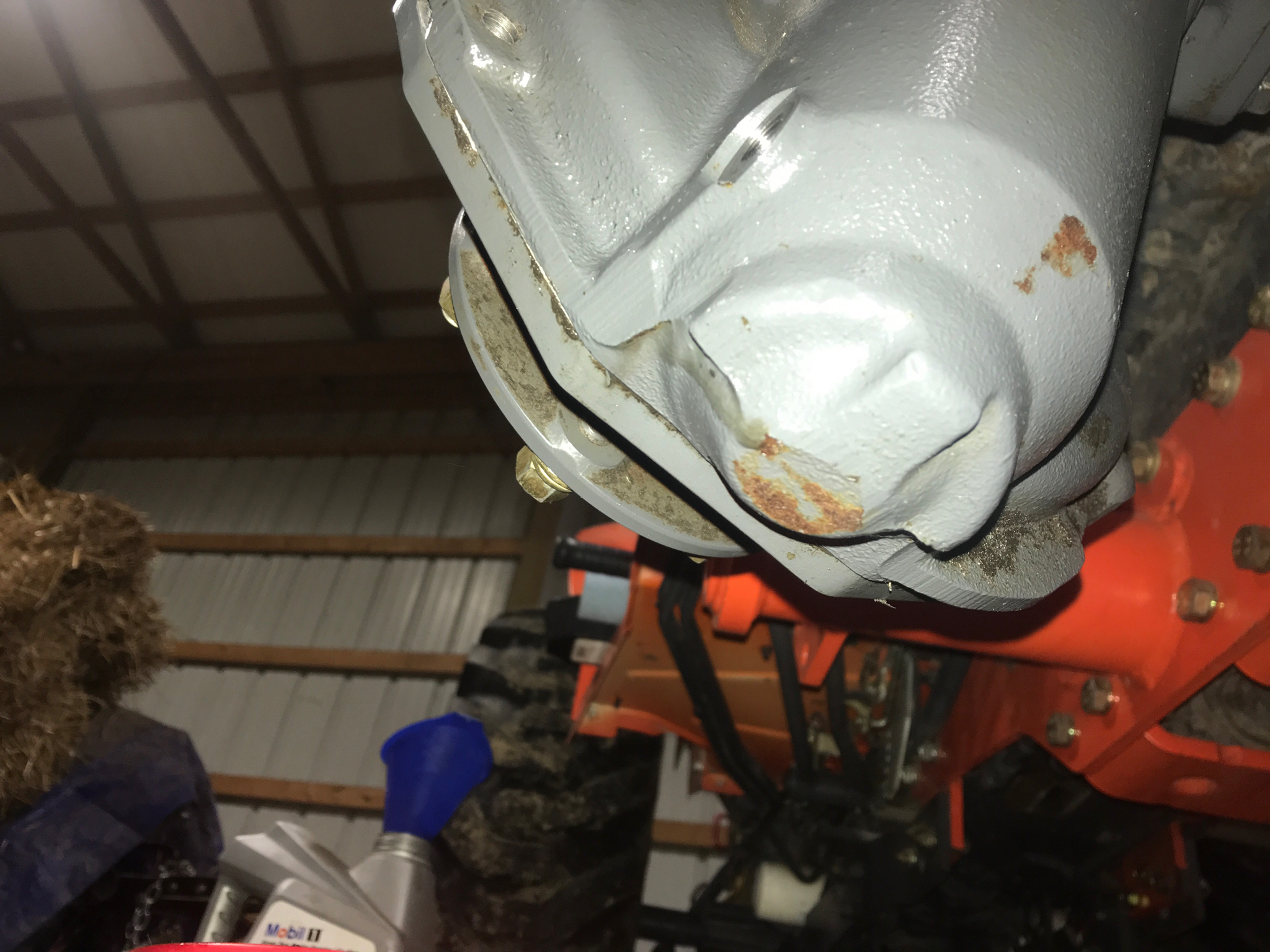

Help removing front gear case
/ Help removing front gear case
#21
"Don't force it, get a bigger hammer"
That’s what it took, lots of blows with this.
#22

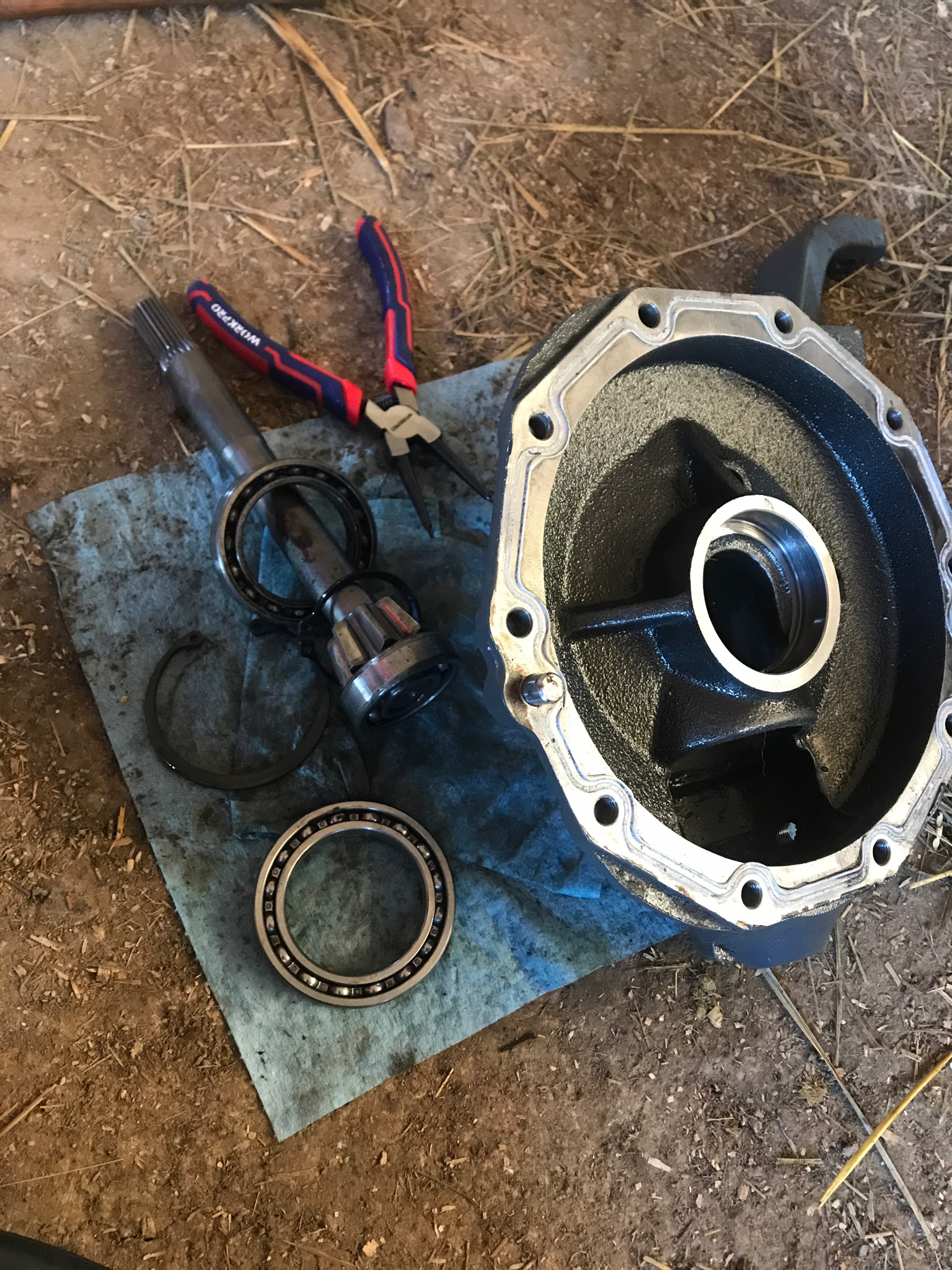

Got the axle case all tore down, time to clean everything up. No metal chunks, everything turns smooth with no slop.
/ Help removing front gear case #24
That's always a good sign. So, for future reference, it took just removing the bottom snap ring and a hammer to remove?
Proper choice of hammer... a shot-filled dead blow hammer like the one he used gives proper force without marring the surface. (y)
/ Help removing front gear case #25
#27
That is correct, probably had to strike it 100 times with that 4# shot hammer, and it came off very gradually.
