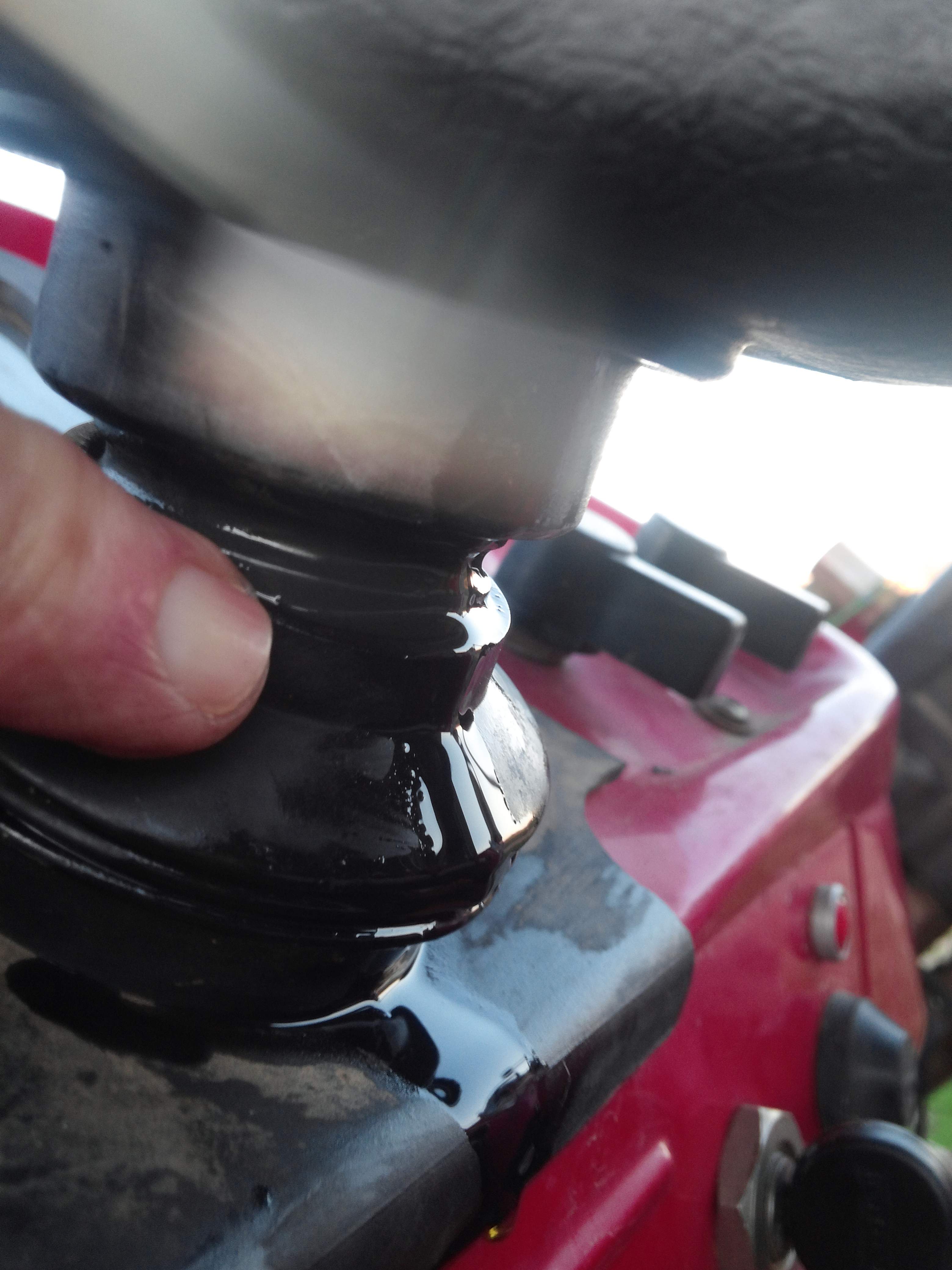

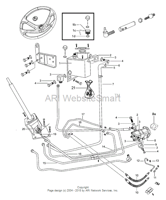

Mahindra 5500 4WD is leaking fluid from top of steering column under steering wheel. takes a little time to start and will drip steady. I have not removed Steering wheel yet.
Any ideas of what to look for to repair??

Fluid has to be leaking past a seal on the bottom of the inter column. Need a further break down. May be a common problem that the dealership has dealt with on similar tractors. That is where I would start at.
/ Help! Power Steering Leak #3
Looks like the steering box at the bottom of the steering shaft has a bad seal.
It's pumping the fluid up the shaft.
