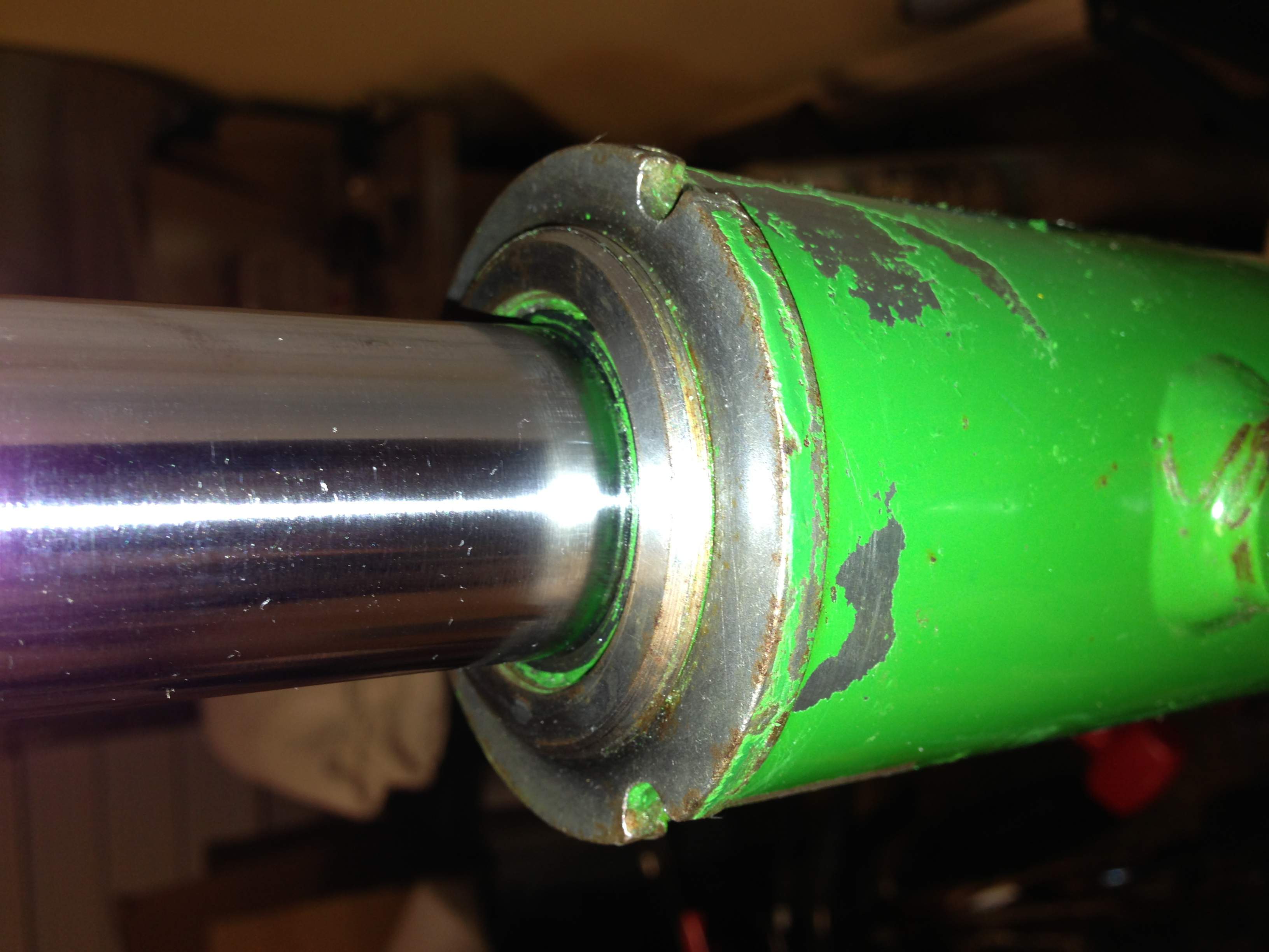

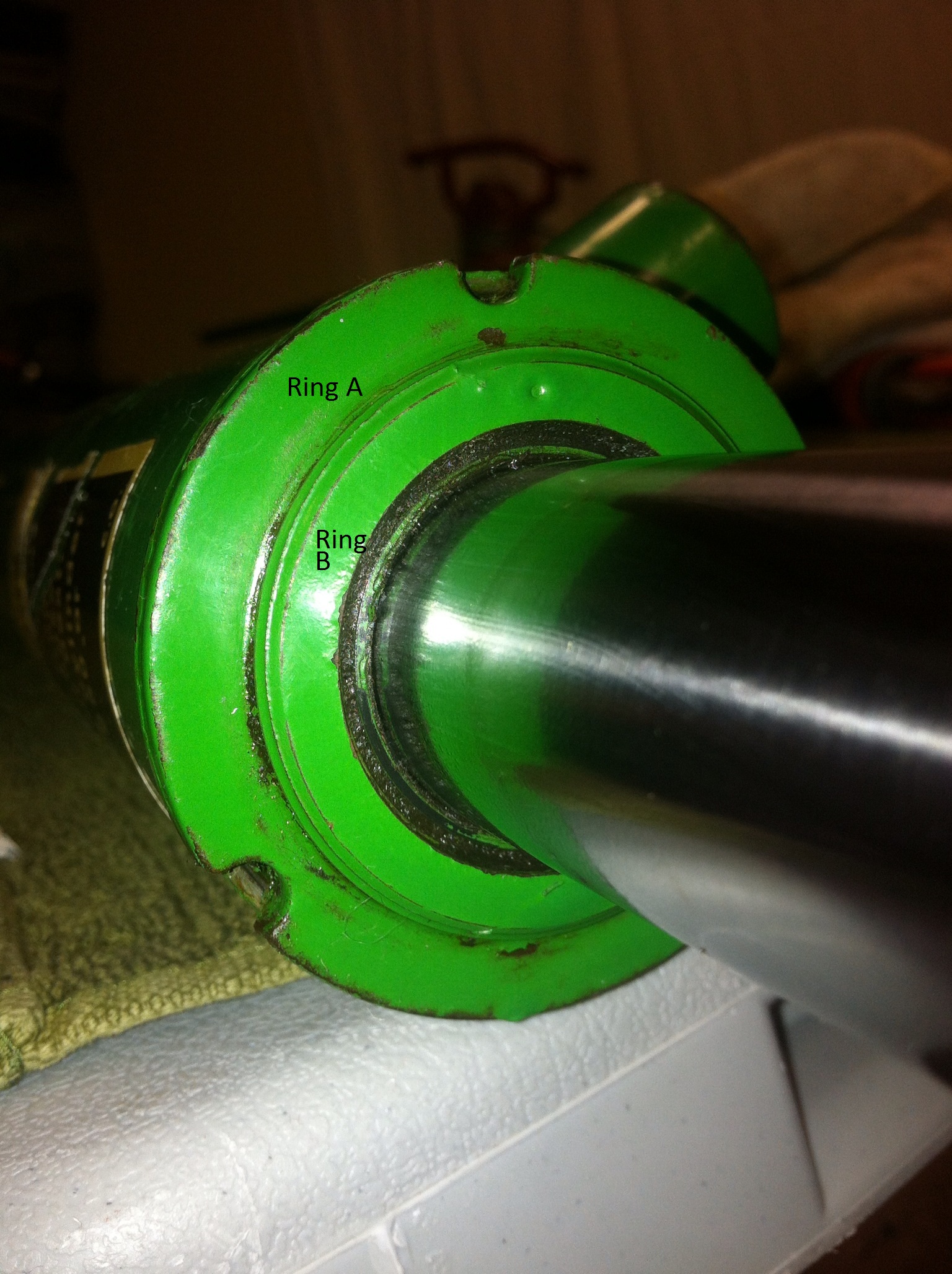

I'm trying to disassemble the cylinder on my JD model 90 loader to replace the seals. So far, I cannot figure how to get it apart and wonder if I need a special tool. A picture is attached, and when I put a wrench on Ring A and turn, both Ring A and Ring B turn together and all it does is rotate those parts in the cylinder. Based on the threads shown in the picture, Ring B is screwed into Ring A (or vice versa). Without ruining the threads, how do you hold one ring still, while turning the other?

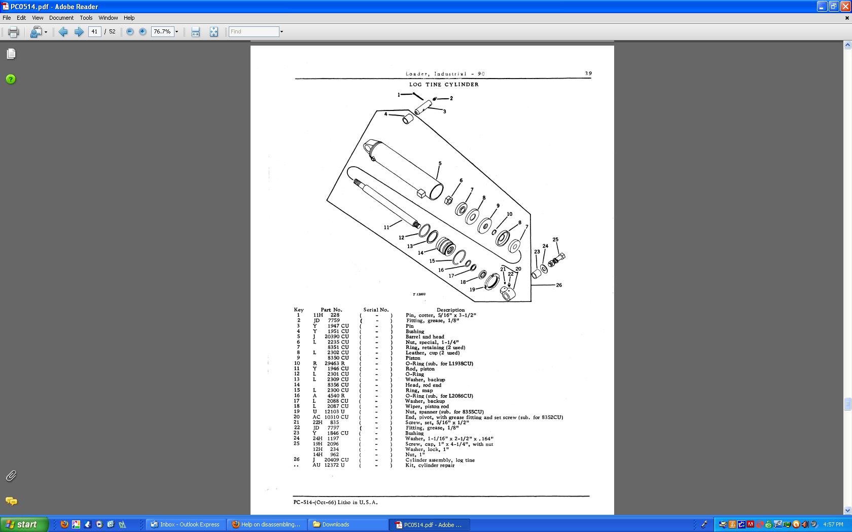

Here is a screenshot of the parts breakdown ( I think its the correct cylinder anyway-I am nor familier with that machine), I hope this shows what you need.

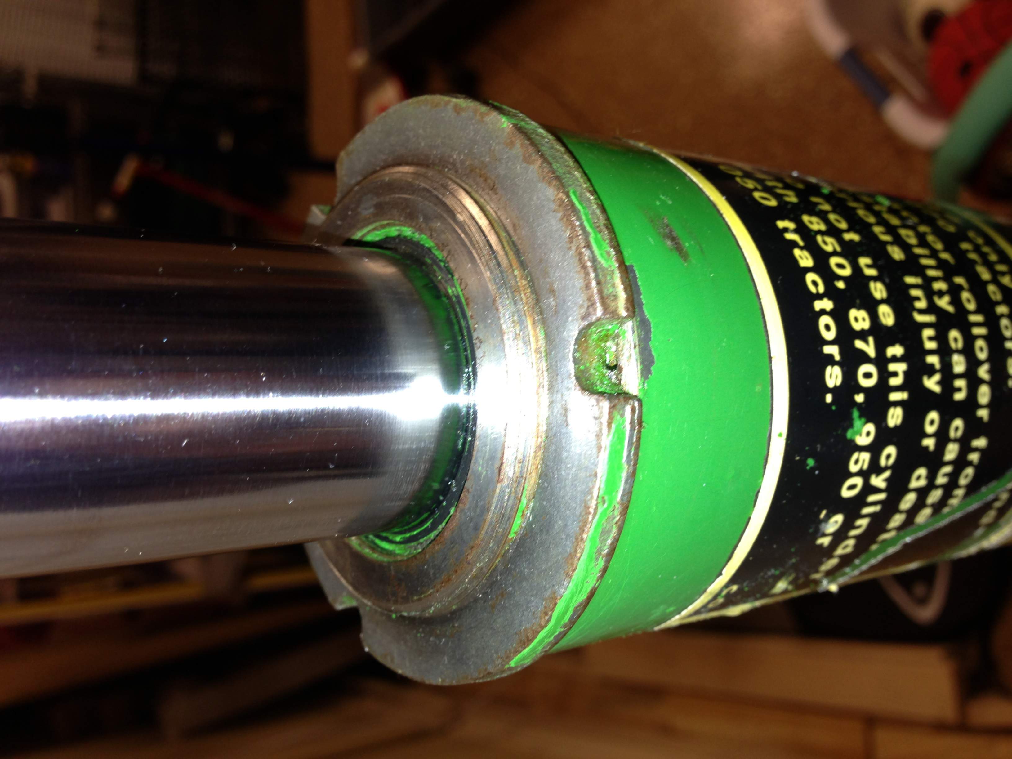

Is there paint covering spanner wrench holes in ring "B" (12 and 6 o-clock position) ?

If it's not too late, the best way to hold the inner gland is to power the cylinder with hydraulics on the extend position.......it will push on the gland out and keep it from turning.....allowing you to tap on the retainer with a punch to loosen it (or use proper spanner)
I usually do this before taking the cyl off the machine.......and after you completely reassemble, with the cyl on the machine, pressurize it out the same to hold gland and tap the retainer tight (while under pressure)
there are no threads on the gland holding it in the cyl barrel, just retaining lock rings under the gland (push gland in to expose them)

Thanks for the replies, but no luck so far. @wdchyd, reinstalling it and putting it under a load is still an option, but the cylinder is already off and I'm an hour away from the tractor until next week. @Willl, I thought that was going to be the answer as well, until I stripped the paint off - see the new photos - those were just paint drips. @kennyd - thanks for the parts diagram, which is spot on, but JD doesnt make it clear how that retaining nut is to be removed.

Using compressed air to hold cyl out i OK......but DO NOT use air to pop out the piston assy......You're gonna get hurt or the person standing in the room
after the retainer is unscrewed from tapping with a punch, you need to use an aluminum/brass rod to tap the gland head in about 3/4" to expose the round retainer ring tucked inside a groove in the cyl barrel.......then the gland head/piston assy can be pulled out (come-along or hammer)

lightly tap the outer ring with a dead blow hammer all the way around the circumferance of the head the resulting shockwaves will clean any rust / pain out of the threads use a brass drift in the notches in the ring to tap the ring the direction you want it to go lefty loosy righty tighty once you have the outer ring off of the gland you have to push the gland backwards into the barrel to remove the large circlip holding the gland in the barrel if you have the jd kit alredy it comes with an orange ring you can fit into the barrel to make removal of the piston /gland easer
