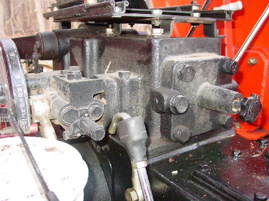

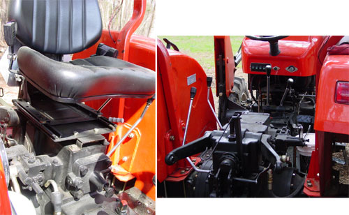

Was able to finally get the sump off last weekend and tear into it. Very interesting as will show in some following pics. Word to the wise for anyone else that is considering this: follow bluechip’s advice and use an engine hoist or a couple of big, strong friends. I was able to get it off myself, but, if it had been another 2 pounds heavier I couldn’t have budged it! That thing is a beast! Will post my hernia xrays. /forums/images/graemlins/grin.gif
Anyway, first pic is nothing exciting. Just the before and after seat removal. I was surprised how heavy the seat was. (4) bolts that go right into the case. The front (2) are simple to get out with a socket, back (2) take some effort with a wrench.

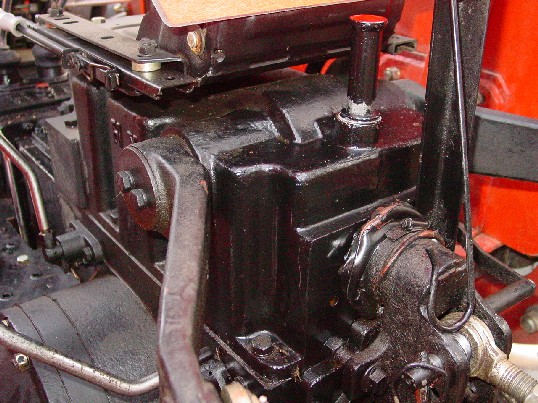

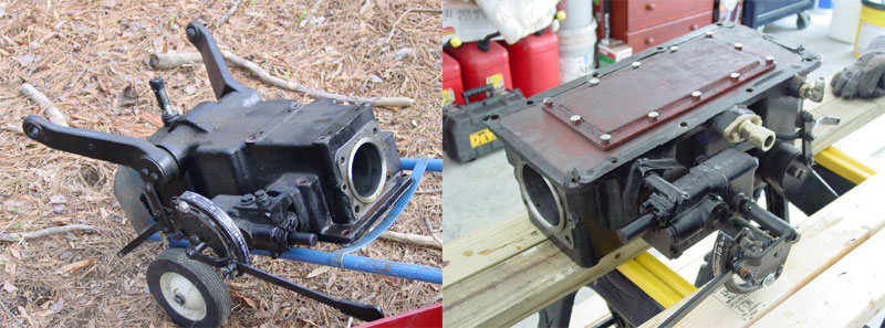

Hey Chip, Good morning. Had to stop and go have breakfast with my girls before I got all the pics up. Have some pics of the bottom. Believe the problem will become obvious. /forums/images/graemlins/laugh.gif
There was some questions around how the sump was mounted to the tranny. As you can see from the pic, the sump just bolts right to the top of the tranny.
Never wanted to see this sight but here it is.

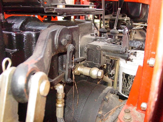

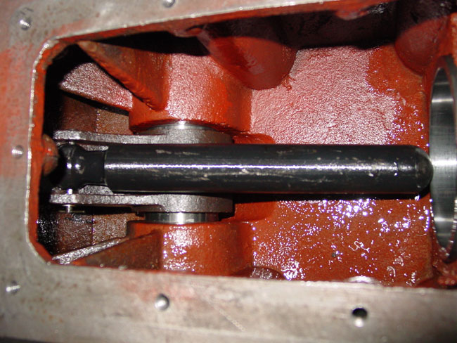

Got the case on the hand truck and in the garage. Got it up and flipped over where I could do a good inspection of the bottom. It was sort of like what I imagined from the diagrams in the parts manual, but the plate was much smaller. Good news is that I could not find any cracks or holes in the bottom – primary concern having to replace the casing.

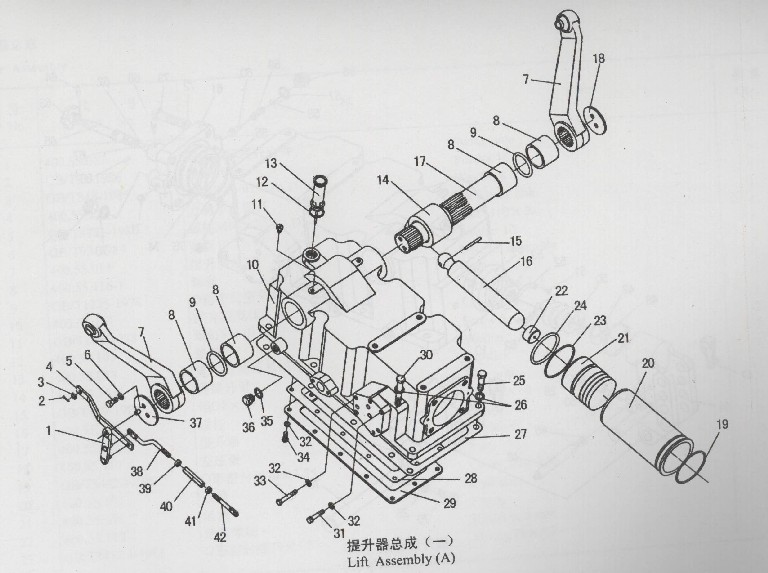

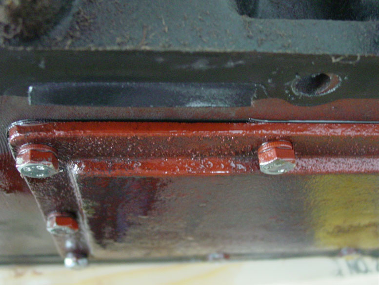

Next was to do a good inspection of where the plate mounts to the bottom of the case. This looks suspicious……
/ Help needed - leaking hydraulics issue

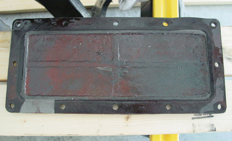

#48

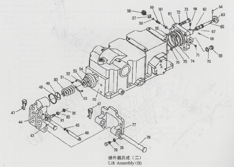

Now, I am not a master mechanic, but, I do think this could be my problem….
The hydraulic fluid was a slow leak. The level in the tranny was rising about a quarter inch every 12 hours. Believe this would allow a slow leak.
My concern though is where did this piece of gasket go? I am going to drain the tranny before I put the sump back on to see if I can find it. The other question is how did this get ripped and just fall out one day. What you see is exactly how I removed it from the case – it’s just gone.

Here's a couple of pics looking inside the case for those that are interested.

#51
My plan at this point is to go ahead and replace the O-ring. Will check the extra parts I got when I bought the tractor to see if I have one. If not, will get ordered.
I bought some gasket material and just going to make my own gaskets. Got the sealer and going to put down a good bead when I apply the gaskets. Definitely going to rent an engine hoist to put the sump back on. A buddy has offered to help, but, it would be a tight fit for two guys to squeeze in with this thing between the fenders – not to mention the strain on the backs trying to lean over the rear axle to mount this back on. Engine hoist I can be more precise and just lay it right on and (hopefully) not mess up the gasket.
Next step is get the gasket made and plate back on. Plan is to flip it back over, plug the inlet and outlet ports and fill it with kerosene. Then just wait to see if it leaks anymore. Once I am sure the leak is fixed, replace the O-ring, rent an engine hoist and get it all back together.
Anyone have any thoughts, tips or advice I should consider? Have made a couple gaskets in my life but it’s been a while. Any advice on repalcing the O-ring? Guess I just have to stretch the new one to get it back on. Any and all comments are welcome and appreciated.

Looks like you found the problem. be sure to check your vent, probably in the fill cap, to be sure that a pressure problem didnt blow out this gasket, you can make a new gasket, use some sealant on it, and put it back together, you will need to change your trans oil as it will be diluted by the hyd oil leaking in there.
A job well done...digging in and finding the problem! /forums/images/graemlins/cool.gif

</font><font color="blue" class="small">( The other question is how did this get ripped and just fall out one day. )</font>
Fall out? I doub't it.. may have been blown out if pressure built up behind it.. casting may be a tad irregular ont he cover of the case.. check it out..

Hey guys, thanks for the help and encouragement – appreciate the kind words on the pics. I do enjoy photography, however, the digital camera and photoshop probably has more to do with the pics than the guy behind the lens. /forums/images/graemlins/blush.gif Hope people do not mind all the pics, I just know when I was getting into tractorin’, pictures were a tremendous help. Trying to provide a little documentation and assistance for the next person that goes through this.
Current update: I made a gasket for the reservoir cover. Used RTV and laid down a nice thick bead around the perimeter and holes. Soundguy, agree the paper gasket should be good enough, but, I was really concerned about the flatness/tolerances of the case and cover machining. I placed a metal straightedge to look for gaps. Didn’t see any on the case but the cover is rough cast and is not totally flat. The cover is a little warped but does flatten out when bolted down – explains the need for 12 bolts holding it down. For this reason, and thinking additional RTV wouldn’t hurt, I went ahead and used the RTV.
I have replaced the O-ring. Totally agree. Kinda crazy to do all this work and not replace it – I do not want to do this again. I was getting impatient and wanting to get everything back together this weekend and didn’t want to wait on ordering one. I dug back through the spare parts tool box I got from the dealer and found one. Slipped it on and appears to be OK.
Still don’t have together though. I let the RTV cure yesterday and hope to get the case flipped over this evening and put some kerosene in there to check my seal and for any leaks I might be missing. Hope to get the engine hoist this week and get her all back together before the weekend. Off next week and have a lot of seat time to make up. /forums/images/graemlins/laugh.gif /forums/images/graemlins/laugh.gif /forums/images/graemlins/laugh.gif /forums/images/graemlins/laugh.gif
