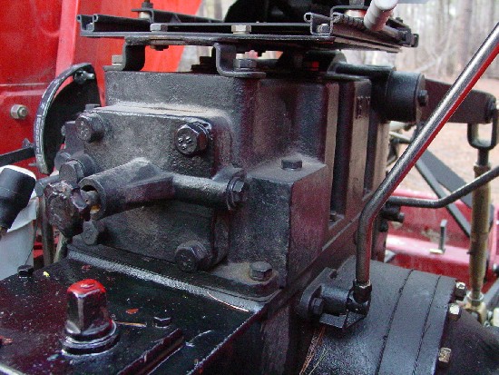

Hey Chip.
Here is the view from the back. It's not a direct shot of the back but you can see the housing. The housing/clip, where the top link attaches, spans both the sump case and the axle housing.
It was mentioned that this was the mechanism for the draft control. I didn't think I had draft control, if I do, I don't know how to use /forums/images/graemlins/confused.gif Some one please correct me if this is in fact for the draft control. I am a novice.....
My thought was this is where a leak could be occurring - draining into the axle housing if this piece has a cavity.

Another view from the back looking forward - back of the lever and valve assy. Not looking forward to removing these hoses.

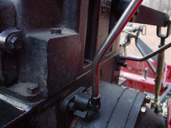

#23
View from the front looking down the side towards the valve assy.
Chip,
Was thinking I could remove the front cover here and look at the piston. Was not sure though if I saw the O-ring trashed how I would get the piston out. Will start with taking the front cover off and go from there.

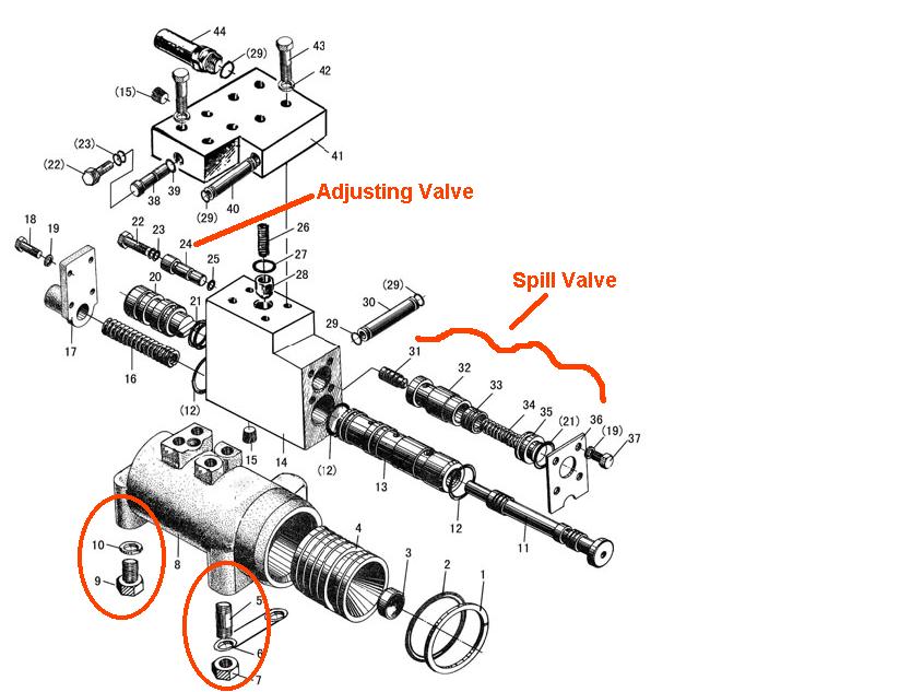

#24
View 1 of the sump case parts diagram.
Notice the plate, part # 29. Appears in the diagram it is only 3/4's the length of the case. If the plate is totally internal and there is a chamber in the back, I can see where this could leak into the tranny.
Will be sure to take plenty of pics and document if I end up pulling the housing off. I am just curious how all of this works inside.

#26
Diagram of the lever and valve assembly.

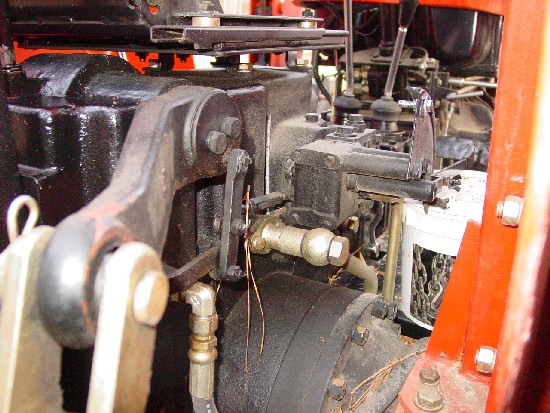

#33
And finally, the right side (looking from back to front on the tractor). I removed the down link to show the rod going to the arm.
You know, the "chenglish" (like that one Larry) manual is not all that good. I remember reading about draft control, but I did not think I had it. Seems like the dealer may have told me that. Need to get the manual back out and take a look.
Now that I look at this, that arm going from this assembly to the linkage on the lifter is there for a reason I would think. I have always been curios why the rubber boot is there at the top of this assy. Looks like to me its there to provide protection and be flexible, especially if this thing is suppose to flex/pivot. Very interesting......
My apologies for my tractor being so dirty - its a disgrace I know but its like I use to say about my old truck - a dirty truck is a happy truck. Picked me up a new Craftsman 3000 PSI pressure washer Thursday night. Going to give the tractor a good hosing off before I get into this (not at full pressure though /forums/images/graemlins/cool.gif ).

Either the bolts need to have some play.. or they fit in a blind recess behind the plate, or just plain fit behind it. Diagram shows nuts.. assuming you don't have to take the top cover off to get to those nuts.. I'd say the nuts go behind the plate.. 77 Hard to tell from his pics.. we need a profile shot as well as a lower shot showing all of the pivot pices and anchor piece. But yes.. I do think it is aprt of a feedback setup.. whether it is fully implemented, or locked out.. hard to say without those pics.
Soundguy
/ Help needed - leaking hydraulics issue #35
</font><font color="blue" class="small">( Chip, Larry and Chris/Soundguy,
WOW! Nice to have three people as knowledgeable as you guys looking at this. More pics attached.
)</font>
Ok..this pic is telltale guys.. take a close look at this one.. expand it on your screen if using ie6. Part 44 pivots on part 77 via pin 78. Now.. part 77 appears to be bolted securely to the lift housing. However, there appears to be relief room behind 44 for the bolt/nut.. perhas this bolt and nut is a 'stop' limiting max pivot?? hard to say.. but look at that pic right where the bolt is on 44.. not look where the nut would be.. you see a relief int he metal that leads me to believe that part 44 is free floating to pivot on 77.. also.. there appears to be a rubber gasket/oring to keep water out. I'd guess it is fully functioning feedback, assuming you have a draft control somewhere, unless the stop bolts can be adjusted to 'turn it off.. etc.. by taking all the pivot room out.. etc.. That's my unprofesional opinion anyway....
Soundguy

</font><font color="blue" class="small">( Now that I look at this, that arm going from this assembly to the linkage on the lifter is there for a reason I would think. )</font>
Yep.. this is deffinately feedback linkage..
Soundguy

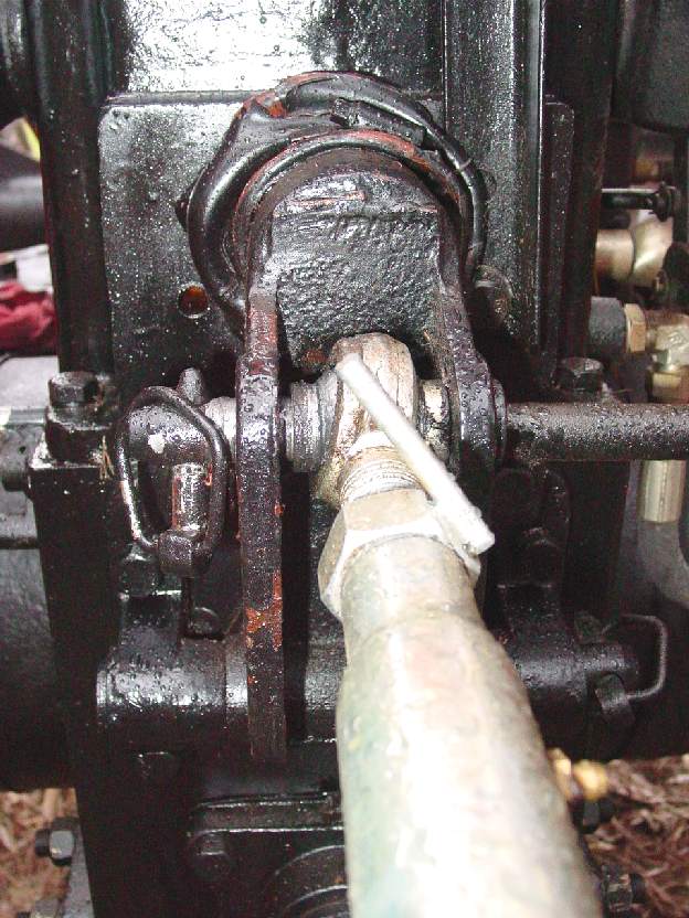

/ Help needed - leaking hydraulics issue #37
Ok there is some sort of lever here what does it do?
Maybe this is what is moved (by hand) to allow the yolk to pivot?

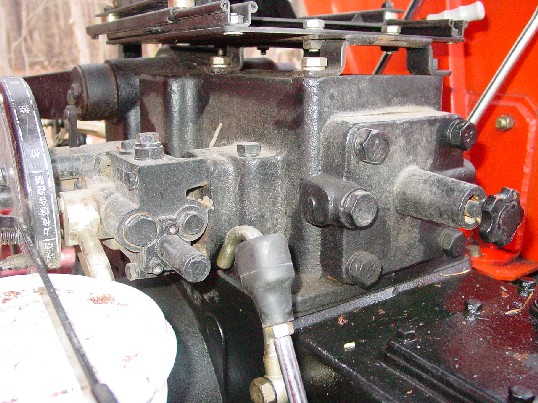

/ Help needed - leaking hydraulics issue #38
And some sort of other gizmo ?

/ Help needed - leaking hydraulics issue #40
</font><font color="blue" class="small">( And some sort of other gizmo )</font>
Looks to perhaps be a blank or plate under the bracket and pivot.
That other linkage bar you outlined in you last post deffinately looks like some kind of mechanical feedback linkage. if you will notice, one end is hooked to the lift arm, and will 'cam' arouns as the lift arm lifts... thus pushing that linkafe back.. ohter end of the linkage is on the pivoting toplink rocker.. deffinately looks like it is a feedback linkage.. could be a real crude position control gauge.. or could be for draft. I'd really have to see the parts breakdown and have one in my hand to make a further exact diagnosis.. but I'm deffinately seeing feedback linkages.. not sure how their valving works , or if it is a constant draft / or conventional position controll.. or an inching design..
