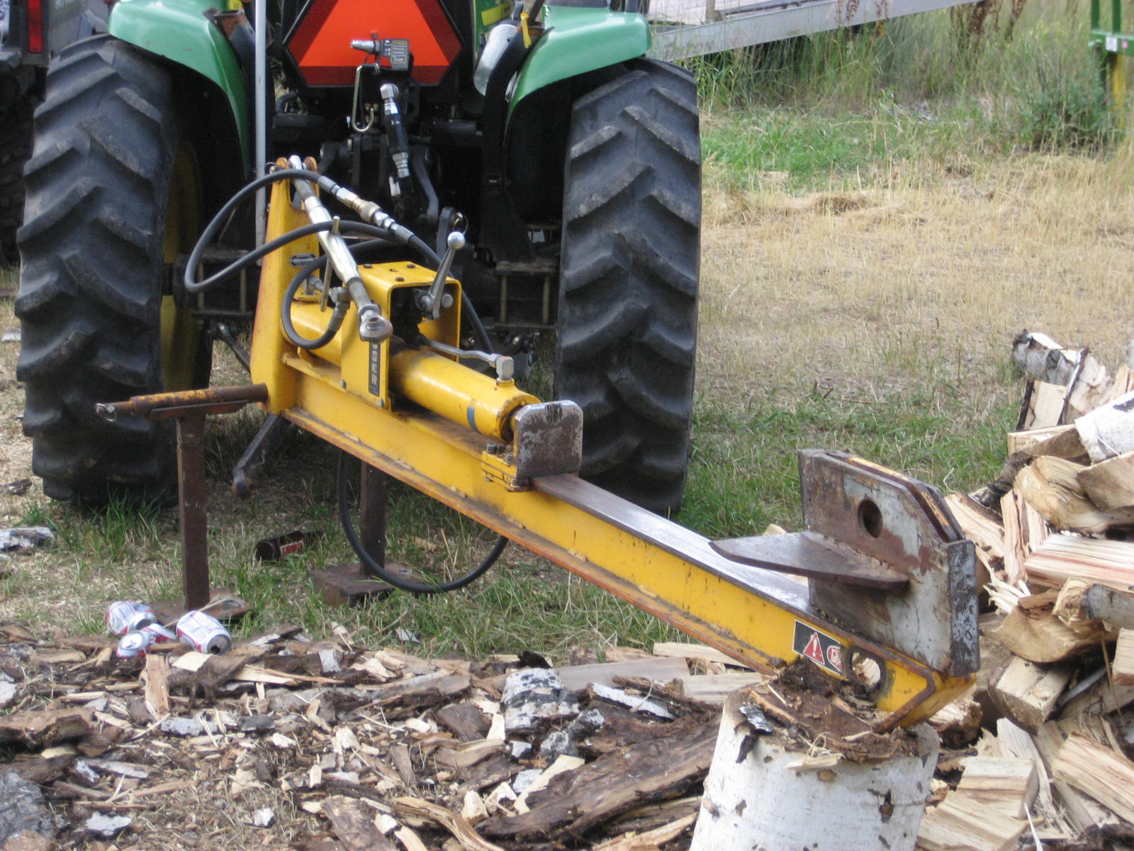

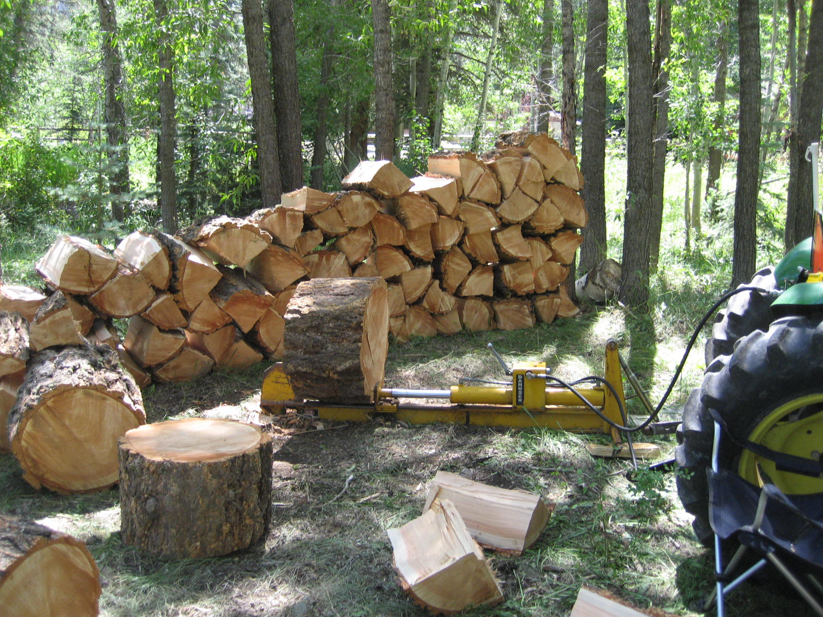

Since our splitter is 3pt, we opted to lower it down, and 'quarter' them up, then lift it back up, and put the legs back on.
My Dad on the splitter...
Don't have a loader, but I guess a cherry picker would work the same, or block and tackle.
Works for us.
