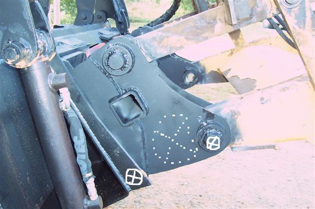

John,
I have this picture that I put an "X" with a circle around it where I need to have one anchor point on the grapple. It's my only option due to whatever I do, it will have to work on the bucket too.
One thing that adds to this is that the Quick Attach has some play on where it hooks up left or right. It's very likely that it won't be perfectly centered.
One option for the other end will be to loop an eye bolt over the pin. The pin is 1 1/2 inches, so the inside of the eye bolt will have to be that big. I can lock it into position by welding a washer onto the end of the pin, but then I run into issues on how to attach it to the grapple so that I can take it off and on, plus tighten it up.
Eddie

Eddie, is there any way you could weld some chain or run some chain and secure the bucket and grapple with a ratchet type chain binder?
Sincerely, Dirt

Your pins are popping out on the bottom, aren't they ?
If I remember correctly, we had somebody here on TBN long time ago with the same problem.
I thought he swapped his pins around so the bevels was facing forward, but I could be wrong.

Is there enough stock so you can drill and pin it in place?

you need to look for the reason it is poping loose!! The quick attach has been used on skid steers and backhoes such as yous for years, and they don't pop off it is designed for pressure in all directions. there must be a miss alignment or to much play some where.
Jeff

If the turnbuckle only needs to turn on one end Eddie you could use ordinary threaded rod, a nut, some strap iron and your welder and you have whatever size you wish.:) [ build your own]:)
One turnbuckle on the sway adjust of the three point hitch on my tractor had the nut threads stripped out. I got the fellows to weld up a new threaded rod and bolt on the old one. It works but has to removed to shorten or lengthen it as I didn't bother to get a reverse thread nut.:)

Dirt,
I looked at chain binders, but didn't find any that would fit. That is sort of what led me to the turnbuckle idea, which also doesn't seem to fit. LOL
Will,
We think alike. That was the first thing that I tried, and after the nightmare of putting it back together again, wish I hadn't. The bevel fits flush with the angle of the bottom bracket. When turned around, it doesn't even go down. Big mistake.
LeeJohn,
I've gone over it from every angle and just can't come up with a place that I can drill through both pieces to bolt it or pin it in place. I did consider welding on two or more "holes" that I could slide a pin through, sort of like a pin on a hinge used for a house door, but I come back to the issue of having to align the attachment with the quick attach perfectly every time. It's one of those simple ideas that gets very complicated the more I consider it.
smitty,
You're right about the use on skid steers, but I don't think this has been done very often on a full sized loader backoe. From what I've seen on skid steers, I might not have any problems back dragging with the bucket on since skid steers seem to do this all the time. Or I might since my tractor is so much larger and heavier. I don't know how much this factors into it, but that might be the reason quick attach's are not used on full sized equipment. The stuff that I have seen is different, but I haven't seen enough to know how it's done.
The problem is when I'm using the backhoe. The front bucket, or in this case, the grapple is down and supporting the front end of the tractor. All that weight is on the grapple, which shouldn't be a problem, it's plenty strong enough for this. But then when the backhoe catches on something, like a root, and pulls the tractor backwards, the quick attach pops off. It's only happened twice, but now I'm extra careful to avoid this by not having the grapple all the way down. It's a terrible way to use the backoe, and not something that I plan to live with.
Egon,
McMaster Carr has Eye Bolts with 1 1/2 inch openings in the eye. The threaded end would work similar to what you are describing and where I'm at right now in my thinking. Where I'm hitting the wall is how to create a bracket or link to attach the threaded end to the grapple in such a way that I can take it on and off, tighten it up and make it secure.

Eddie,
I may not fully understand your problem but with that in mind...
The first thing I would look at is the toggle mechanism that holds the pins down in the lower holes of the attachments. I think they interposition some coil springs in there to make the mechanism more forgiving of the tolerances among attachments. Those springs may be softer than you need and you could add some shims to pre-compress them?
Another thought is to weld on a piece around the lower QA holes to effectively thicken the steel that the pins have to "jump" to escape. A secondary benefit to this is that it will put the pin stress, during pulling, on a thicker part of the pin's taper, possibly your next problem.
In the meantime, have you tried rolling your attachment forward before supporting the front of the TLB, just to change the direction of the pulling force relative to the pin?

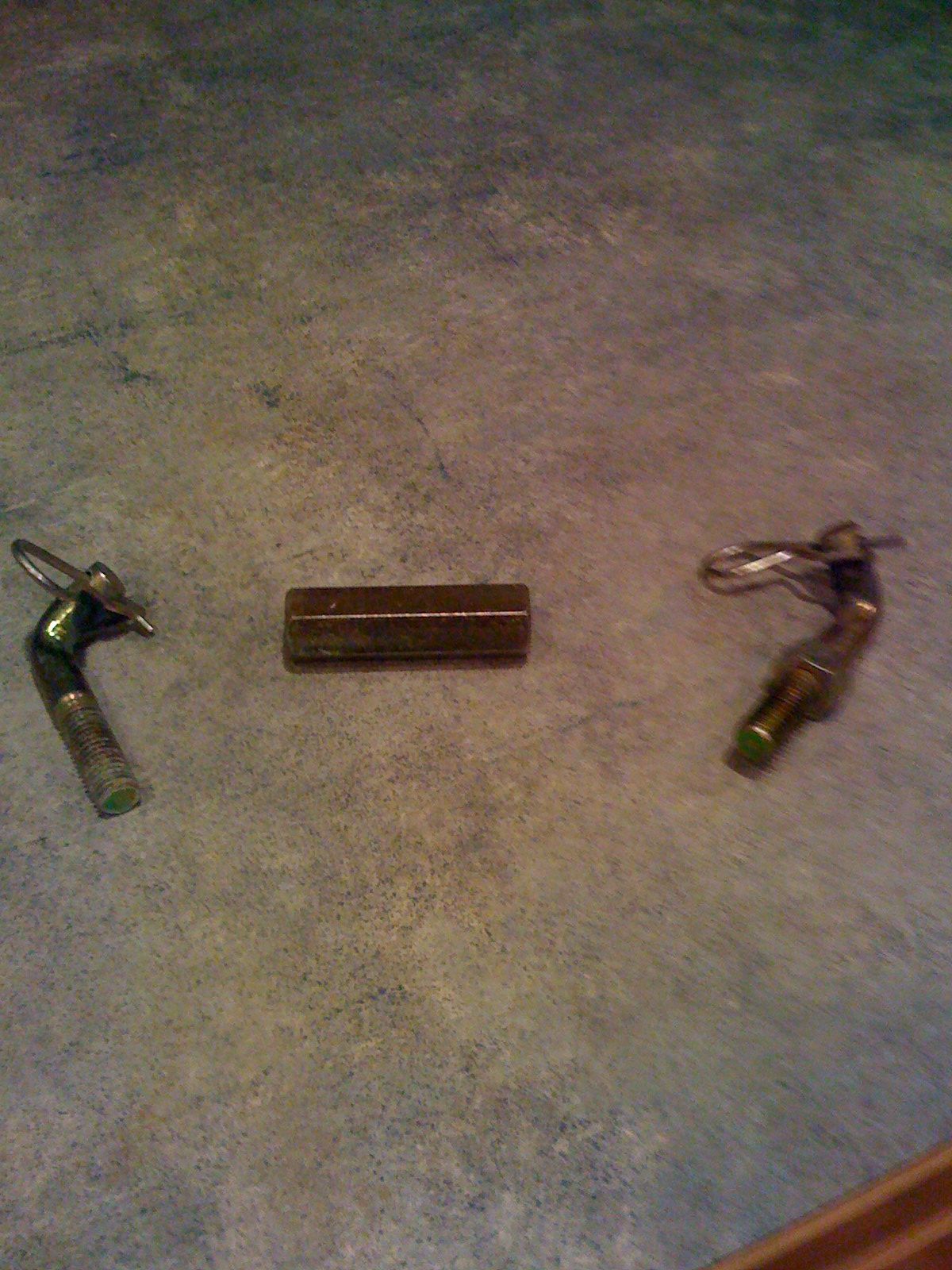

Eddie,
This may work for you, 7.25 inches screwed in but threaded end could be cut off 3/8", the treaded rod is 5/8" diameter.
Email at jmarotz@mac.com. Make you a good deal.

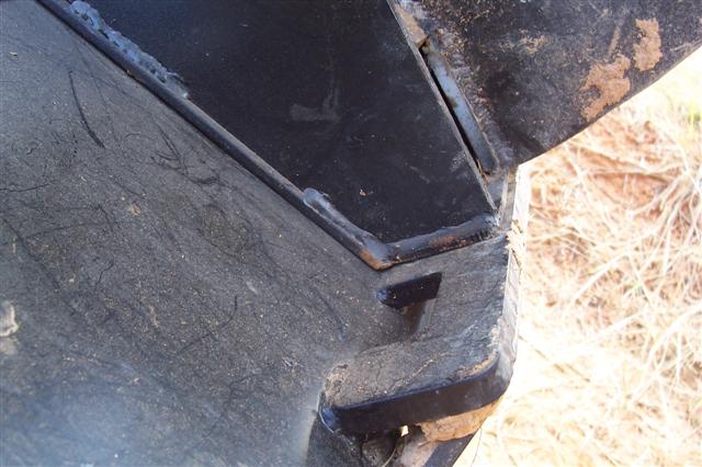

Eddie,
I'm still missing something here. WOuld ou be so kind as to post some more pics? I would like to see the back of the QA plate on the grapple and the mating fixture on the tractor.
Have you contacted the company you bought the grapple and QA from?
jb

Here's a few more pictures of the QA. One thing that might add to my problem is the bracket that I created to make it work with my loader. I don't know, but I agree with everyone that this shouldn't be happening, or at least it doesn't happen in other applications.
I can't see anything that is wrong with the attachment or why it's coming apart. I can only guess it's a combination of things. Too much HP/Hydraulic power. Too much weight, and the design of the bracket.
Eddie
