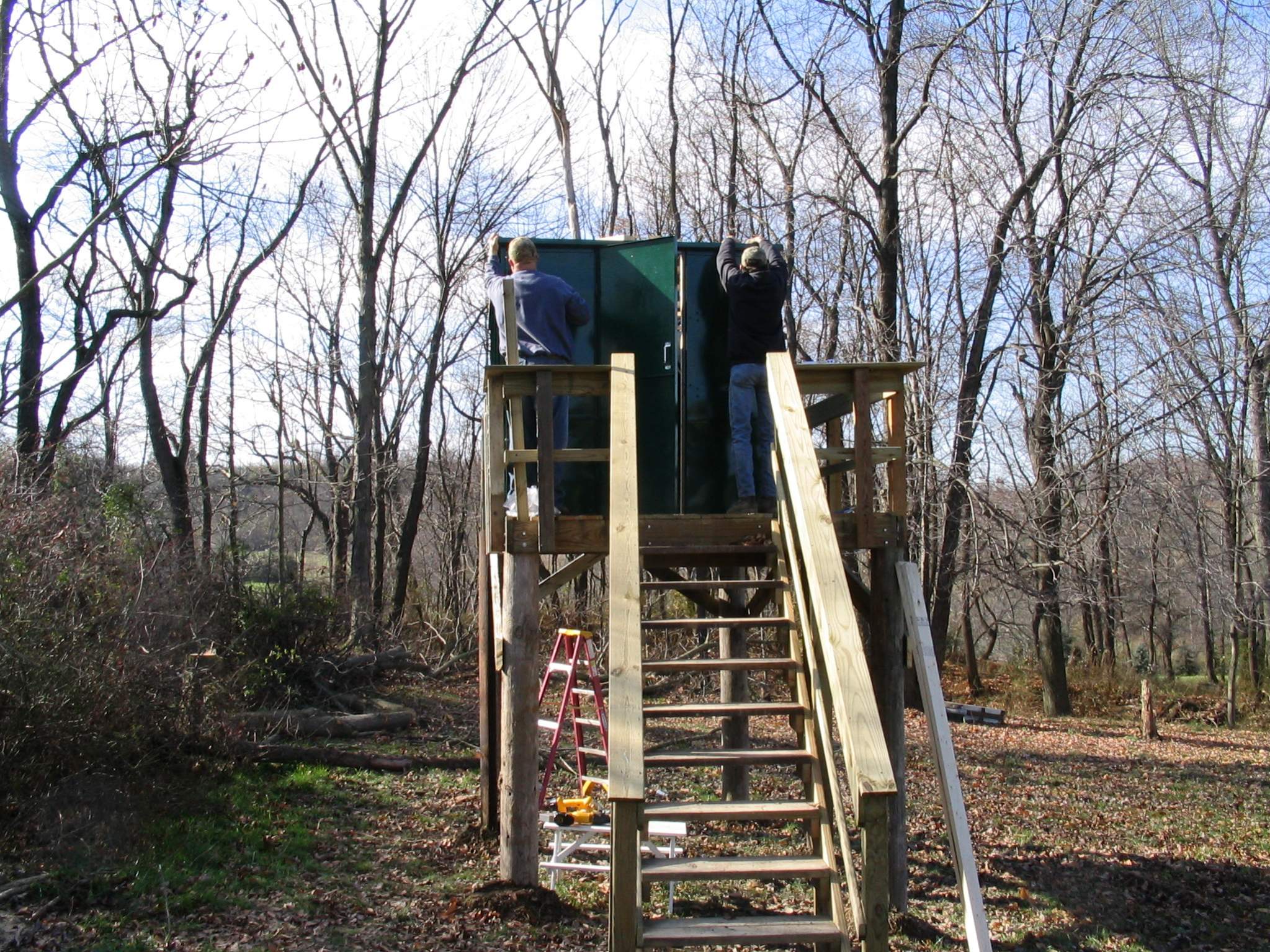

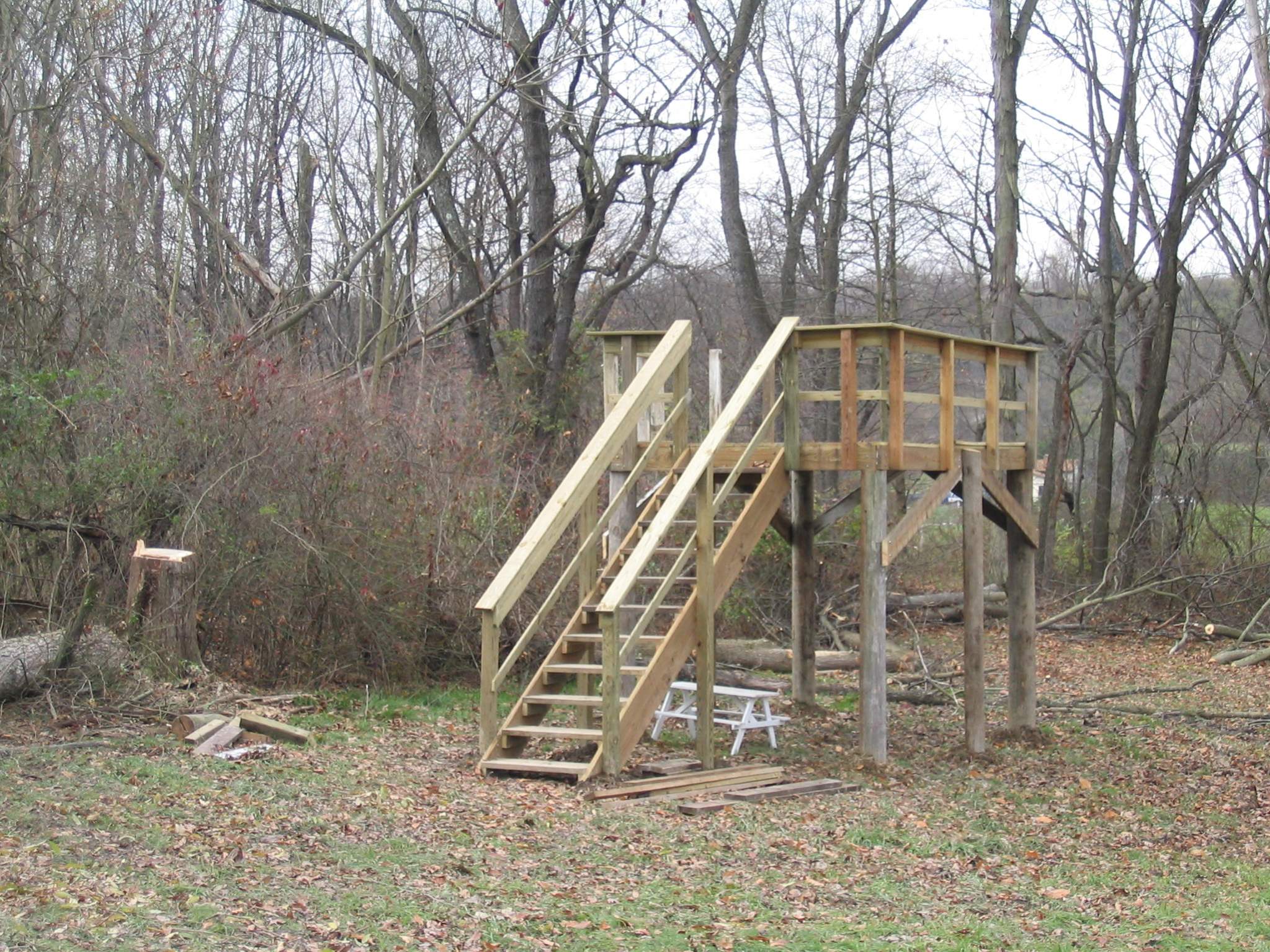

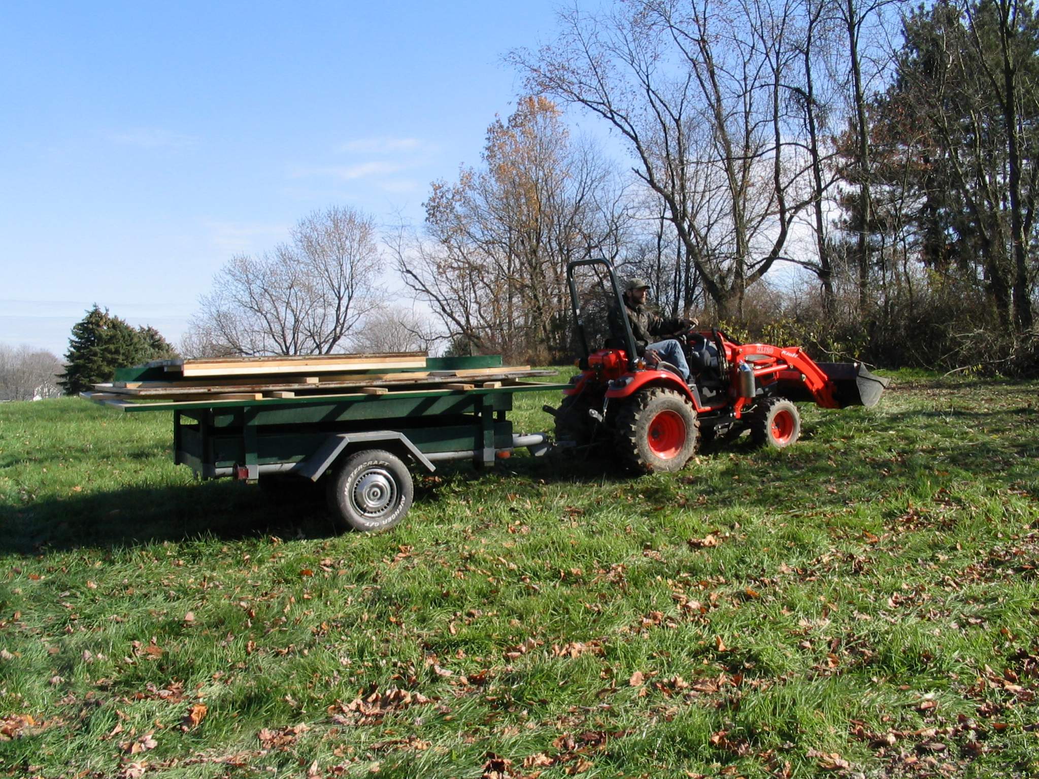

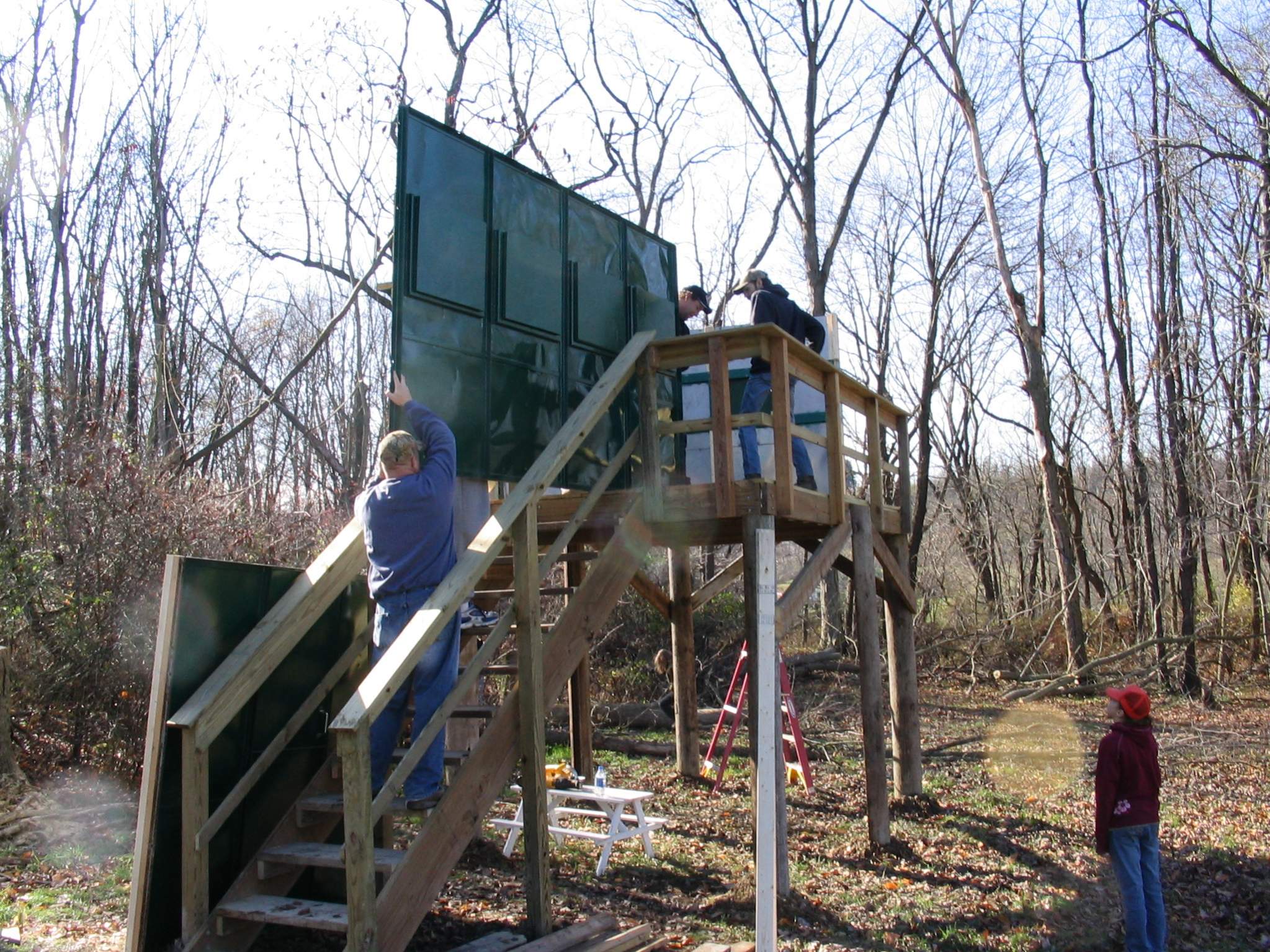

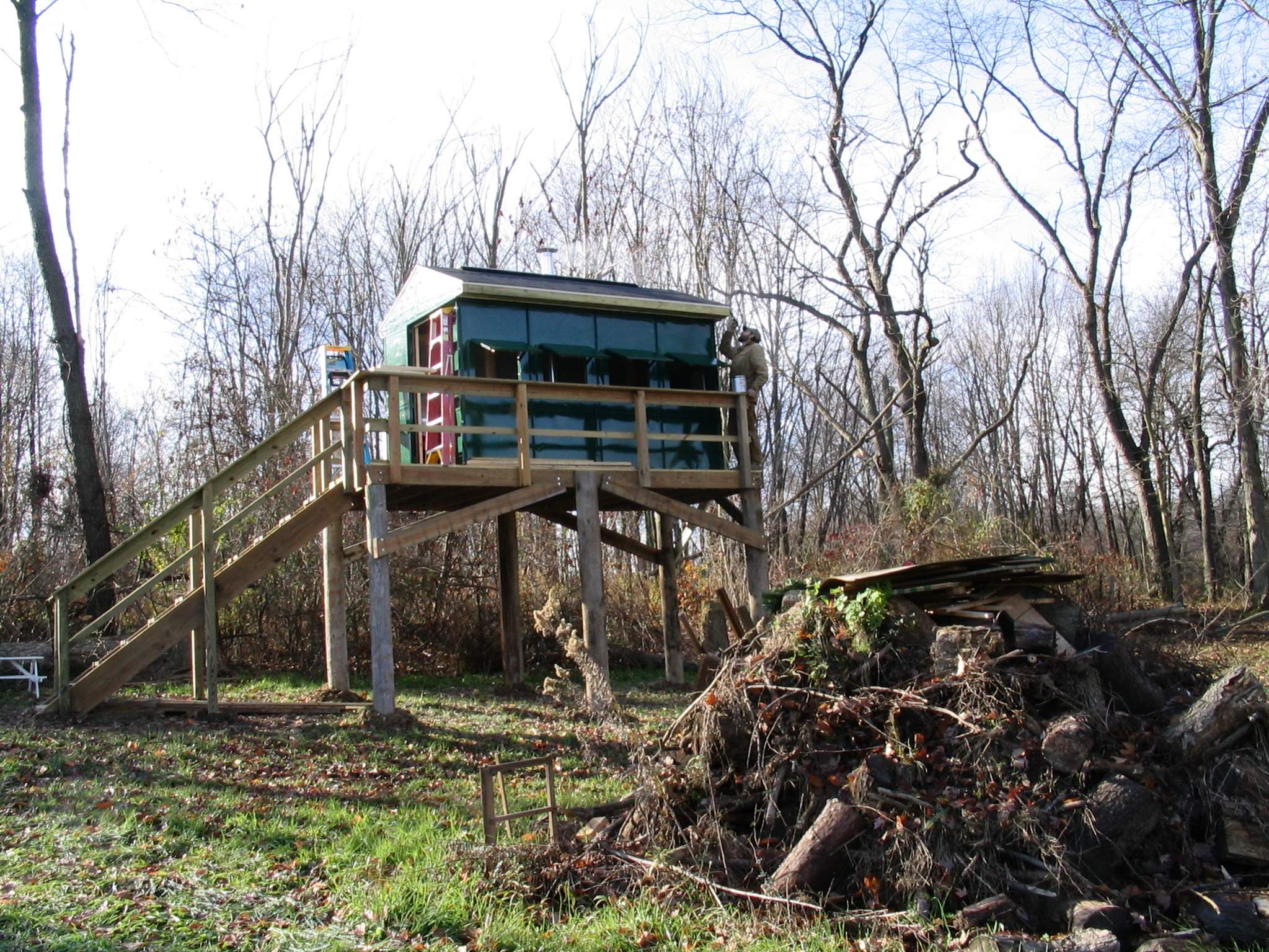

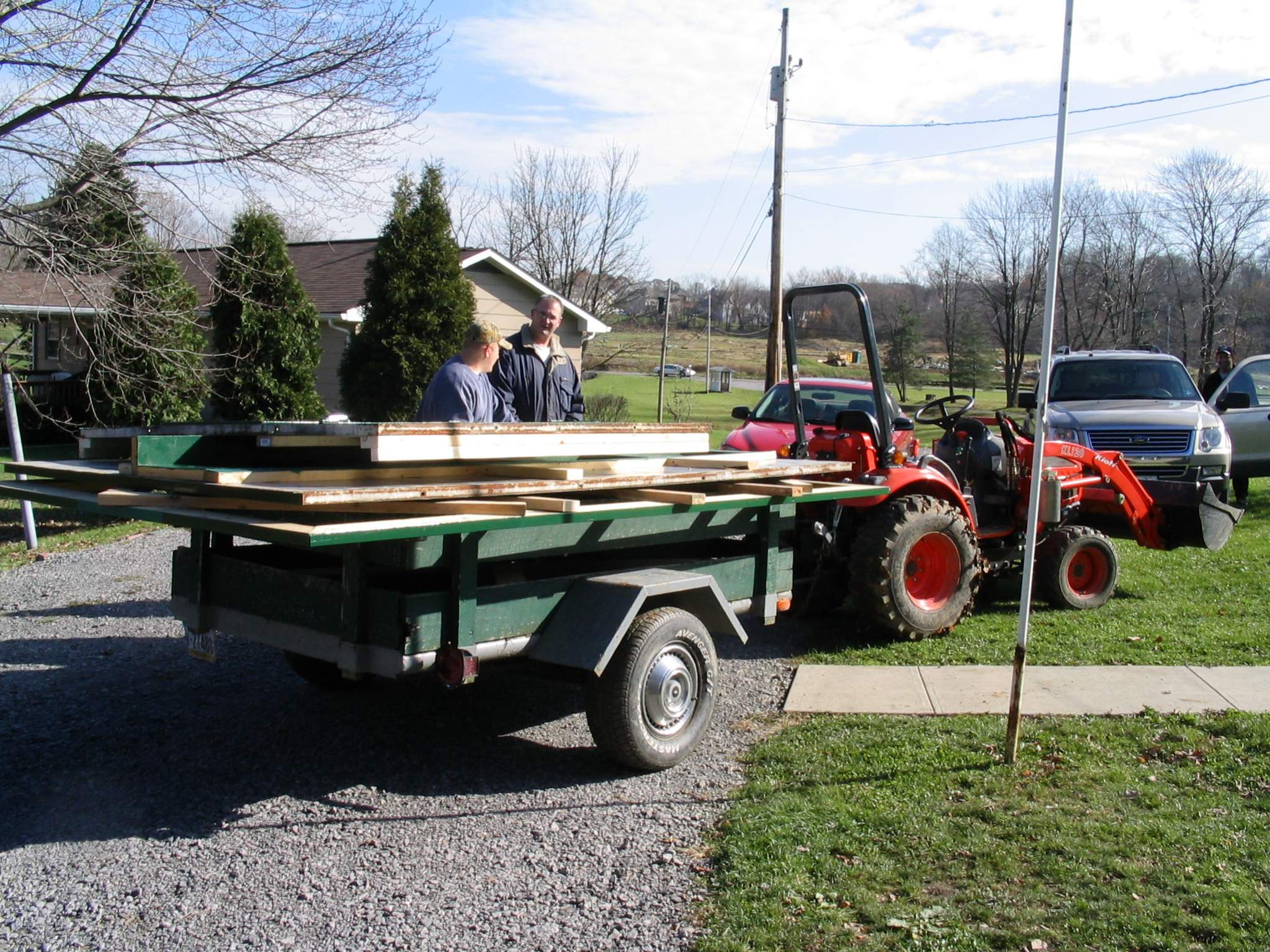

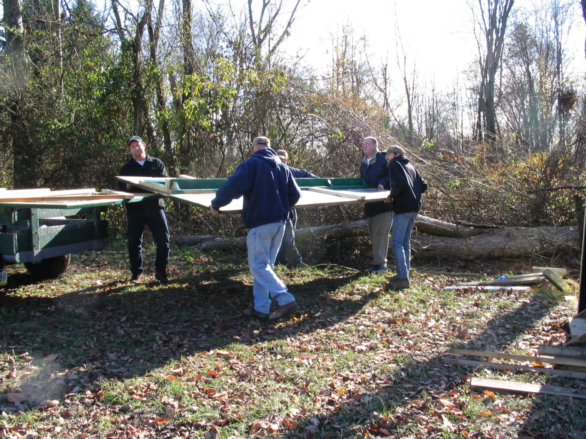

here are some pics of the deck and when we hauled the walls out. sorry i didn't take any pics of the building in process while we worked on it in the garage.

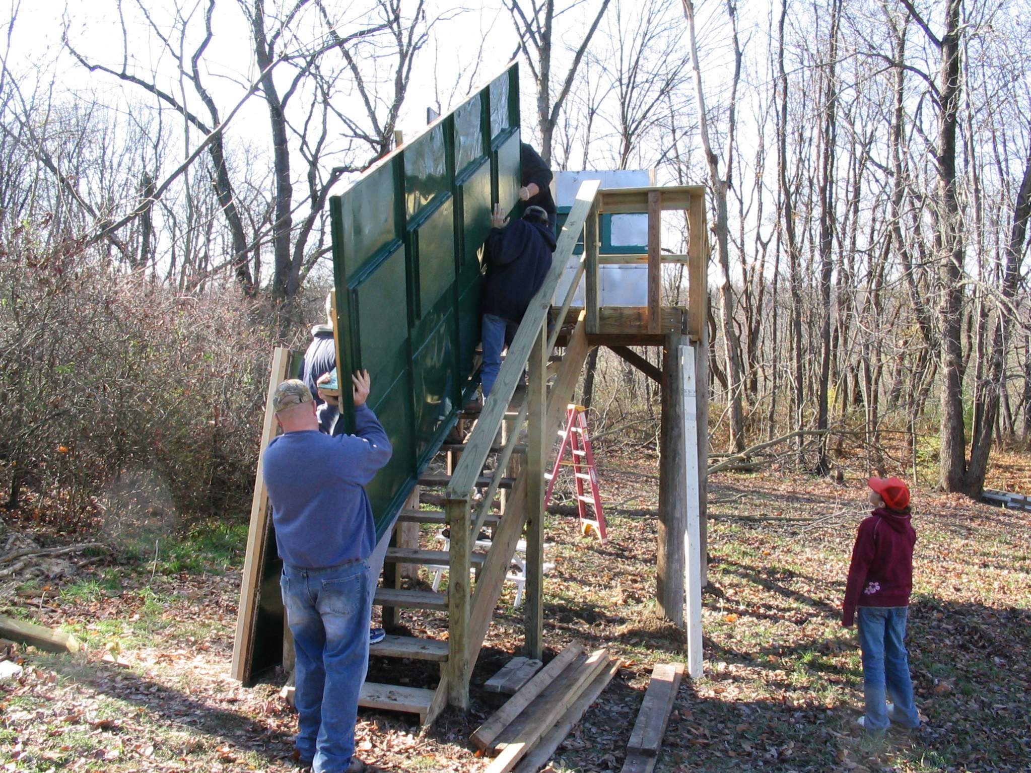

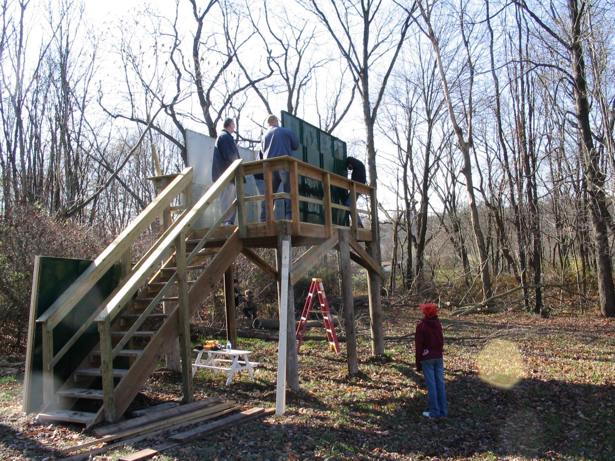

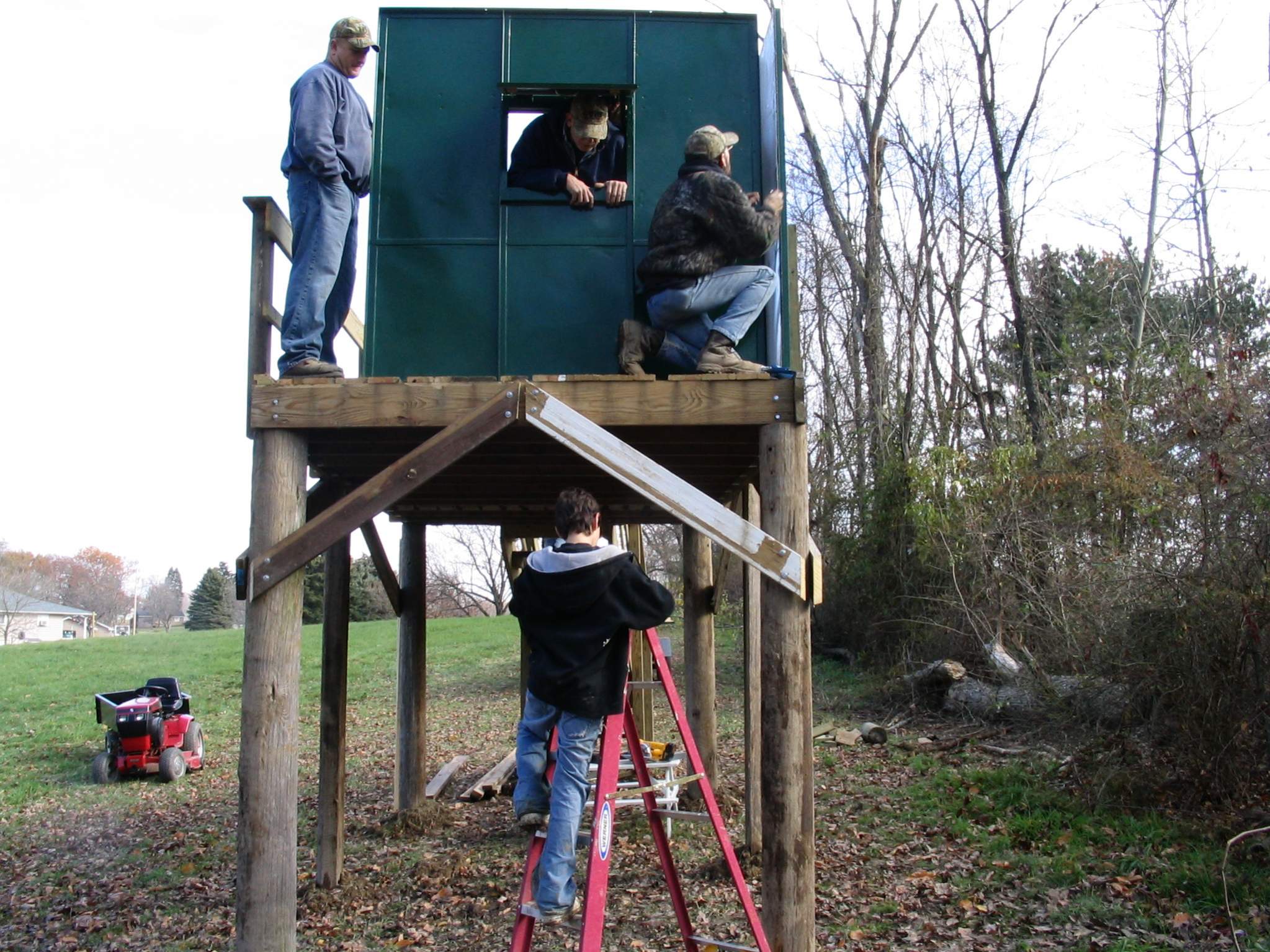

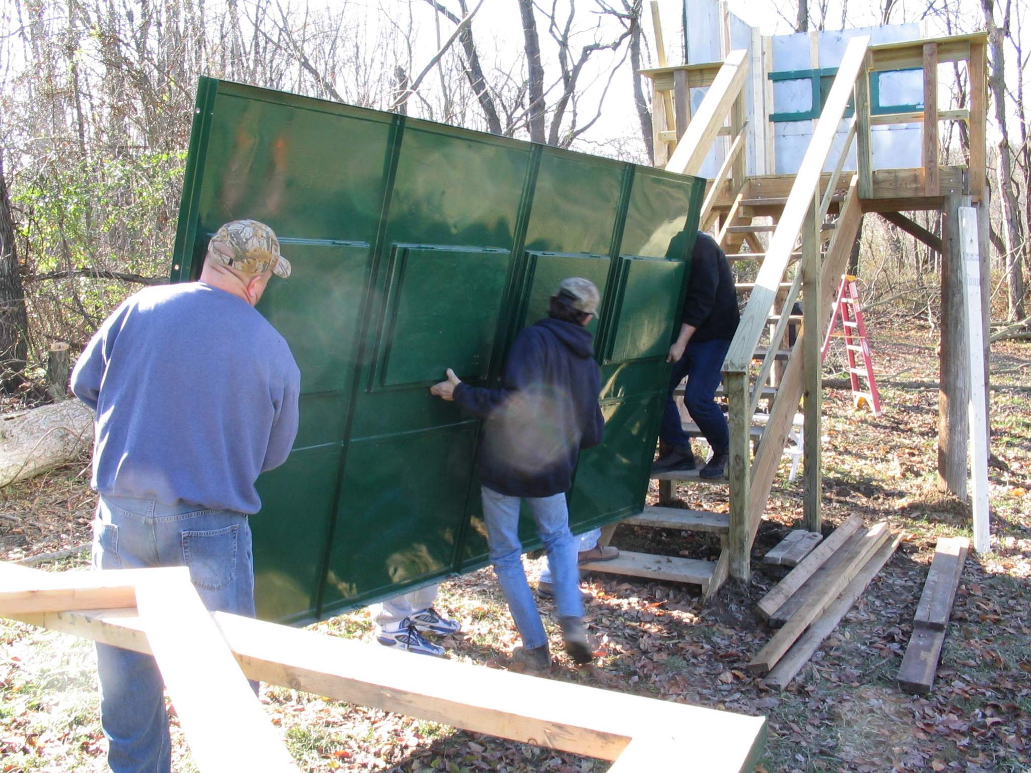

unloading walls and assembling. silicone was use on floor and all corner joints when walls were bolted together. front wall was the heaviest because of the four windows.

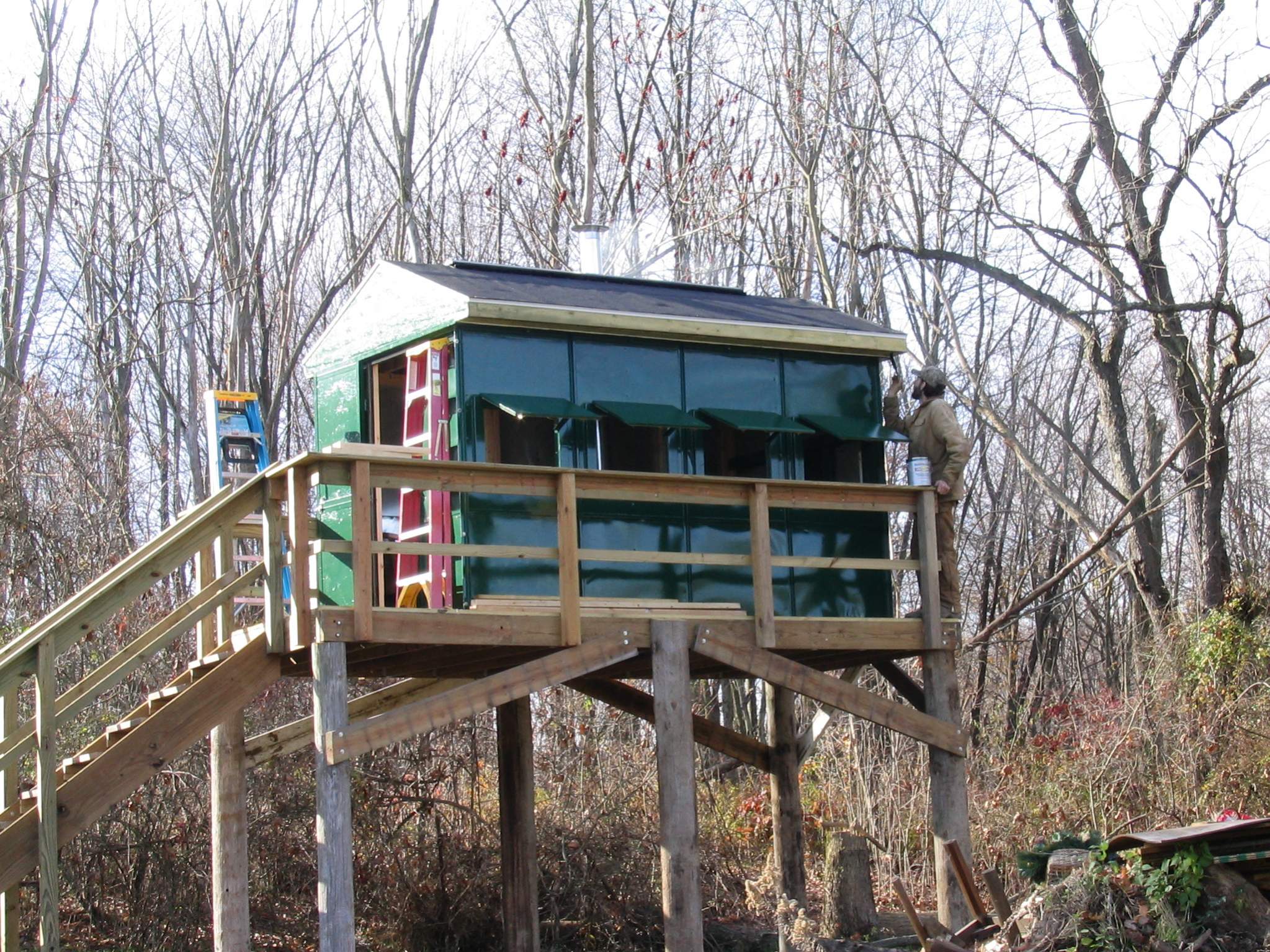

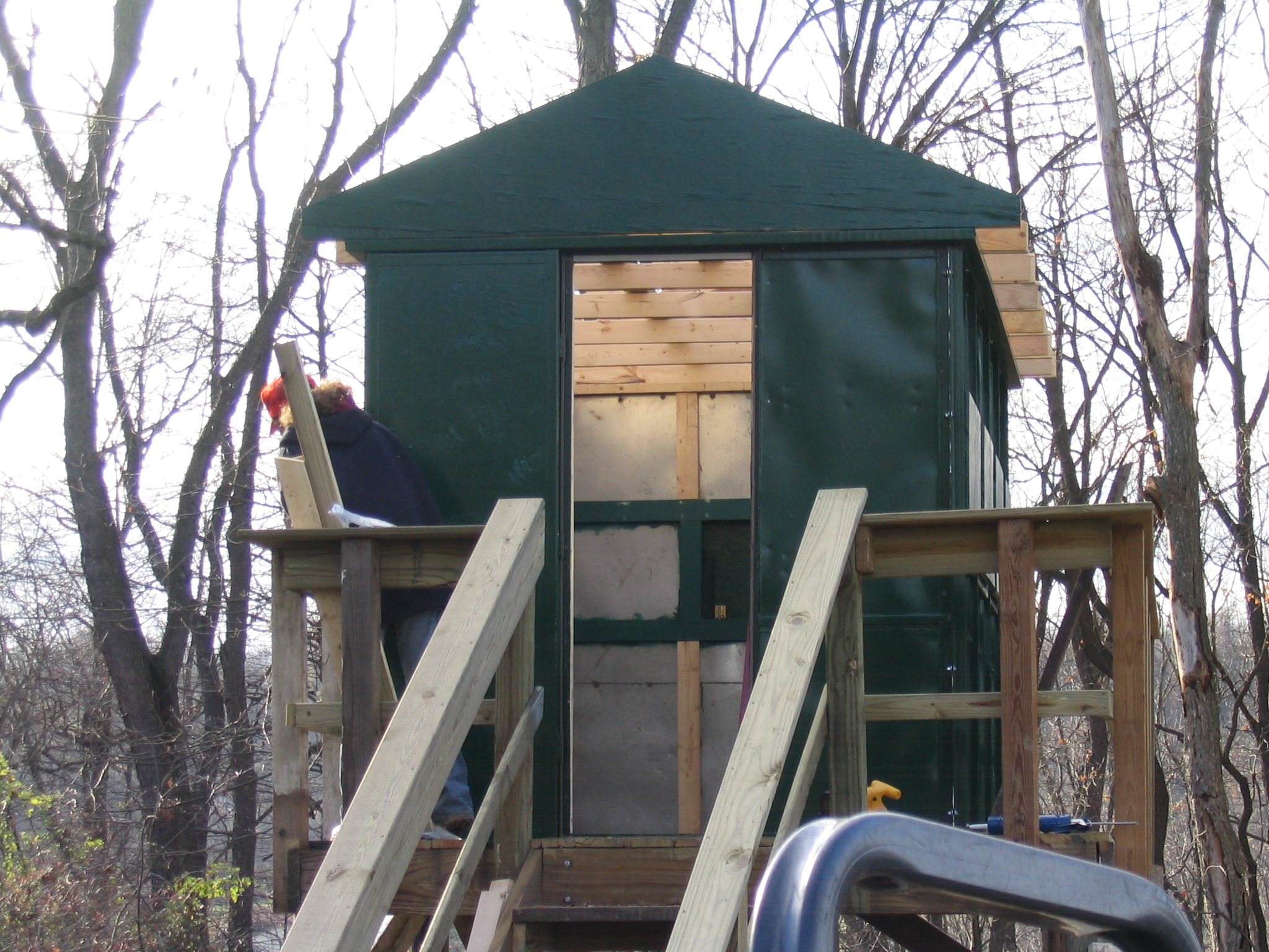

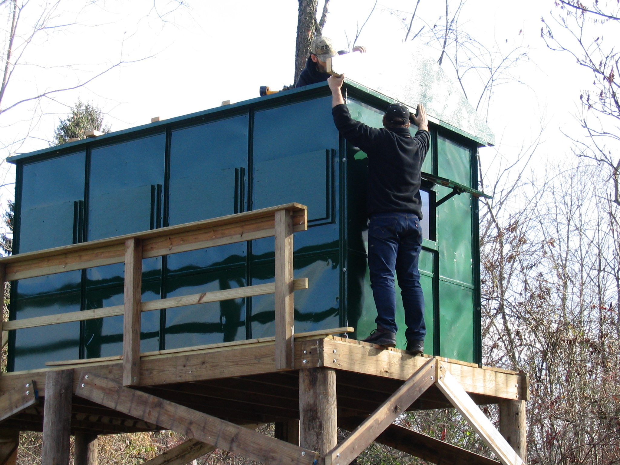

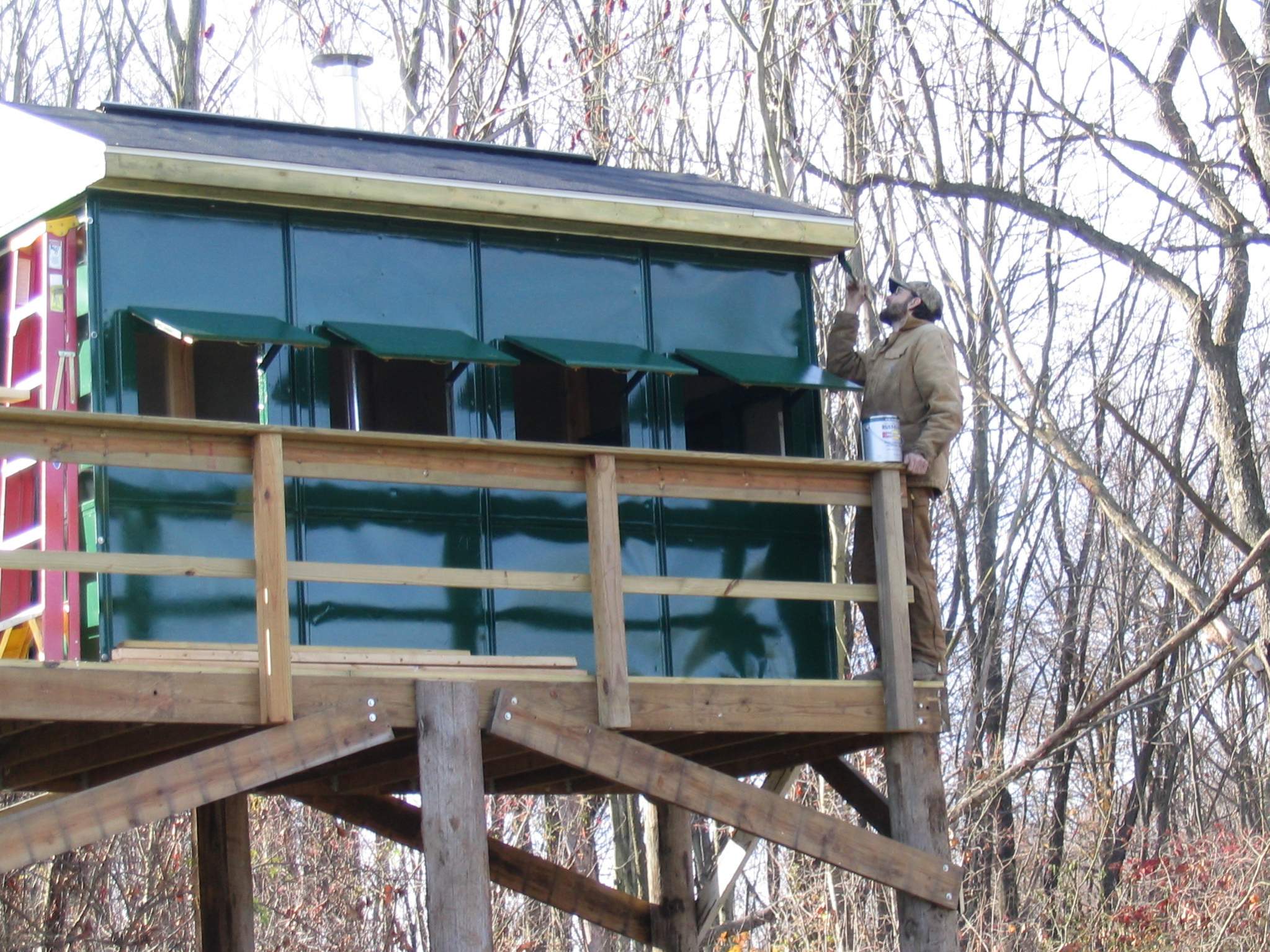

more pics just before roof was sheeted and after roof was done. also trying to get the stuff that needed painted before winter. this was in october and hunting season started monday after thanksgiving. we still had the inside to finish.

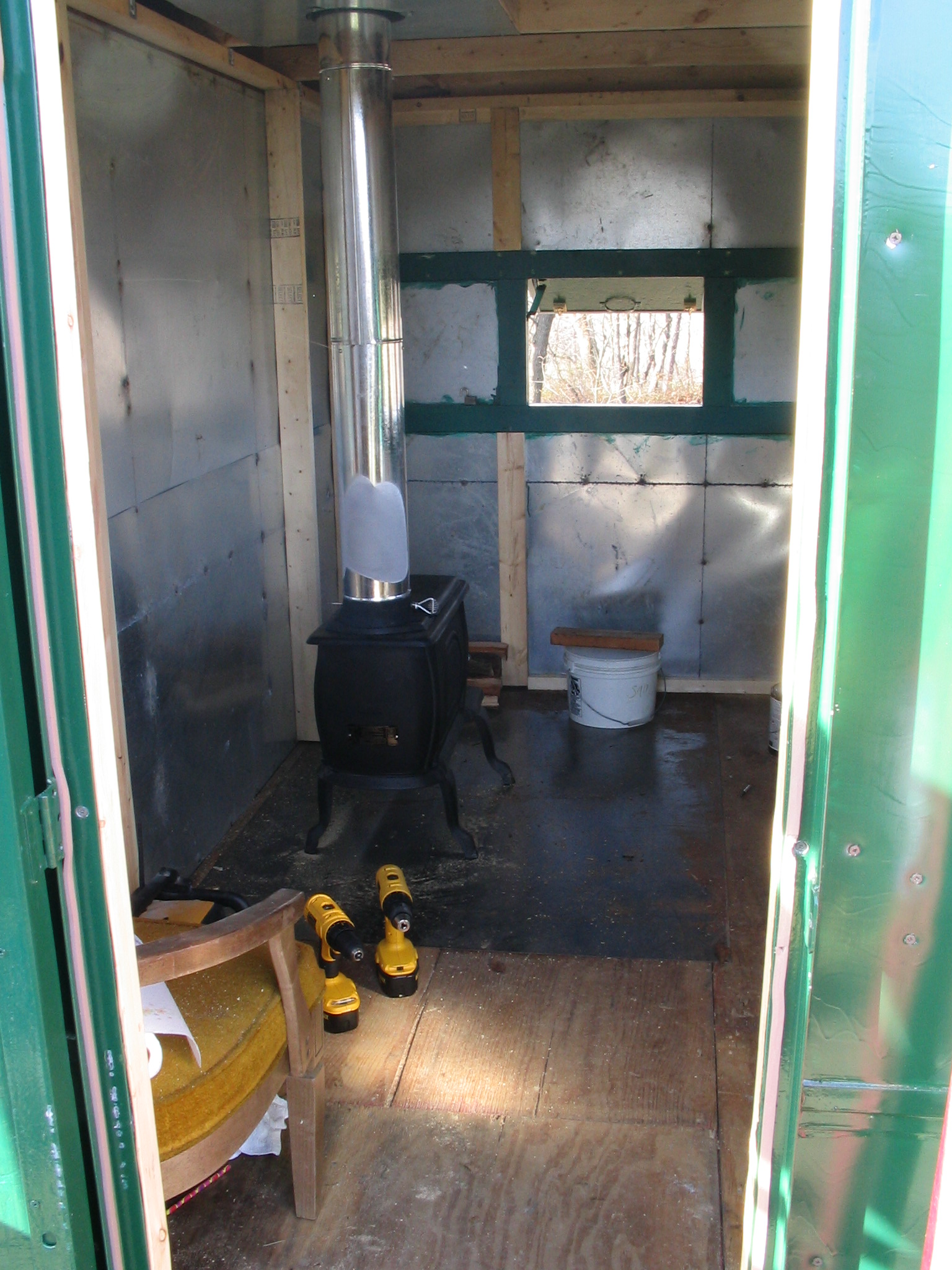

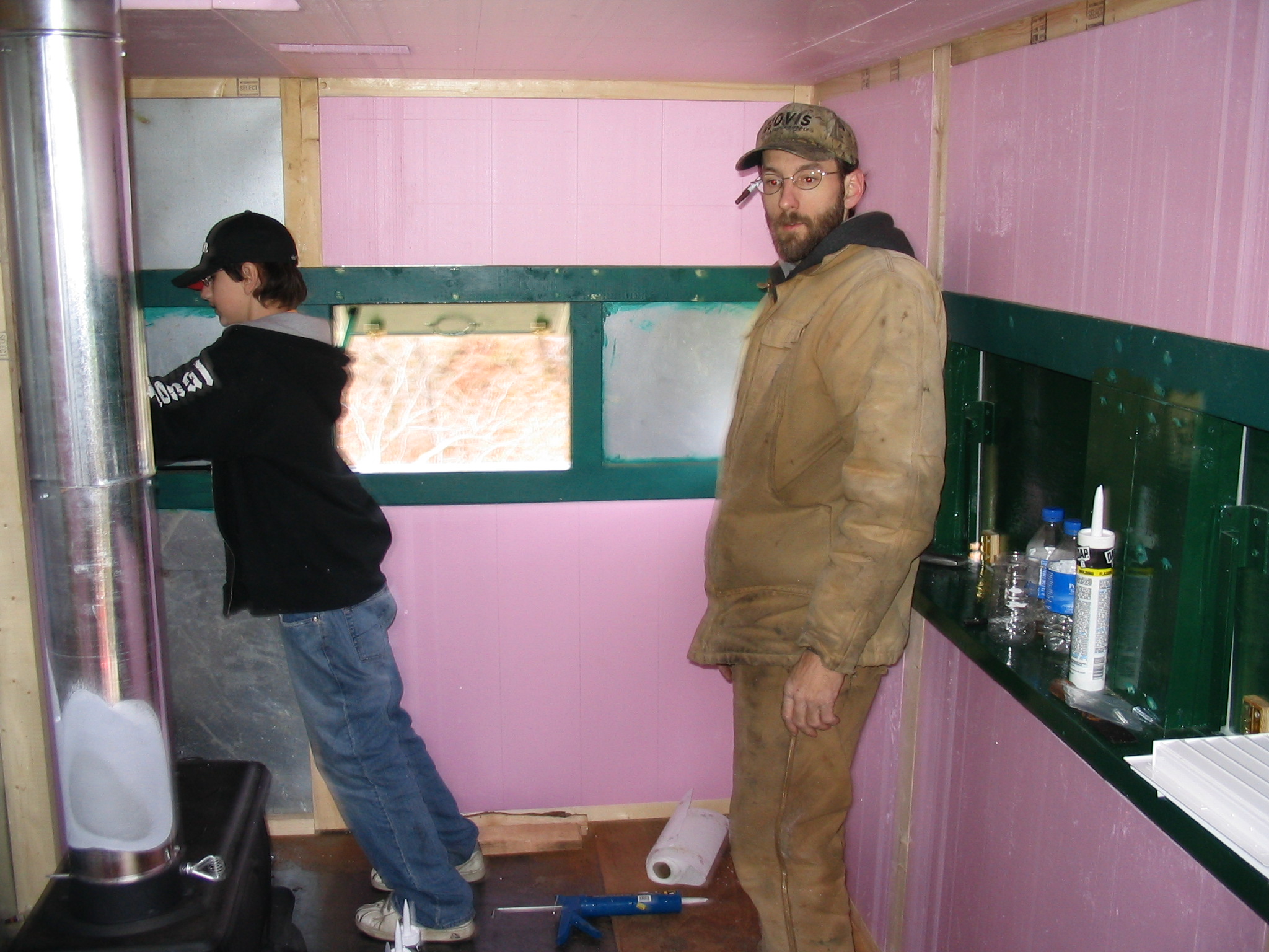

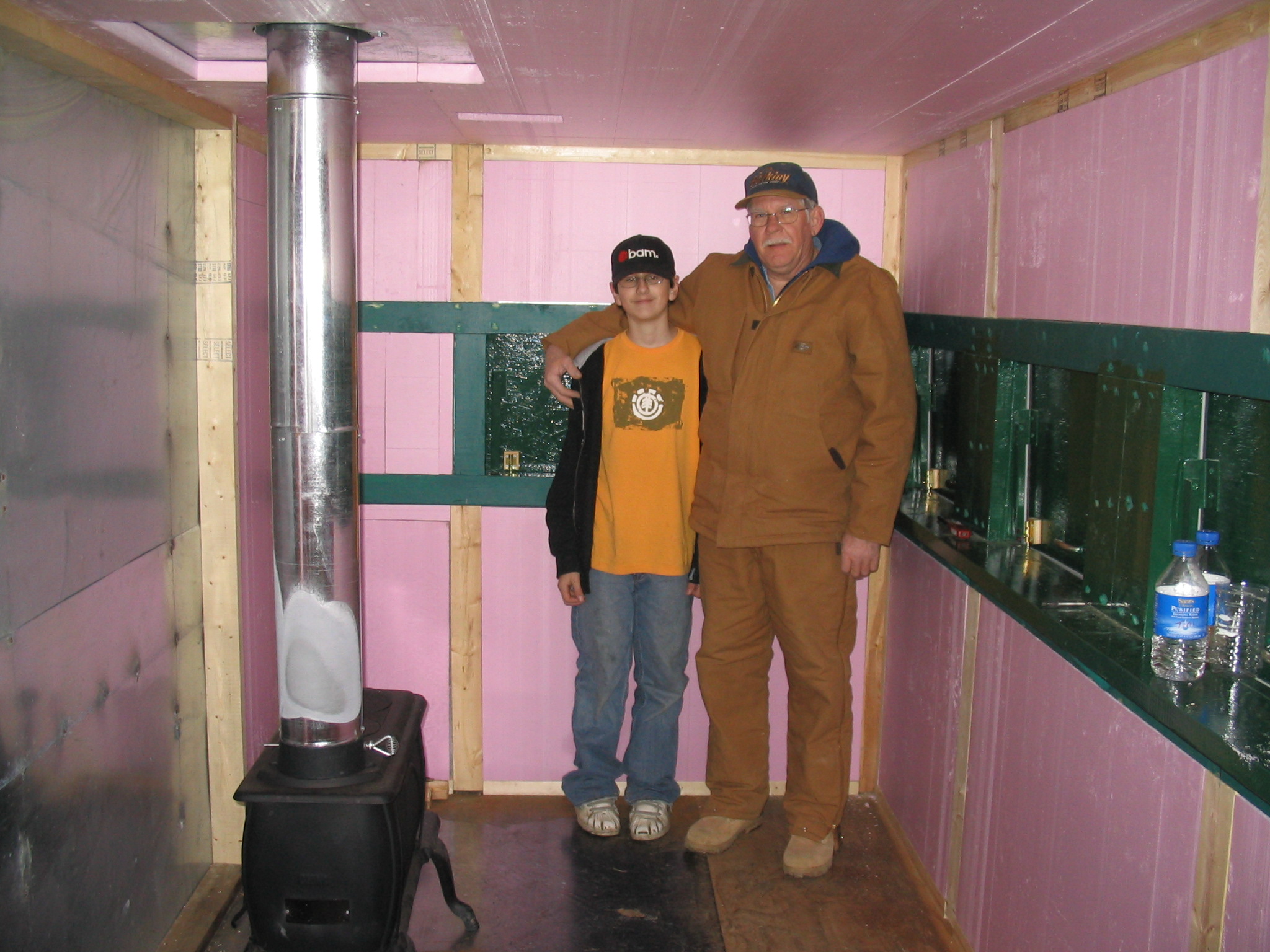

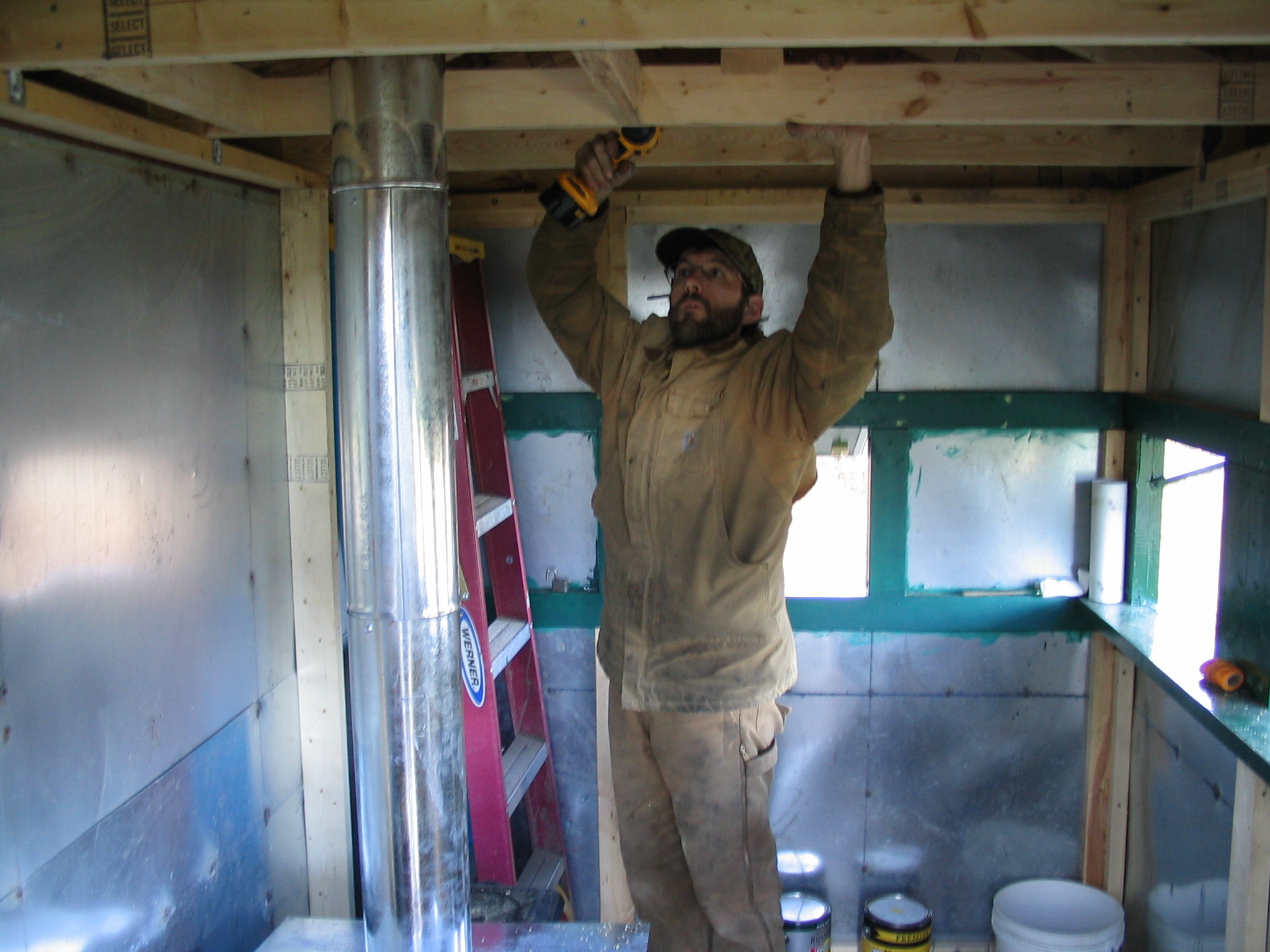

first pic with the wood stove in. i place a sheet of steel on the floor under the stove just for fire reasons. don't want to burn the floor. second pic i was boxing in rafters around stove pipe for the heat sheild. third pic we were installing the insulation using liquid nails to hold it to the sheetmetal. the larger area behind the stove i used fiberglass insulation without paper and cover that area of wall with the sheetmetal that was leftover from the roof of the shipping crate. i think with the wood stove being so close to the wall in this area that the styrofoam would melt in the wall. last pic is of my helpers, my dad and my son.

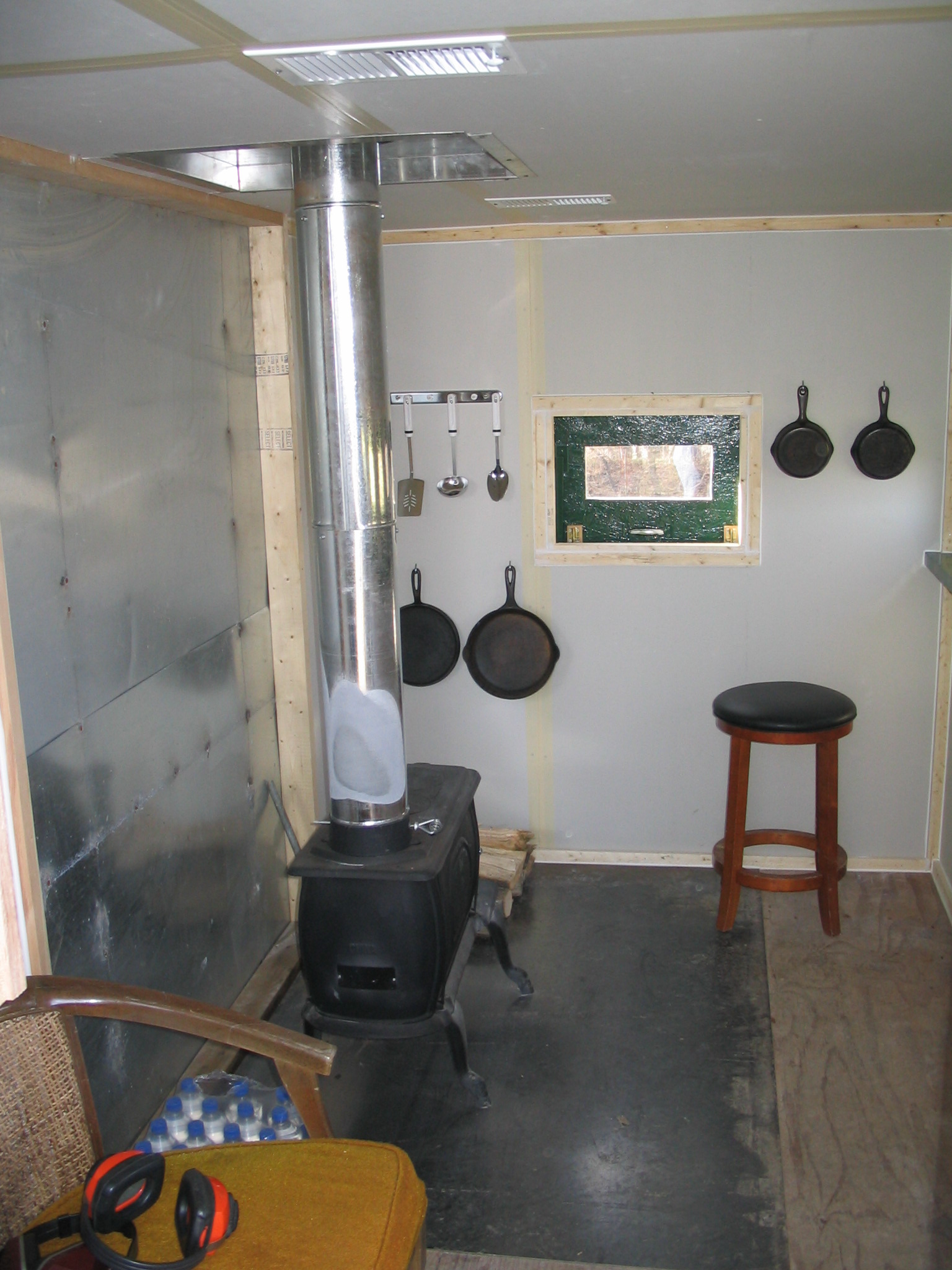

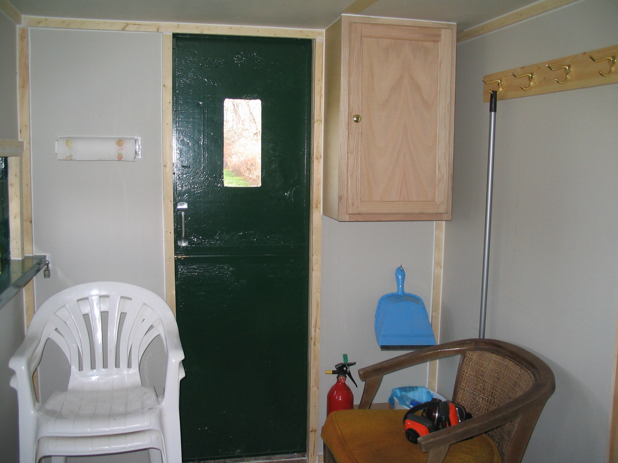

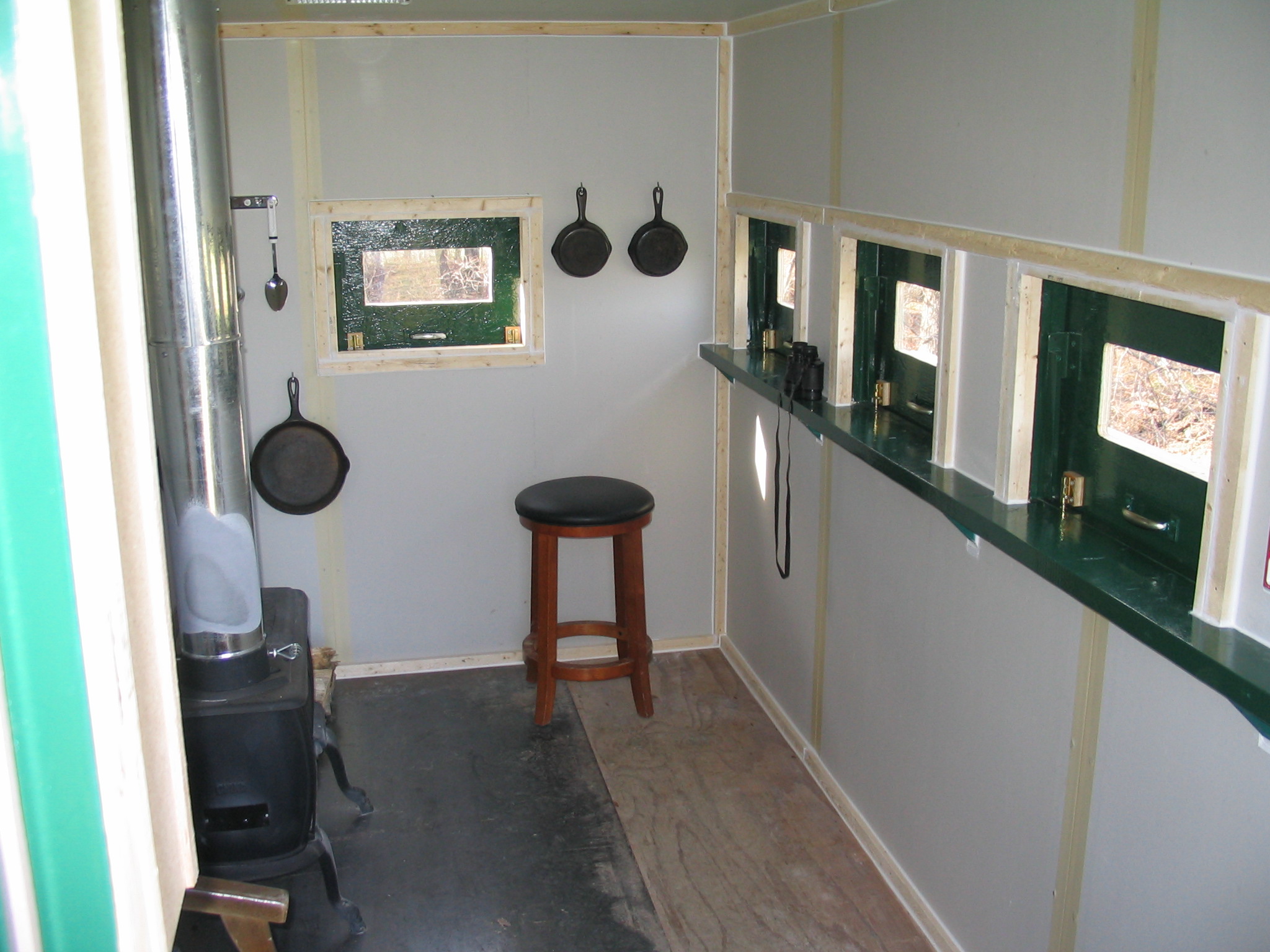

this three pics show after drywall and trim is done. also put in plexiglass windows. pic two you can see the heat sheild in the ceiling for stove pipe. third pic i had to have a cabinet for the kids snacks.
