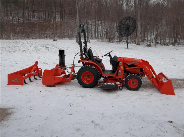

*snip* I also had them replace the dynamo with the 40A alternator.
I went with the fel, 60" mm drive over mower, *snipView attachment 349260
WHOA! Hold the Fort! (Whatever that means--LOL).
I thought a "drive-over mower" was a J.D. thing only, or at least not a Kubota thing.
Can it be?
If so, I guess we still have to wrestle with the aditional, MM-PTO shaft, after the driver-over operation?
Please elaborate.
Thanks in advance.
