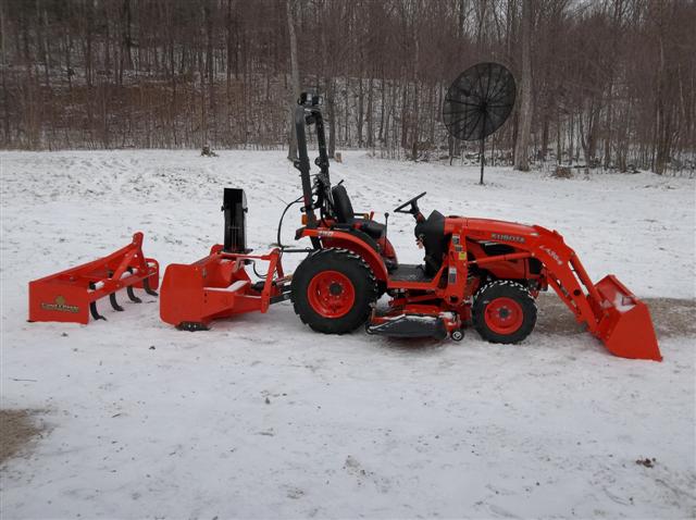

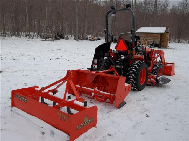

I like my new B2620. If you go with one Dochokin, I had the dealer add rear remote with control lever and front and rear work lights. I also had them replace the dynamo with the 40A alternator.
I went with the fel, 60" mm drive over mower, 51" rear Kubota blower with hydraulic chute rotation and a 60" Land Pride box blade.
Will be adding a Weber-Lane Super-Tilt hydraulic dumping trailer, a Wallenstein BXM32 chipper/shredder and a Lucknow 50" gear drive reverse rotation tiller.
Only complaint is Kubota still has some poor quality paint. Not real bad, but I have sen better.101_1358 (Small).jpg
