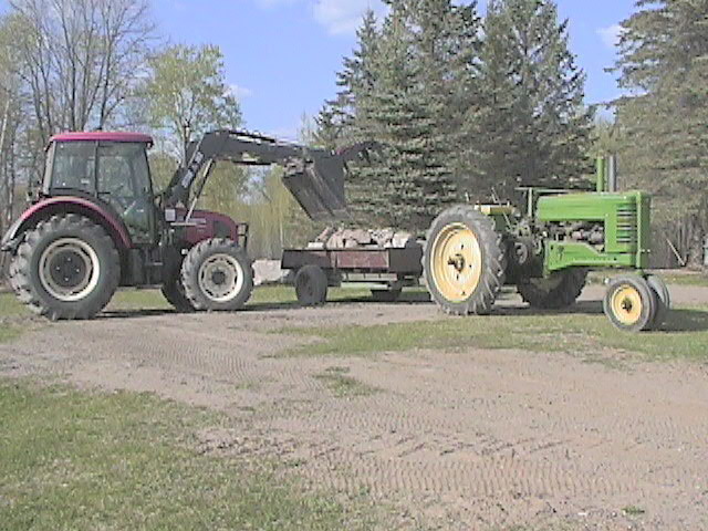

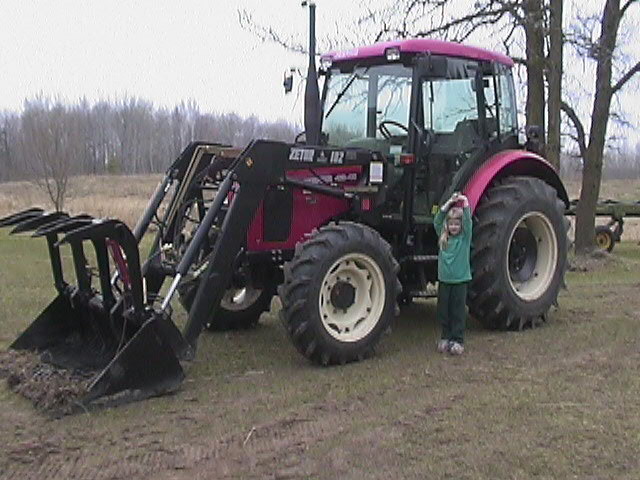

If you get a really small grapple picking up is totaly blind as the tractor nose will block the entire view.
My grapple is 66" wide. I can just see the bucket front corners to dig under & grab stuff.
Grabbing logs by the balance point is not real critical. It is being clamped along five and a half feet of it's length. I've even grabbed a 30' 6" caliper tree by the root ball & carried it up hills & out of the woods - stayed away from sidehills on that one.
Dual grapple arms simply adjust height to whatever is in the bucket. I suppose there is a weight penalty but after 4 years of hard use it's a non issue.
I would be wary of using an ag loader as a dozer. I use my industrial TLB much more aggressively because the loader arms will handle more abuse.
I picked up a small skid steer this year with a 54" bucket that could load a Gator.
