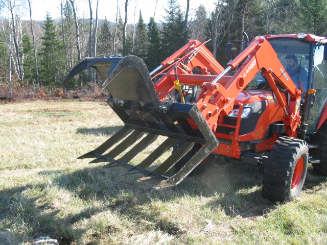

I got my M7040 back from my dealer today after the 50 hour service and it came home with my new attachments:
1) WR Long flat bottom toothbar
2) Wildcat stump grapple
3) Wildcat 48" root grapple
4) Wildcat quick attach to 3 point adaptor
I'll try to attach pictures for the first time, bear with me. The first two pictures are of the 48" root grapple. I used the root grapple for an hour and then the stump grapple for another hour. I'm glad I have both - they each worked better at different tasks.
The root grapple worked great as expected moving a huge pile of brush, although I'm not that efficient at grabbing big loads of brush yet. I also moved a couple dozen sawlogs around very easily by pinching them with the grapple.
I had a harder time popping stumps and rocks with the root grapple. The small stumps I tried would slip through the spacing between the front wedges. I had a much easier time doing this with the stump grapple (pictures to follow in next reply).
Visibility is hindered with this root grapple because of the flat metal plate on the top single grapple compared to more open designs by other manufacturers. However, for the $500 this root grapple cost me, I'll get my value out of it.

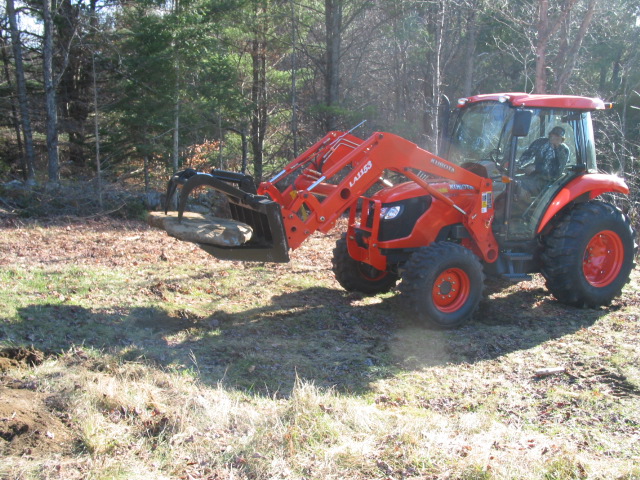

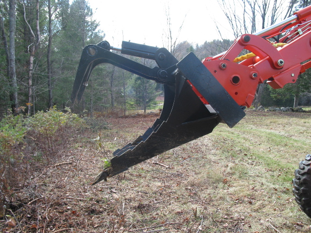

Here is a second set of pictures of the stump grapple in action. I went after a couple of smaller stumps, but failed with some larger ones that my old backhoe would have probably removed. I didn't take the time systematically rip away at the roots on each side, just went right at them. If they went easy then I popped them, otherwise I just moved on to the next one.
Then I went after some rocks and I was very happy with the results. By combining the stump grapple and a forward push from my M7040, I was able to get a couple rocks that had challenged my backhoe before.
My one critique is that it was challenging to pick up large flat rocks because of the upward slope on the sides of the stump grapple bucket. The large flat rocks kept slipping forward until I had them tilted enough to create some resistence in the ground to get them into the back of the bucket.
For the $600 I paid for this one, it will be my dedicated rock popper. When I need to remove a lot of stumps, I'll still hire an excavator. Stump popping is one of the hardest tasks to put a tractor through.
