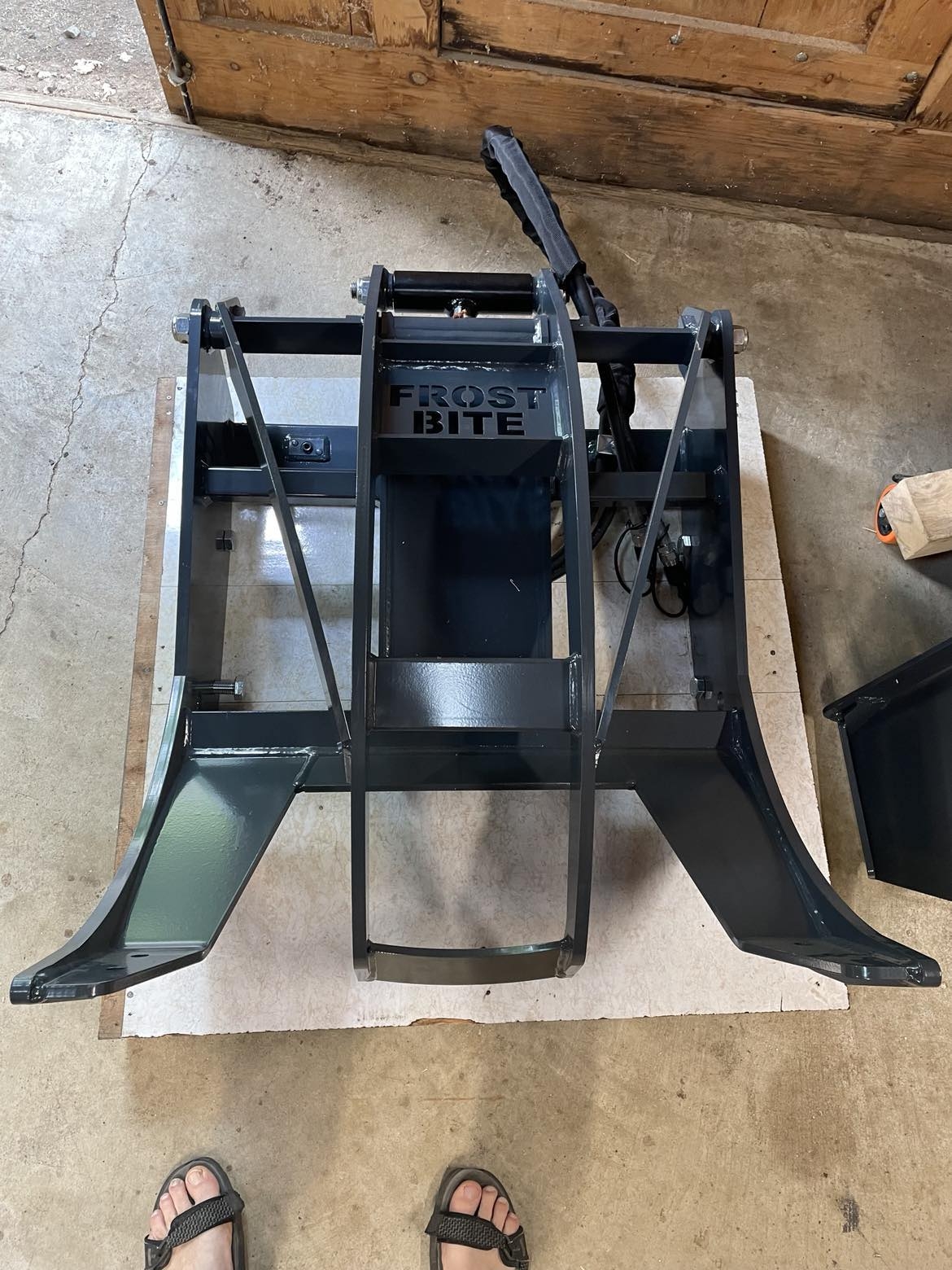

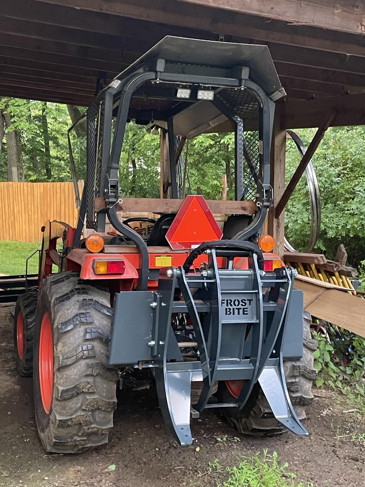

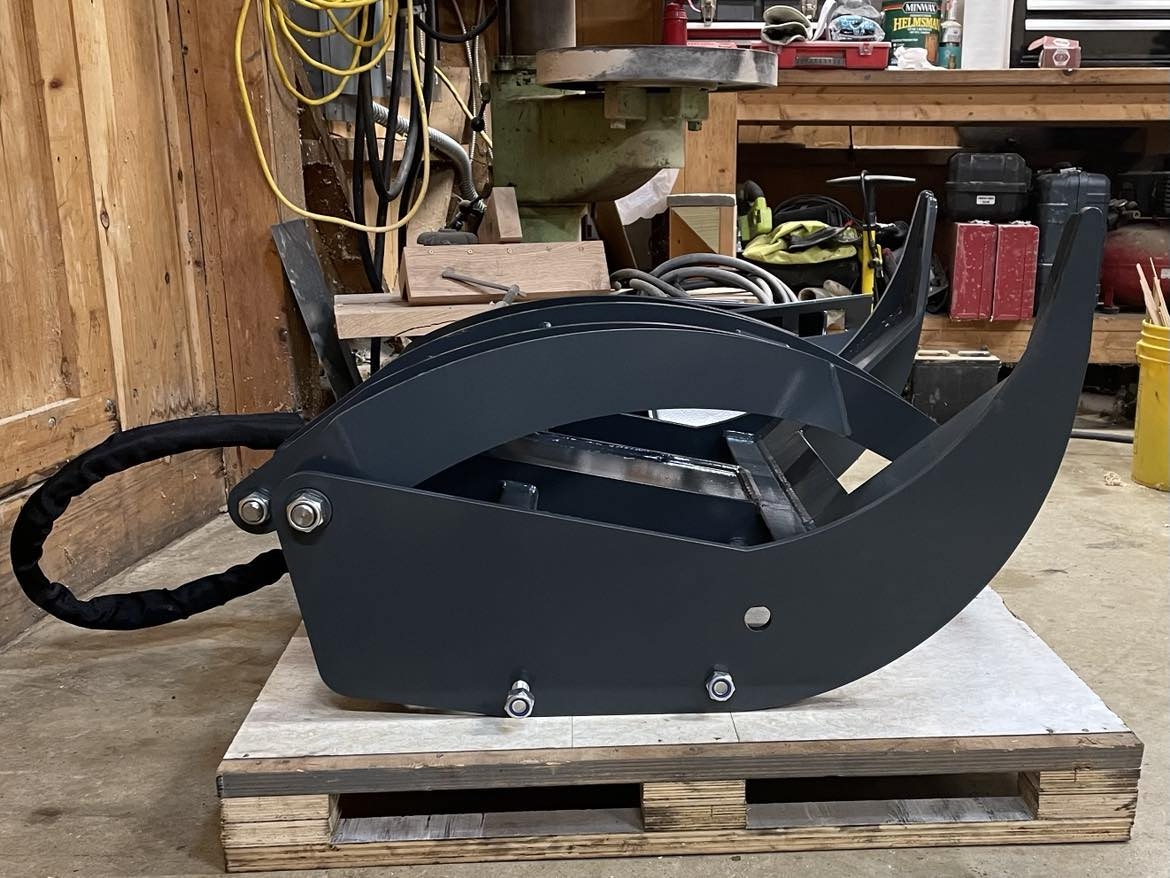

I realize this is an old thread... but I finally pulled the trigger on a Frostbite! I bought it through FrostBite Grapples - Grapple, Log Grapple and Todd was very responsive and answered all my questions. Delivery was quick about 1 week and everything looks to be as requested. I can give a positive recommendation for Todd and frostbitegrapple.com
One thing I like on the Frostbite is that the hoses are threaded so you can change to different couplers in the future if you like. Unit looks very, very strong. I doubt there is any possible way I can hurt it with my little 45hp tractor. And at under 400 pounds, plenty light for my 2700+ pound full height lift.
I still need to get hoses to run it on the loader. I'll throw it on the 3pt to see how it works once I can get away from work for a bit (have an SSQA on the 3pt too)

Sorry, no pics doing actual work. All I've done is take it off the pallet, put it on the back of the tractor and made sure that it worked. I'm in the process of ordering hoses so I can put it on the front. I'll share more when that process is done. Everything was greased and it functioned as it should.

Hey - gladehound. Thanks for the final followup and pic. That looks to be a fine working implement. Enjoy.
