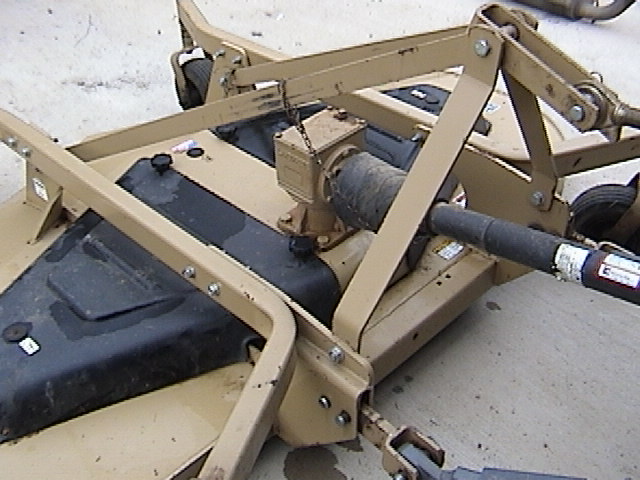

Mower for you. $1,500
RedDog

I have a LandPride FDR2572, same as RedDog's, and I'm verry happy with it. It's compatible with my iMatch but you have to purchase the LandPride Floating Top Link Kit for about $30. Woods also makes a nice Quick Hitch Kit for their mowers but it costs around $130. I think the Woods kit would fit other mowers besides Woods, such as LandPride.
I would recommend the anti-scalping roller option for the 72" deck.
