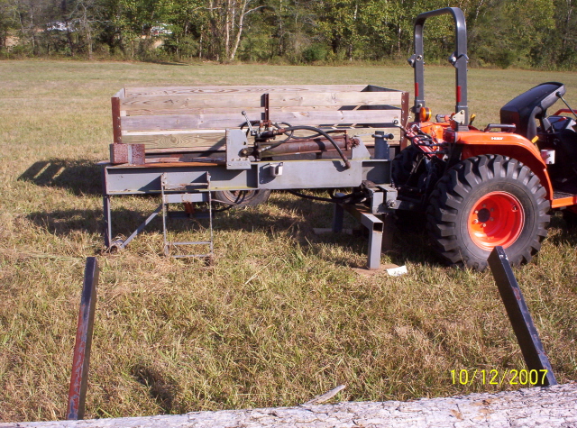

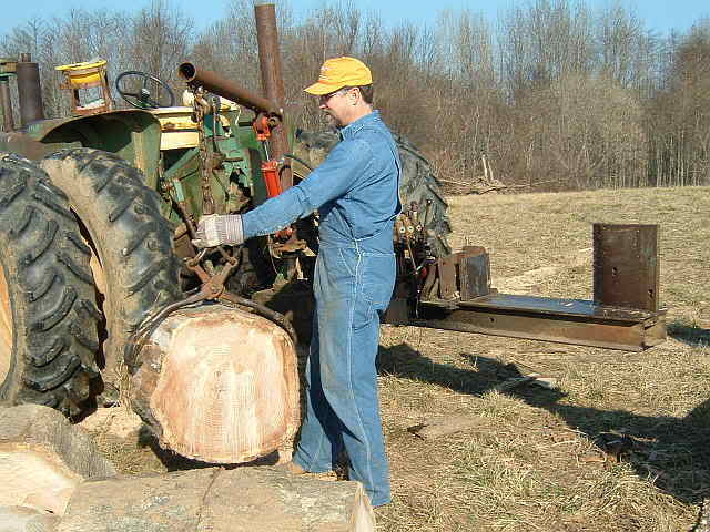

This is mine. I drive a cross pump with a chain and jackshaft then to the PTO. Pump stays with splitter and the tank I use the H beam.

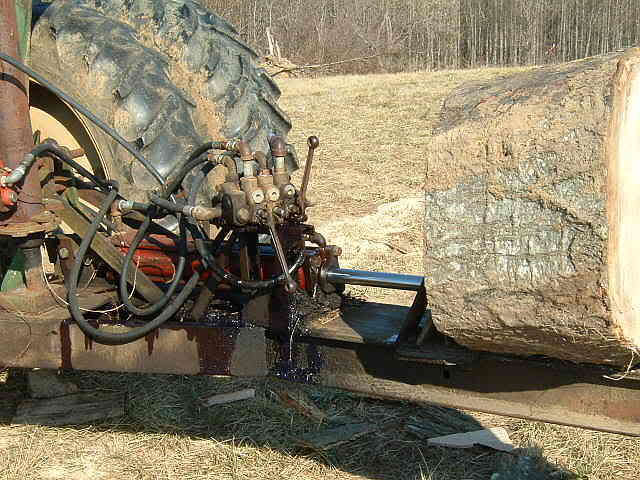

I really can't comment on Wolf Ridge, I've never seen anything they have built...
As for my TW3HD, I'm pretty sure I could buy one today for 3500 including the table grate... (NOT the 36" model)
As to My TW, I run everything through the 4-way, it's one tough splitter and one tough 4-way... well worth what I paid for it.
Normally I do put a block of wood under the splitter when I'm splitting, not because the splitter moves around, but just to take the weight off the 3 point. My little Deutz was built back in the 60's, no need to put extra strain on the 3 point.
I also have a small AGCO I sometimes put the splitter on, it's a much newer tractor so I don't worry too much about the 3 point on it. It's a 45 pto hp tractor and I just like the way it purrs so nicely with the splitter on it. VERY fuel efficient and a joy to run...
I have some OLD tractors too, so old they don't have 3 point hitches. One of these days I'm going to "rig" up a way to use them with my TW too, just to get some run time on them.
For how "I" use my splitter, there's not much I'd change on it... I see folks giving LOT'S of suggestions, but I bet they don't own a 3 point splitter and after having mine, I wouldn't want those changes on mine. Maybe "they" handle their firewood differently than I do???
Folks do things differently for sure... Like, I'm just amazed that guys will keep dumping/cutting their firewood on the ground, then have to "pick it up" to split it! WHEN, they could cut over/on a wagon/trailer and split right off it! It's just so much easier! I guess "changes" will depend on what and how you plan to use your splitter.
My TW is going to get a real workout soon, I have two BIG tree's all limbed and ready to take the firewood logs out of them. One is a maple, the other is an oak... Here's the oak,
There will be some big rounds out of them...
Anyway, I'd be happy to try to answer any specific questions anyone has...

1. Keep in mind the TW has a one speed pump, so at MAX pressure it's going to take more HP to run it. I think TW recommends 30 and that's what my little Deutz has at the PTO. The up side is, it splits faster because it doesn't "kick/shift down" when you are splitting tough wood. BTW, I've NEVER had a piece of wood come flying off my TW... Not even one, like other splitters I've run. I believe it's because of the way the wedge/4-way is designed.
Yes, on a smaller/lighter tractor if may make the front end light. You may have to build a bolt on box on the front and store all of your tow chains or wheel chains in it. It's nice to have a bumper up there anyway. My tractors don't need any front end weight when the splitter is on them.
2.
3. I put a block of wood under it to take the weight off the 3 point. I put the block in the middle of the beam, NOT on the back or front edge. I'm not sure about legs, they may get in the way when you want the beam on the ground, it's just so easy to put down a couple wood blocks to hold it up when you are splitting or storing it.
4. Long time ago, TW put valves on that had detents for both directions, that stopped years ago. I thought about replacing mine with one, BUT after running my splitter for a while, I decided I didn't want it. It's a safety thing, for me. I'm not the only one that runs my TW and I'm NOT going to take the chance of someone crushing a hand or finger for so little gain.
I split off a trailer or wagon, I don't have to walk or even bend over to get rounds to split, so there's VERY little advantage to have a detent in both direction for me...
I hope this answers your questions...

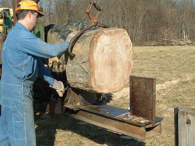

I cut some firewood today and put my TW3HD to work splitting it! Some of the rounds were pretty good sized,
And, The TW easily had the nuts to push those big rounds right through the 4-way,
grabbing the top piece and rolling it back over onto the beam, makes re-splitting them much easier,
Sure glad I had the 4-way, it saved a LOT of time!

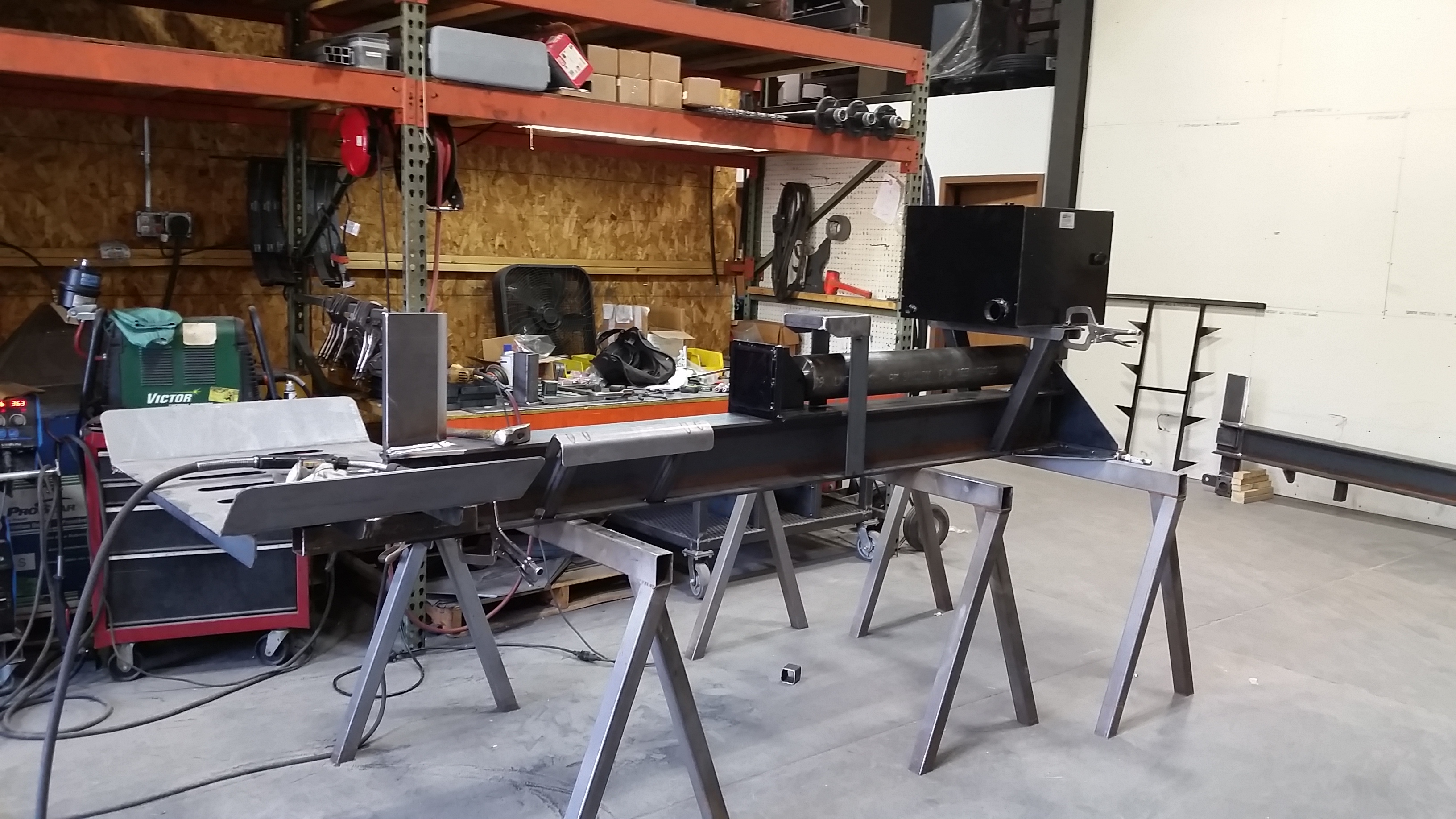

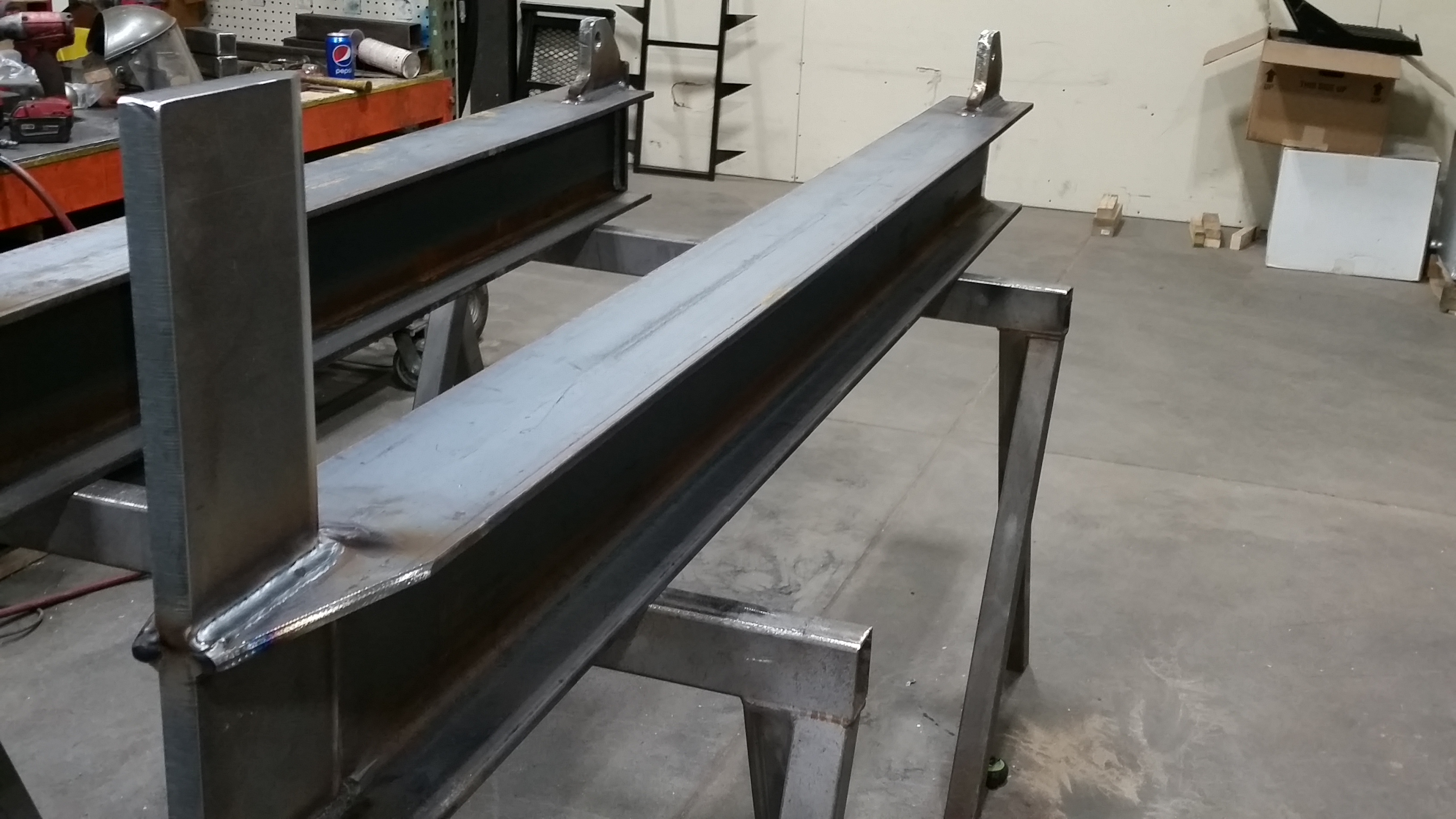

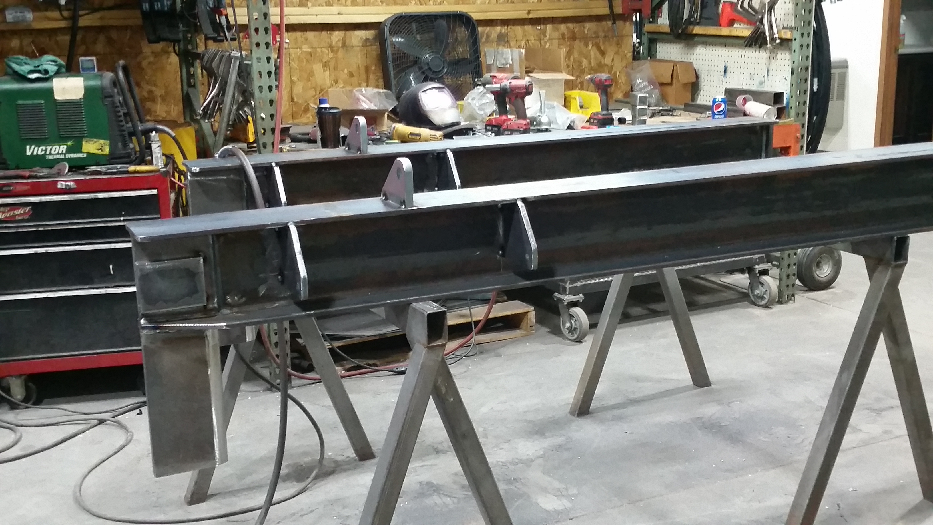

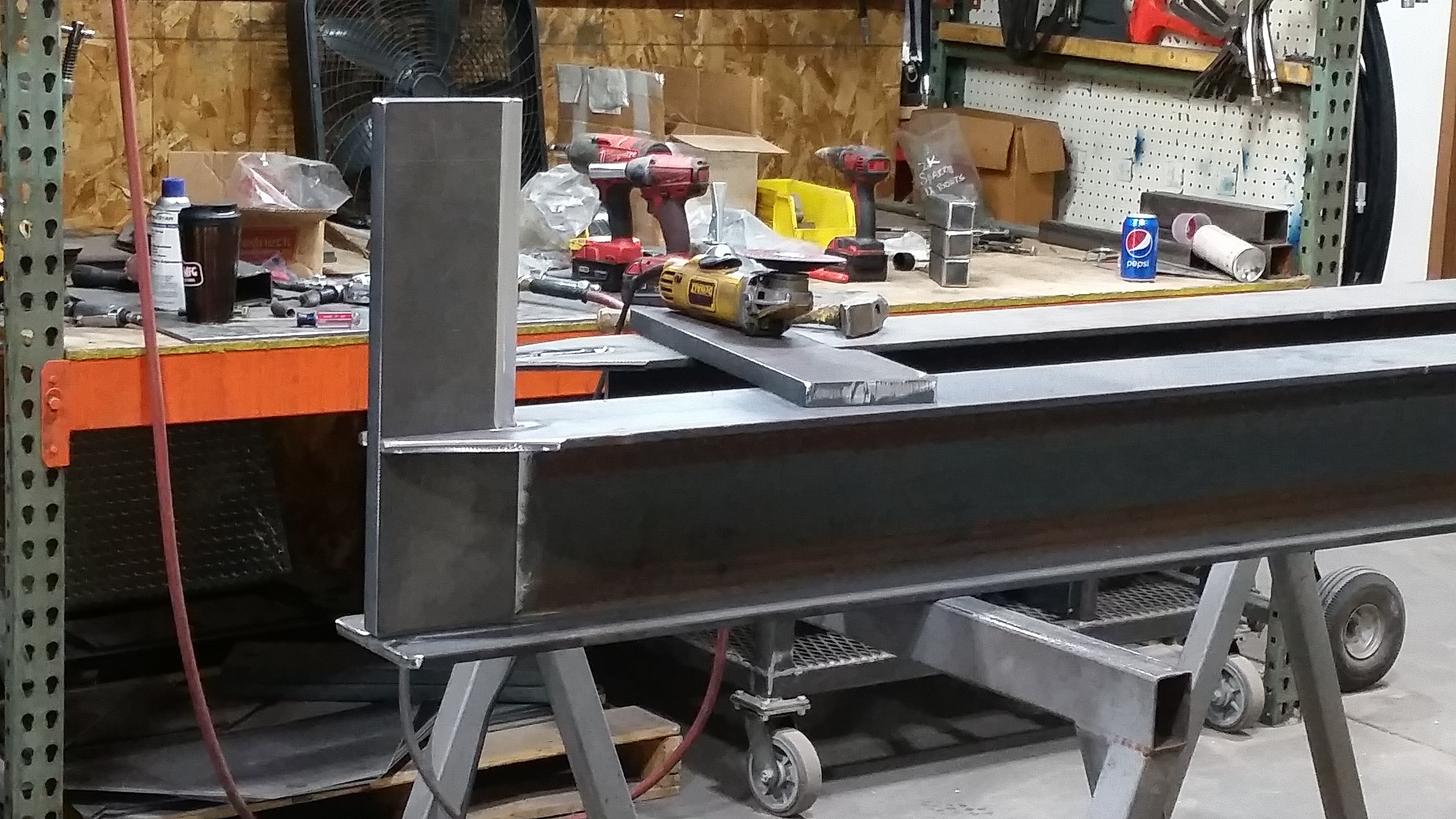

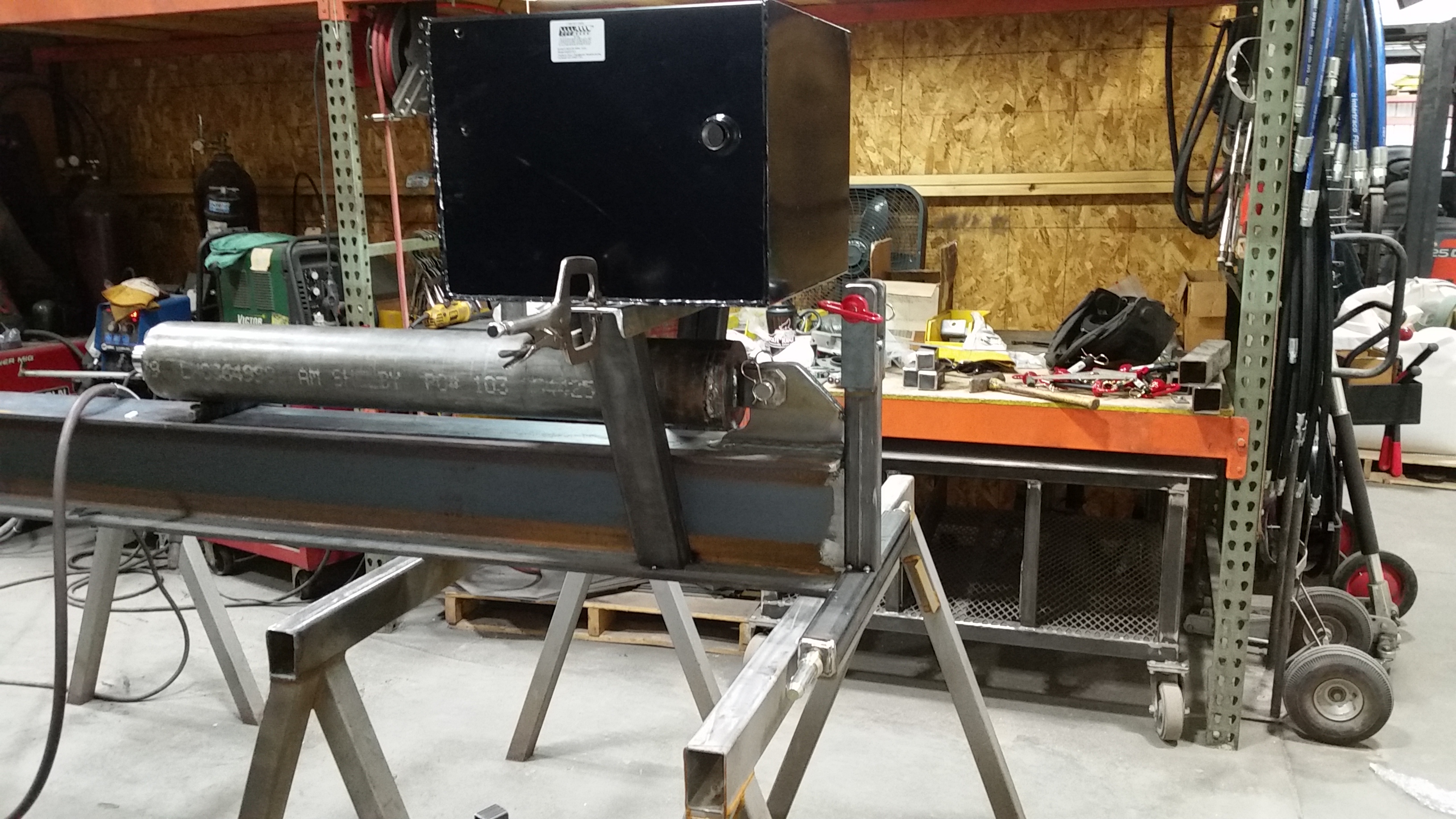

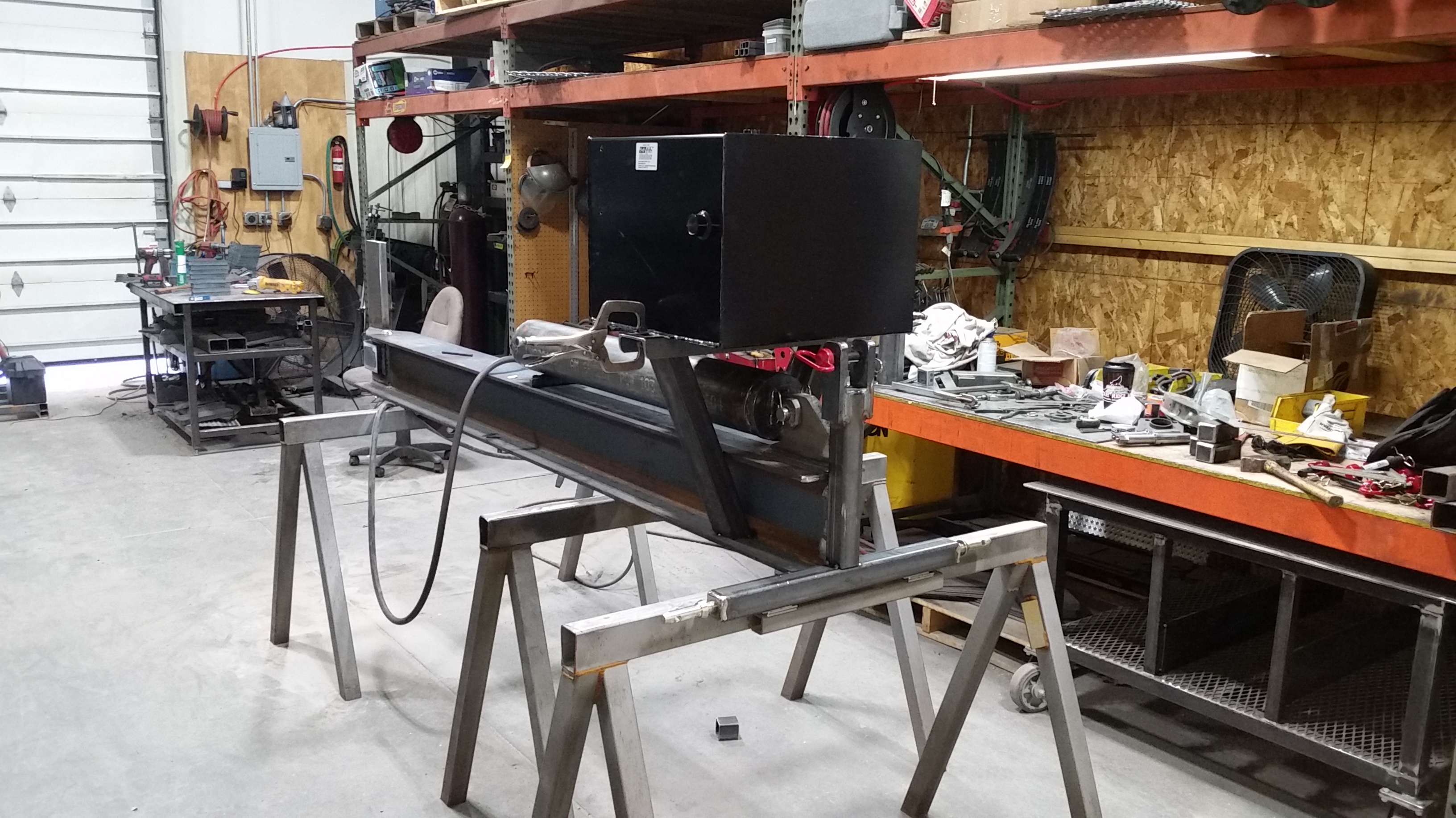

Okay, I got some pictures from the builder. Still waiting on the auto-cycling valve to come in, so it's not ready to test yet. Hopefully it'll be tested by this weekend and finished/powder coated sometime next week.
Here's what I've got so far:
