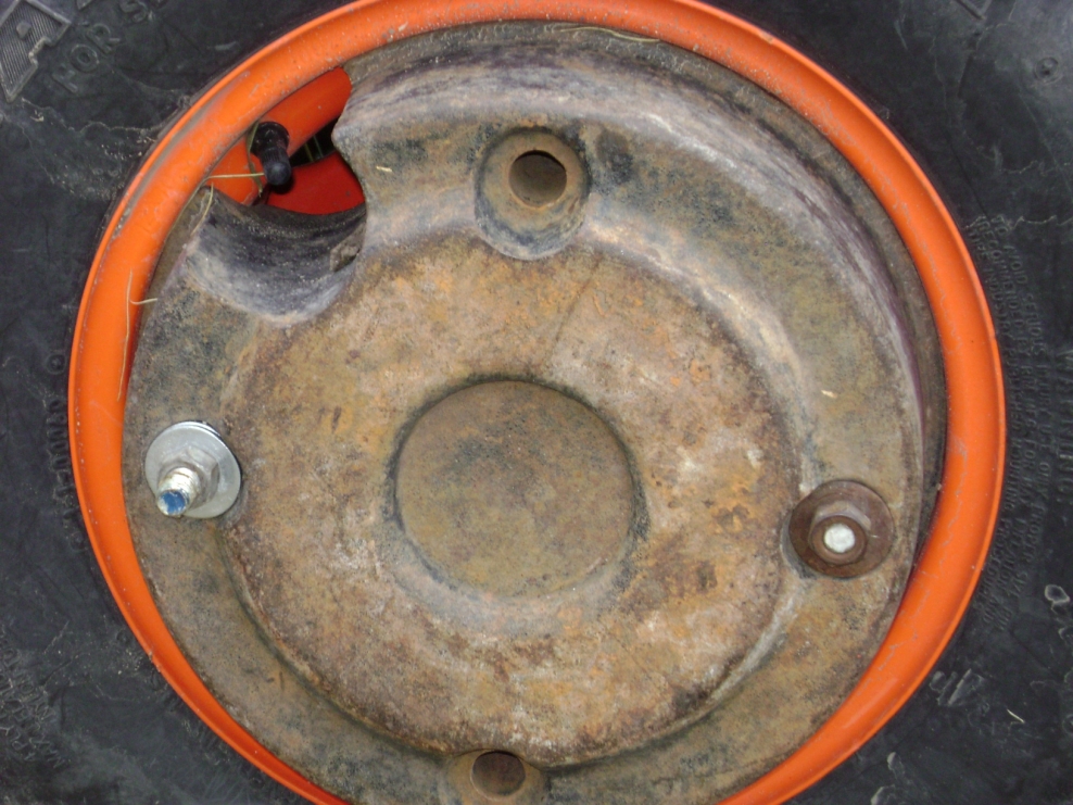

/ Help me design rear wheel weights! #20
Or you could just do what I did I couldn't find any decent weights on the market so I made my own. I simply made a a wooden pattern and then sent it the foundry for casting. These weights sit into the rim all the way to the lug nuts and tip the scales at 225 pounds per side and are supported by the rims themselves so they don't need any fancy grade eight threaded rod , just ordinary 1/2" threaded rod works just fine, that coupled with chains on all fours plus a 225 pound solid block of lead attached to the front bumper give me all of the traction my Bx2350 can handle. And oh yeah I don't much like riding on two wheels so I also have a 700 pound ballast hanging off of the three point for those times when the loader going gets a little ruff.
David
