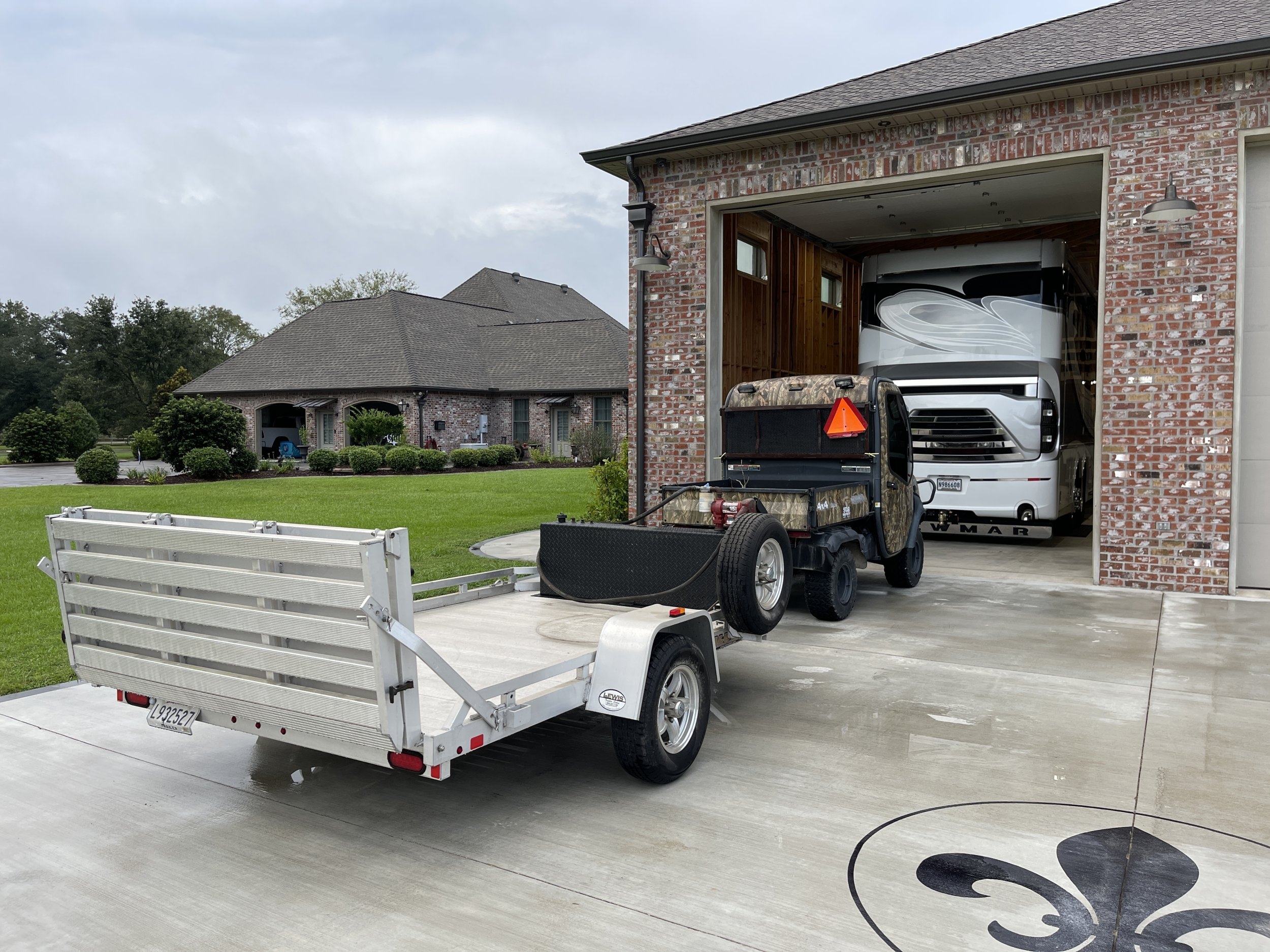

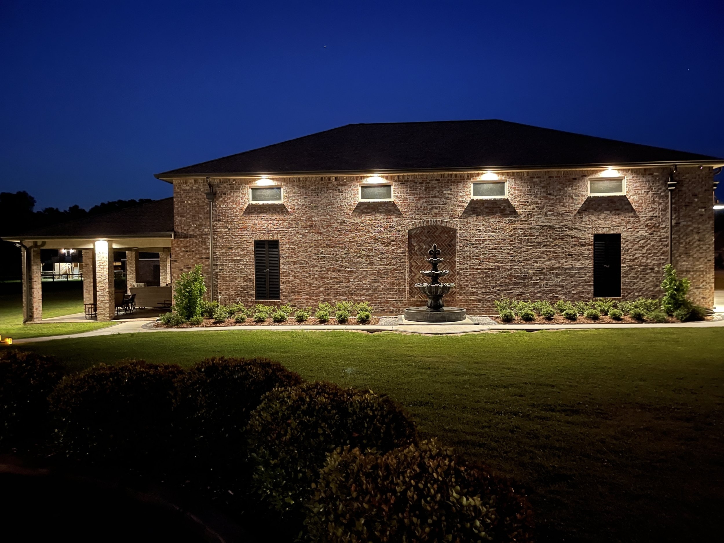

For my shop I went 40x60 and did a pole barn construction. we placed the 6x6 posts into sleeve. No termites or moisture comes in contact with the wood.
Then in 2018 we built a 38 x 78 RV garage and did a stick build as it is next to home and the wife wanted it to match home.
with all the brick work it was about double the cost of a pole barn.

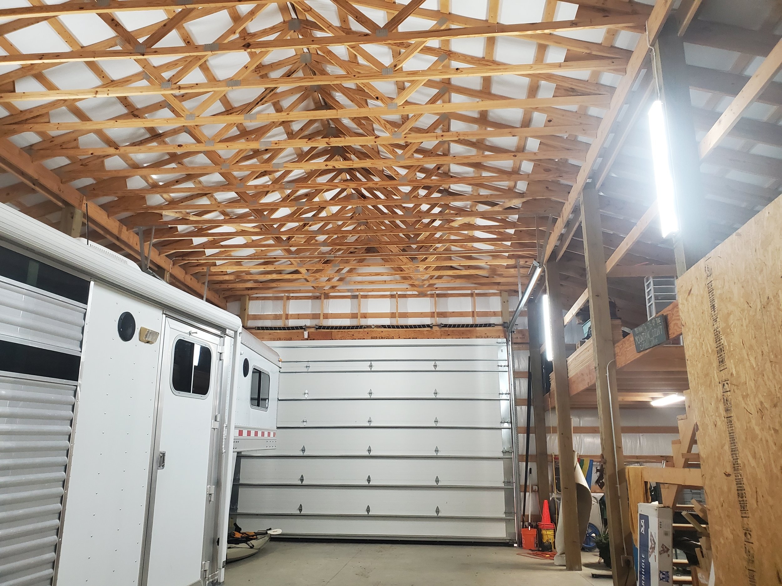

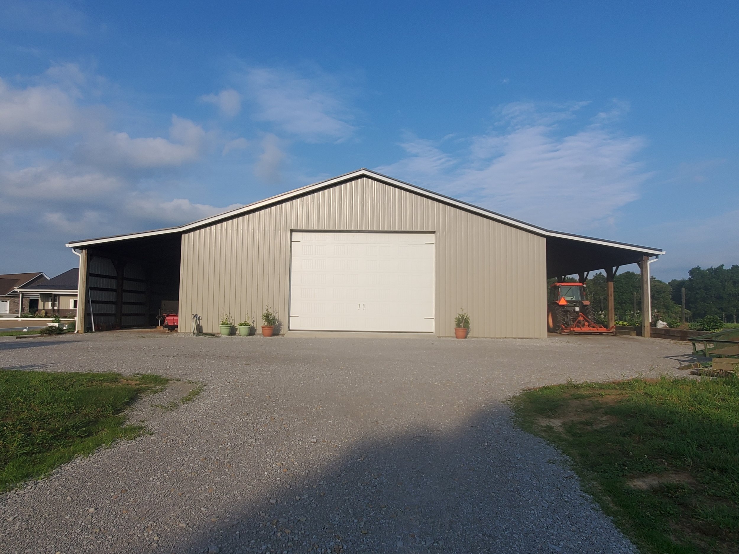

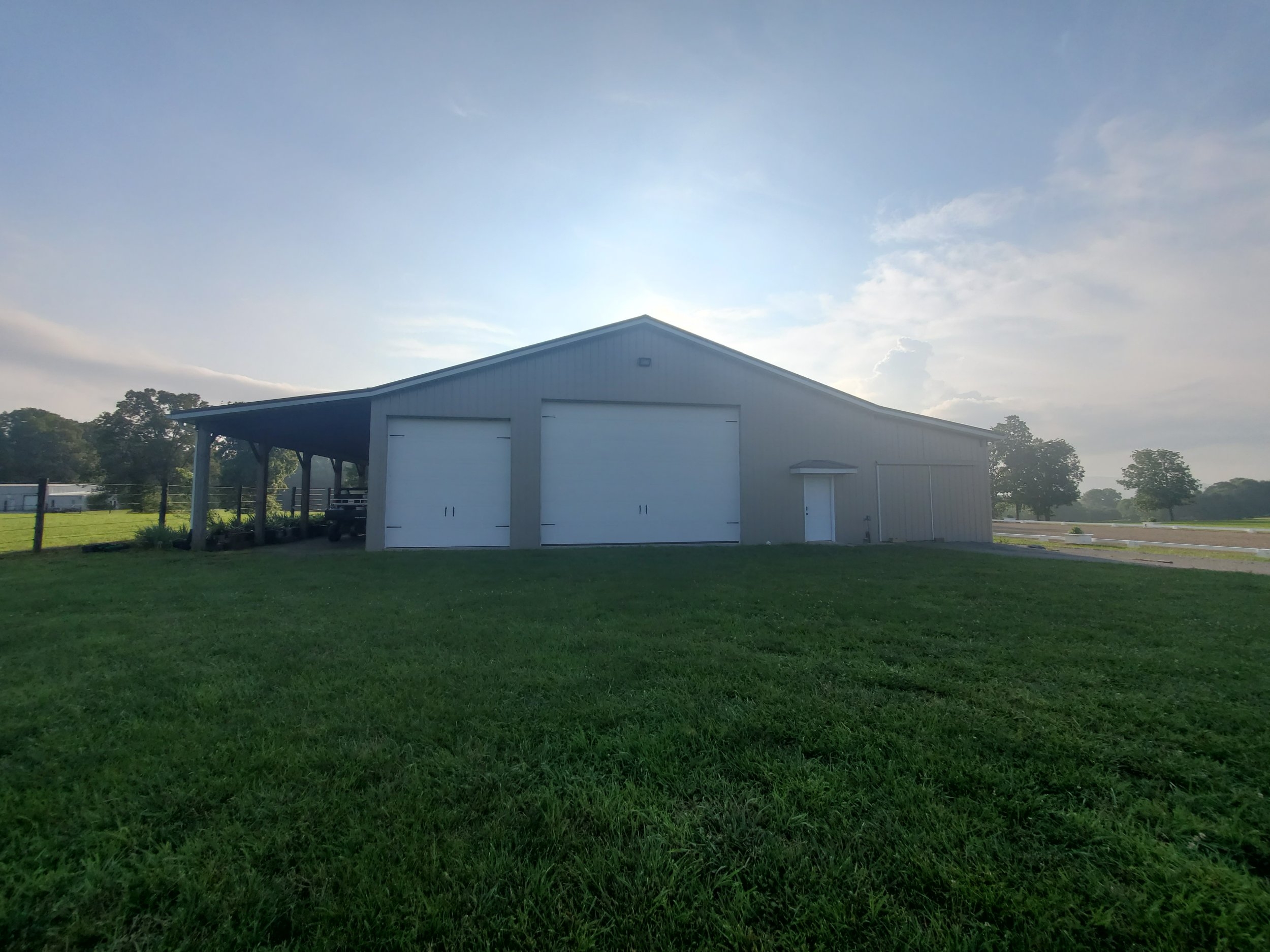

This is a 50x60 with two 14 ft overhangs/sheds. It has 2 - 20' wide by 14' high doors (for drivethrough) and another 12' x 12', and one man door. We just recently built a wall on one end of an overhang to keep hay dry.
The last picture shows how we used trusses on the center aisle and stick built the rest. This let's you use a taller door and saves money or concern of longer trusses. You might also see how we mounted the lights so not hidden when the door is up.
I would recommend overhangs/sheds, that is "cheap space". And building in the "post and beam" style allows you to go in afterwards and "traditional" walls in to divide it as you like. Also, you will never regret insulating or vapor barrier otherwise they can sweat. Also, watch your roof pitch, if your building a new home, you'll want your equipment bldg pitch to match or compliment. It looks awful with a nice house roof and a flat out building.
We have finished off a work shop in this building and have a entertaining room, with bath and kitchen in another building. (last picture).
Just one (wo-) man's input.

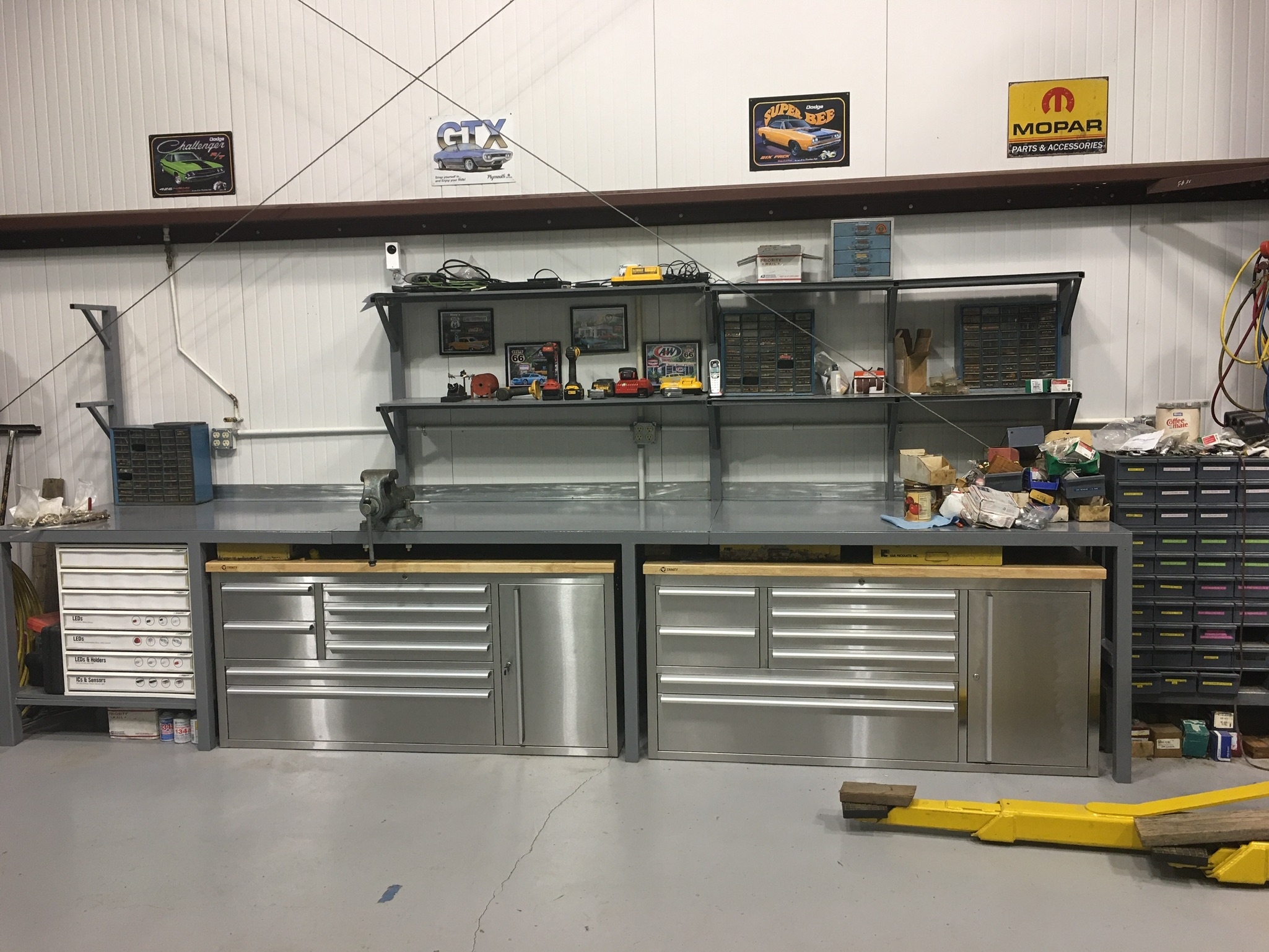

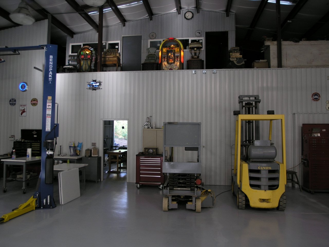

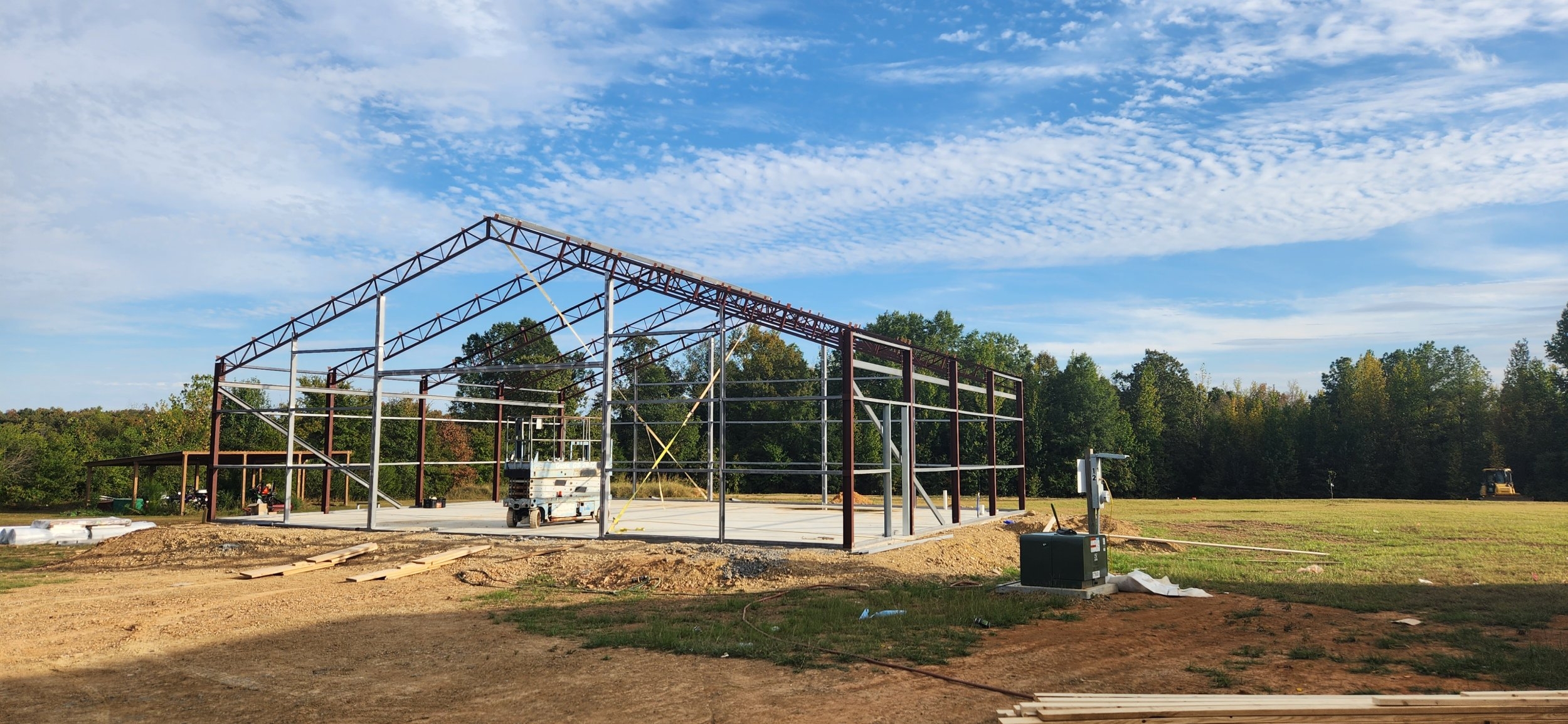

I have been through the house and shop build scenario 4 times. First time I was in my mid twenties. The shop was just a stall incorporated into the house. Not enough height for lift so I did a pit. House was a ranch style 2100 square feet.
From that I learned all the trades and built three more with detached shops. In the last three I built the shop first to give a place to live and for my tools. Subs weren’t used just me and my wife. One was a hangar/shop combo and the all had their own 3 phase meters. The last one was metal framed which is actually pretty cheap as long as you do the labor. Houses and generally 65% labor. Metal shops go up quick and easy. The walls can be simplified by using self insulated panels that are steel on both sides. The panels save a lot of time. I used 4 sub panels 2 in each side of the shop, wood working and automotive/machine. I used conduit for all the power so I could add wires easily in the future. It’s best to have extra panel space for adding circuits. The woodshop only needed a 12’ ceiling so I have a mezzanine above. Walls are 20’ which allowed for my dual two post lift and overhead pedestal mounted crane. Shop ended up being 50 x 130. Then someone came along and said I was supposed to be downsizing at my age! Too late now.
I know you aren’t going for all this but thought maybe you could get a couple pieces of info you could use.

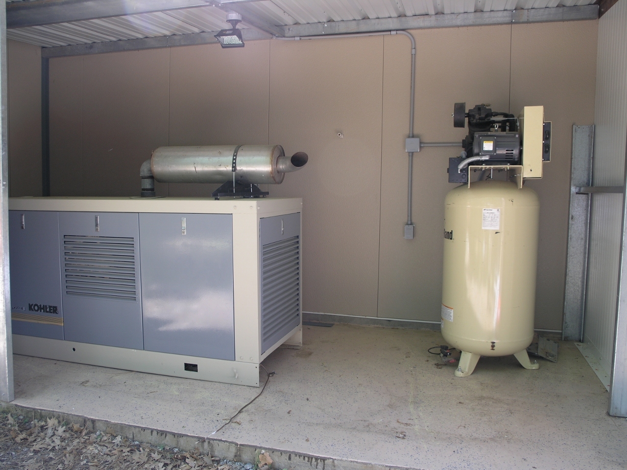

   / Help Me Design/ Build a Shop #60

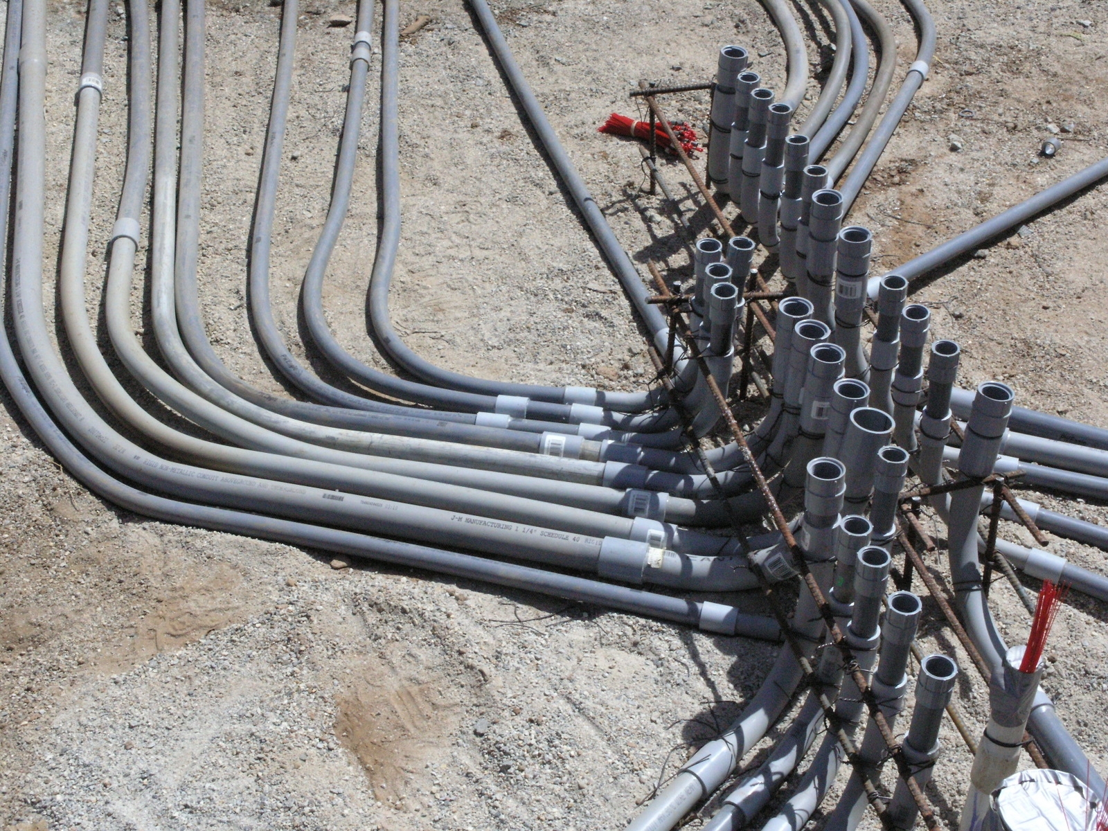

Having been in construction for 45+ years as an electrical contractor I have done design/build for residential and commercial, I have learned that you must think of your electrical needs as you do your well, how much you need depends on how many things you need to do at the same time. Lights and plugs really don't require much especially with the new LED lights. Probably your highest draw will be the HVAC, electric heat or an electric stove. Electricity is the least efficient way to heat anything so you must plan. That HVAC unit and your basic stove will each draw about 50amps, but most uses will be intermittent, Plan ahead and think small and point of use, like window AC, baseboard heaters and a 6 gal electric water htr or on demand small water htr under sink. I ran my 1st house and shop with a hot tub out back on 125amps with never a problem. I have a neighbor with a 30x60 shop with every tool and a lift, he runs on 100 amps. Two more things to consider, most residential panels will only accept a max 100 amp breaker to plug in, so talk to your elec. contractor before he installs it, and last but not least consider permits, here in rural AZ up to 200 sq ft, the county doesn't care, 200-400 they care about WHERE it goes, after that full drawings and engineering, which ain't cheap. Good Luck
