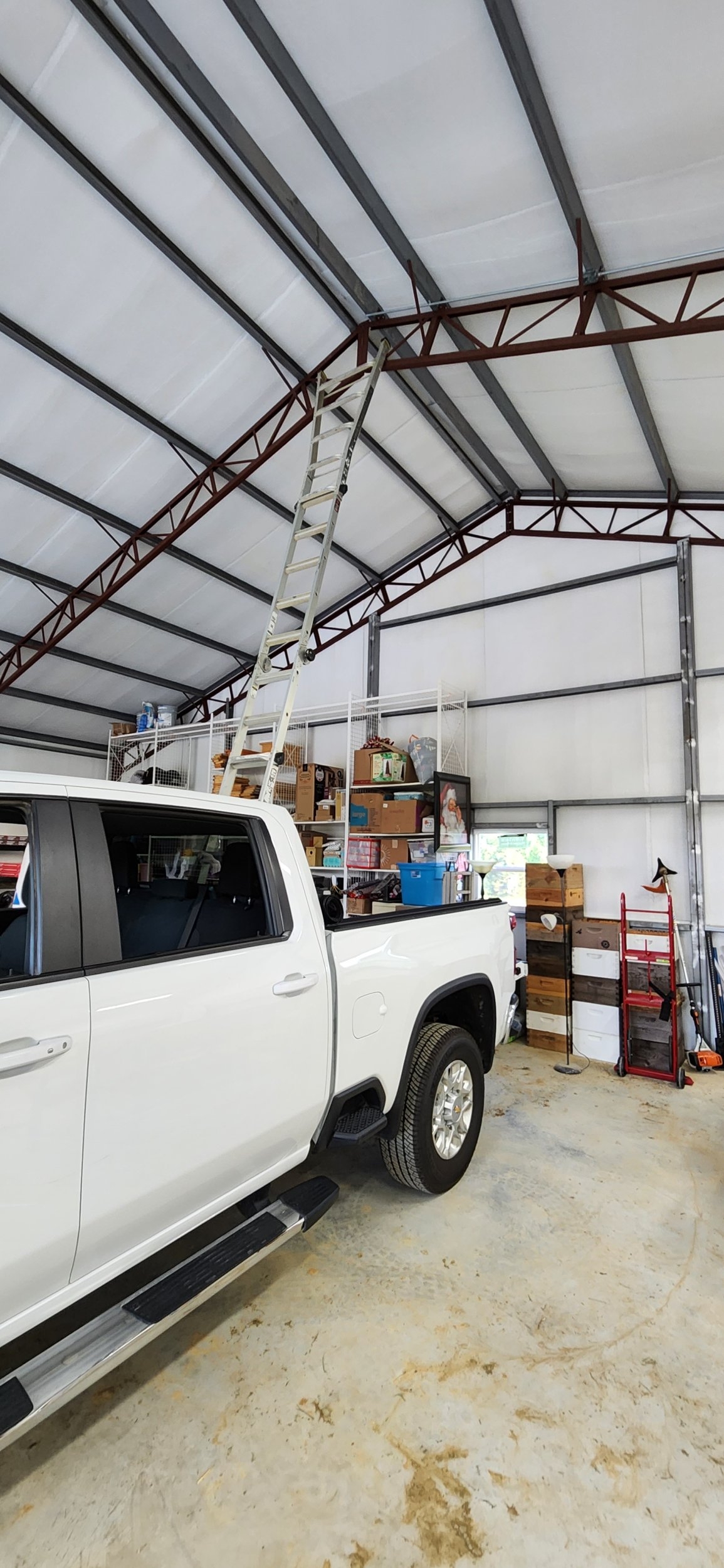

Yeah the ladder was about 2 rungs too short to reach the top, so I backed the truck in and it's tall enough from the bed :). I'm more afraid of heights than I realized. Apparently as you get older that happens? It bounces, is it too vertical, is it going to fall backwards, does it have too much lean, is it going to slide out from under me... ugh. I have no idea why some projects get to where I just decide to do it the hard way on principle.

So... apparently I'm cheap... Or it's the principle at this point... I'm going to do the stupid lights with what I have I guess...
That's a good idea if the ladder is good, stable & strong. I'd tie both top ends of ladder to rafter and it can't go anywhere.
