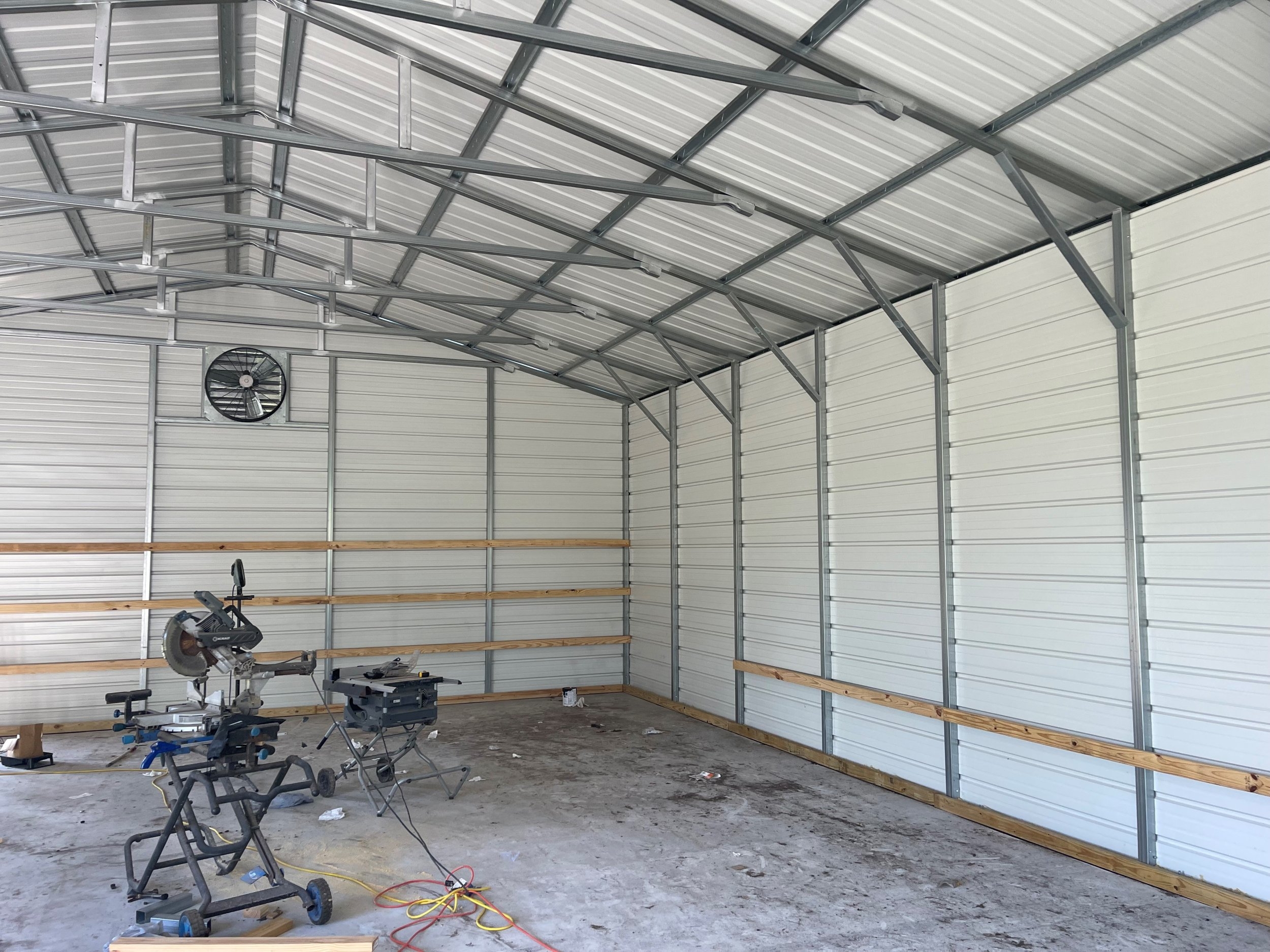

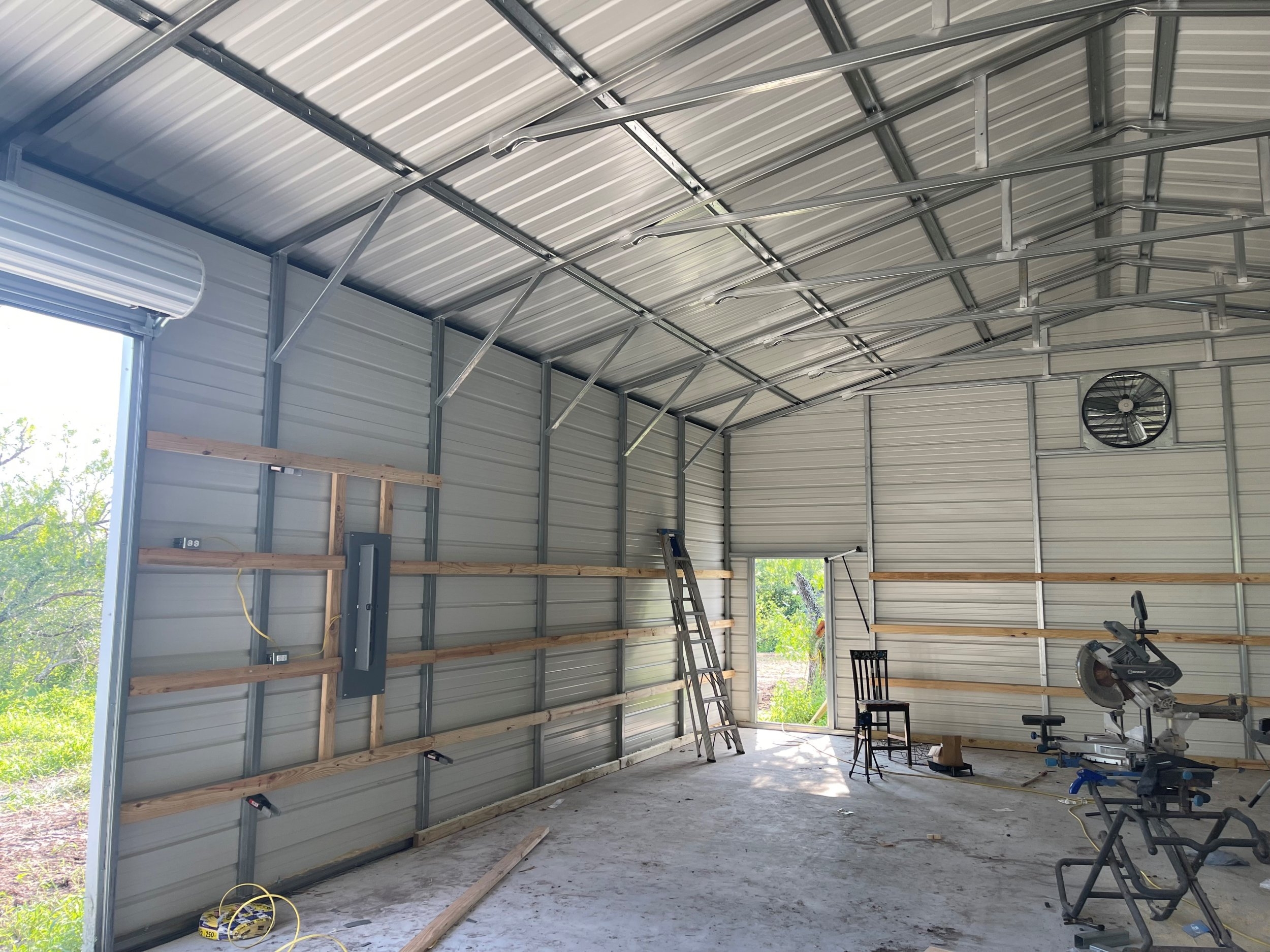

I found that having a company install a 30X60 12 ft eave carport style building with 3 10X10 roll up doors and a man door on a concrete slab was the best option for me, I had a concrete contractor install a 4 - 5" thick slab (5" under the planned 2 post lift) for 12k and the building installed (shell with exterior doors) was 20k. down here pole barn with the posts in the ground is a no go for me.
