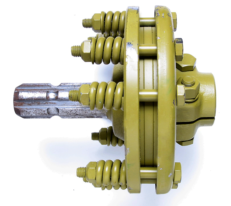

a slip clutch is a device that is designed to allow a shaft to slip or break loose once a given amount of torque is reached, there are a number of different methods, used, some use a "ratchet" normally two mating surfaces with a spring on one so once a given torque is reached it will bump across the face of the mating surface,
there are friction disks, where a number of friction plates, and steel disks are compressed usually by a series of springs and can slip if things reach torque or shock,
and there is a shear bolt method that the bolt shears and lets it run with reseting it self, (seen in pothole diggers and other machines where a shock load is possible but not common, and it is cheap,
the belts or the friction clutch method would be my suggestion, belts would be best IMO,
the biggest problem with slip clutches is that many people will keep tightening them when they slip, and when tightened up they no longer offer protection, or as much,
a picture of a friction disk slip clutch,

BHD, that would be perfect! I could use 1" rod (or whatever diameter the one end is) and have a PTO connector on the other.
I understand why a belt seems best, but really, if the slip clutch is properly adjusted what makes it different than the belt safety wise? Augers aren't belt driven. Neither are snowblowers. And yet both are used without worry. In fact, the rod end of the slip clutch could be attached with a shear bolt and then its double protected. No?

Since BHD did a great job describing the function of a slip clutch, I'm not going to repeat it.
When I wrote you'll have to experiment with setting the clutch, if you use gears (rather then a belt or two), you may want to set the clutch to slip a bit quicker to reduce the shock load on the chipper's drive gears. The belts, if you used them, would provide a degree of protection by slipping...gears just break teeth.
So, bottom line is, you want to set the clutch so it's sure to slip before any major stoppages by the chipper jamming.

Roy, I was thinking I'd adjust the slip clutch to the bare minimum tension that allowed it to chip. I could tack weld it in that position too.

Don't think I'd tack weld a slip clutch.
When it slips, some wear of the clutch happens. That means at some point in time another adjustment needs to happen.
Also, with a slip clutch, sitting un-used will/can cause the plates to stick together, and not function when the critical moment comes along. That means another adjustment.

Based on the picture BHD posted I was thinking I could tack the bolts so they didn't get tightened. But I see what you mean about the clutches sticking. Just experienced that in my offroader #@!$&%$!.
I'm definitely going to add a shear bolt either way so it'll be double protected. I figure if a 3/8" bolt is good enough for the snowblower, I can start with a 1/4" one for the chipper and see how it goes. Always easier to make the hole bigger later if needed.
