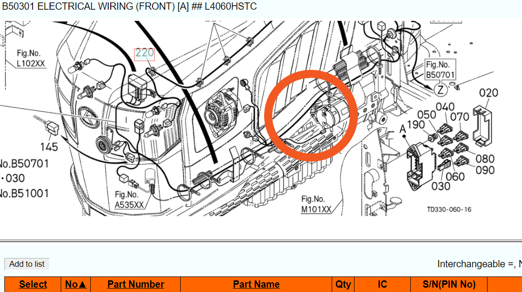

L4060 ran fine yesterday, went out to start it today and nothing.
No starting, cranking nothing.
Battery seems fine, jump start made no difference.
PTO switch is off
OPS seems fine
All cab fuses are good.
4 larges fuses under the hood are fine.
No codes, all dash lights and indicators normal.
HST pedal is in neutral.
What am I missing??
Hate to call dealer if its something simple.
Thanks in advance!

Does the dash turn on? If not computer or electrical supply.
I haven't checked in a while but I'm pretty sure the dish complains about safety sensors (pto, pedal, etc) being tripped.
If the dash is fine & working, probably loose wiring to the starter relay or a bad relay.
   / HELP L4060 wont start
Dash turns on. Will check the wiring to the starter relay.

FIXED: Thank you!
It was the wiring to the starter relay connection. We are doing Hurricane Michael cleanup which is just untold debris and somehow the starter relay connection became unplugged. Plugged it back in and voila.

Where is that plug? Something us L4060 should be checking do you think?
