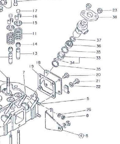

I have completely disassembled 2 YM1110D heads and didn't have any problems removing the injectors, though I have heard that they can be trouble. As someone else said, soak the area with a penetrating oil overnight. Also someone once told me that you should loosen the retainer (back off on the two nuts holding the retainer against the injector a couple of turns), then just turn the engine over a few times and the compression should pop them loose.
For the others, I have attached a scan of the parts diagram for the injector and retainer arrangement. The nuts to loosen are labeled 23, the injector is not labeled with a number in this diagram.
