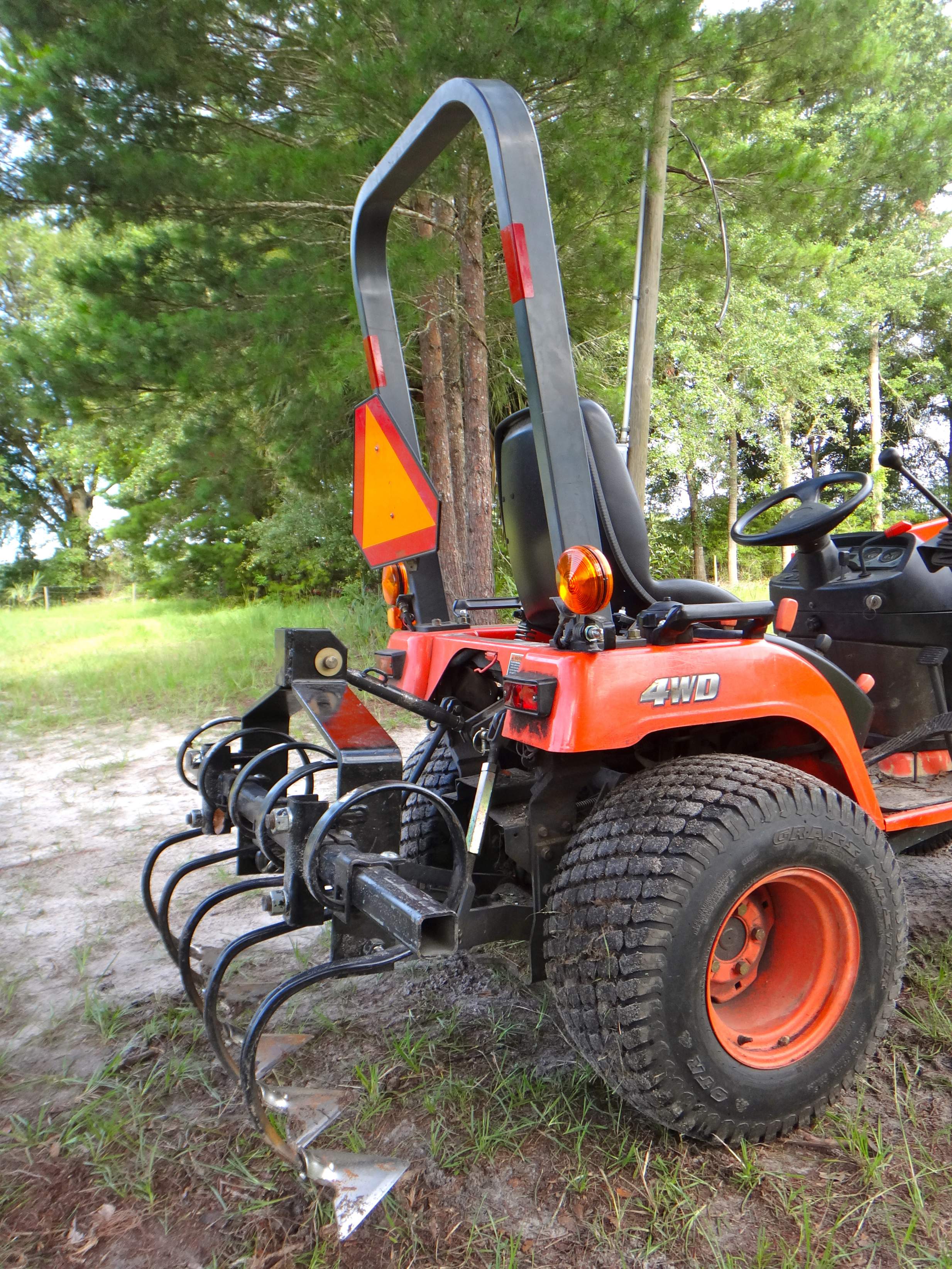

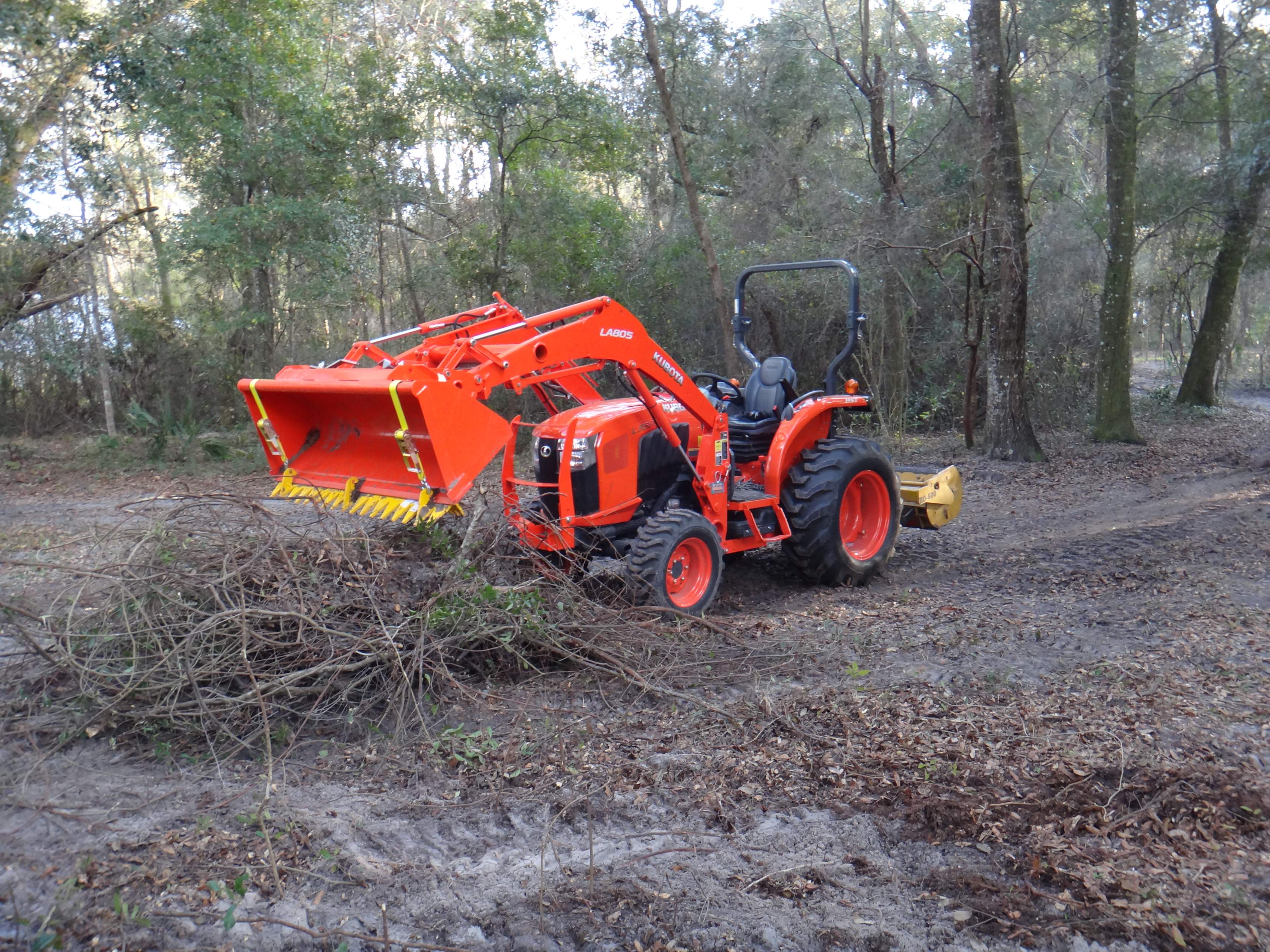

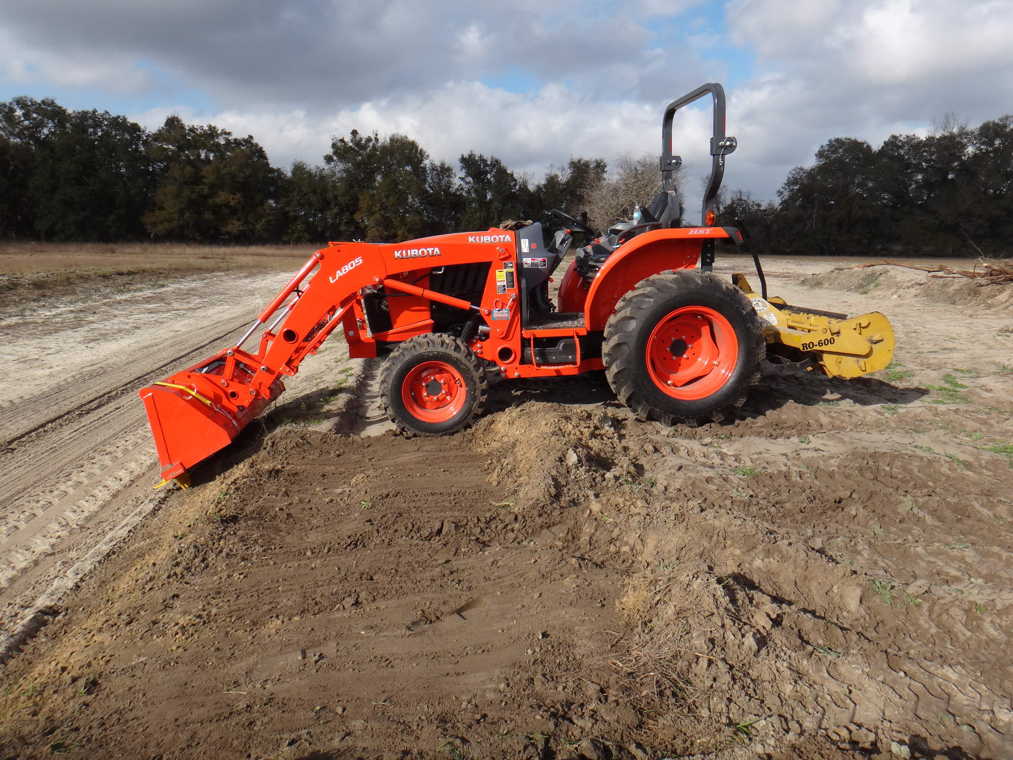

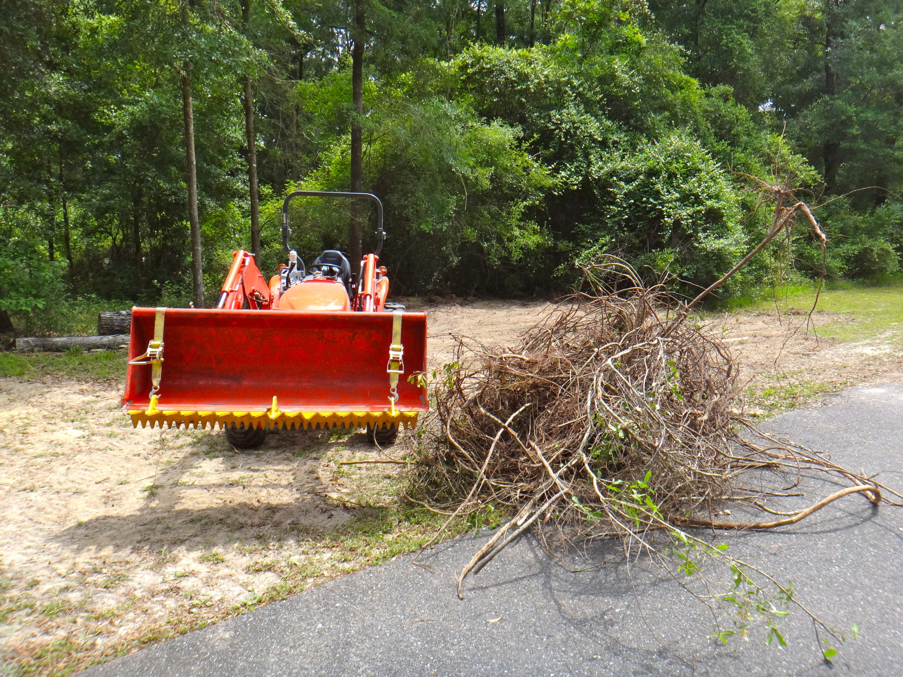

For opening a Kitchen Garden, light grading and light land clearing a Ratchet Rake attachment for your loader bucket is all you need to start. I would buy a Ratchet Rake and see if you can tolerate that IH300 until the budget is stronger. One big question: Does the IH 300 have power steering?
VIDEO: RATCHET RAKE - YouTube
After experimenting with the Ratchet Rake, consider a Three Point Hitch conversion, which will allow you to use all contemporary Three Point Hitch implements, unless the Hi Utility factor interferes.
When you eventually replace the IH300 you will want a tractor with a bare tractor weight of ~~~4,000 pounds,~~~ close to what the IH 300 weighs.
