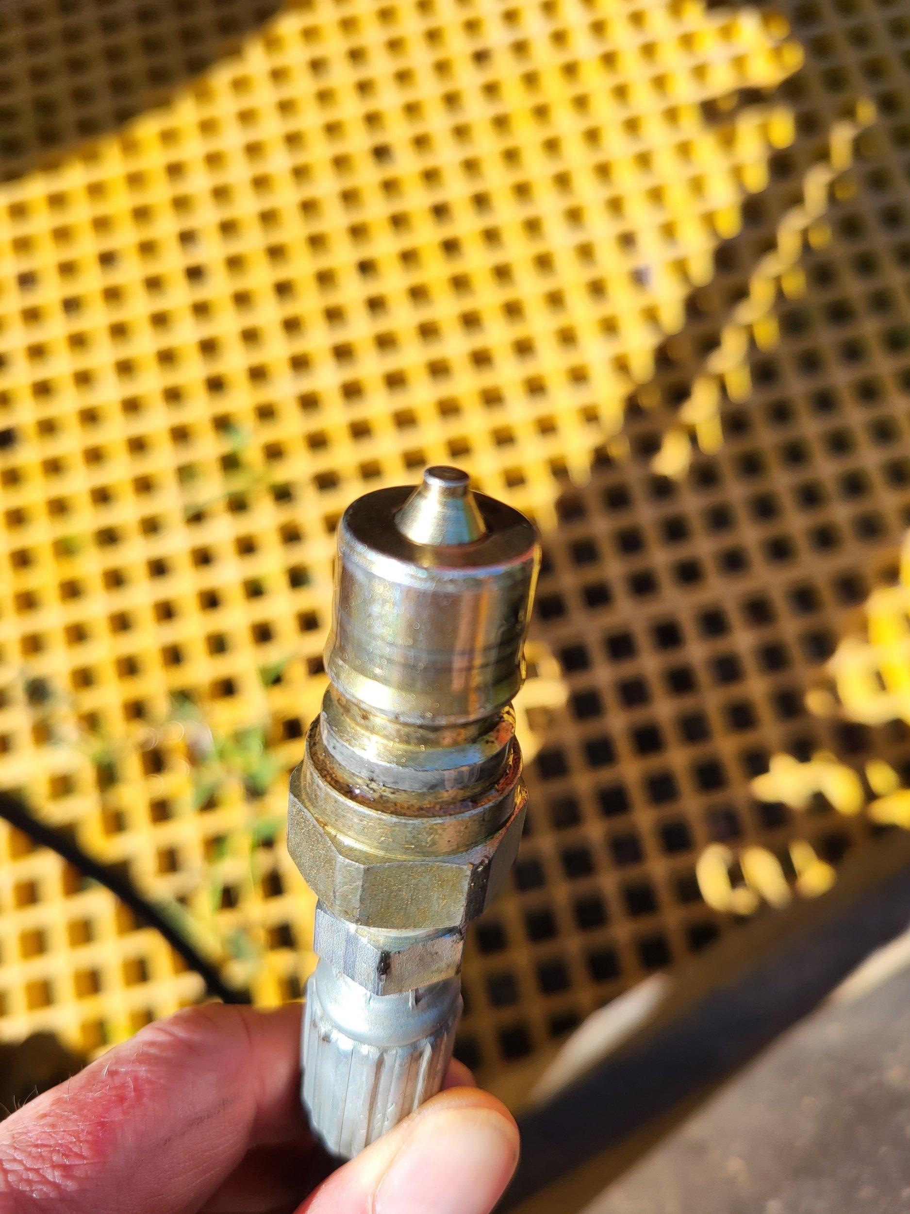

Skid steer couplers are usually flat faced couplers. Kubota uses Pioneer style couplers for the most part. Trundle down to your local TSC or tractor dealers and buy a set of Pioneer females to match the ones on your tractor.
Flat faced and Pioneer won't interchange and there are no adapters that I know of.
Had that issue with out skid steer and changed them to Pioneer

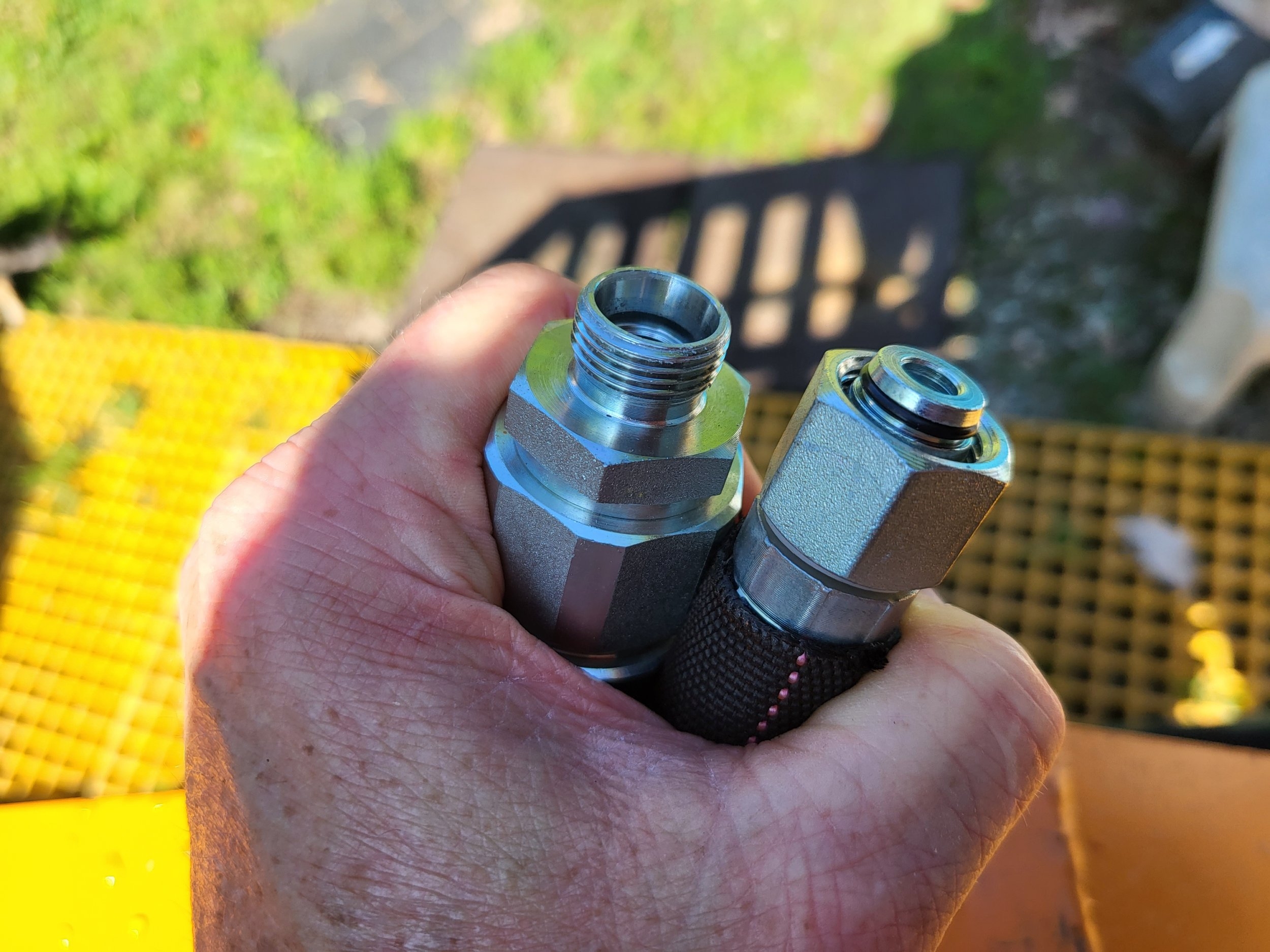

I found, on the grapple side, 18mm-1.5 straight female threads with an o-ring. I am not sure what this thread configuration is called, as it isn't NPT.

Tractor side, in thumbnail. I suppose they are "pioneer" style.
This is the skid steer side, coupler on the left and hose end on the right:

This is the skid steer side:
Those fittings are DIN 2353 metric fittings. Also on the coupler in your hand looks like there is an adapter from Male 1/2" BSPP to M18x1.5.

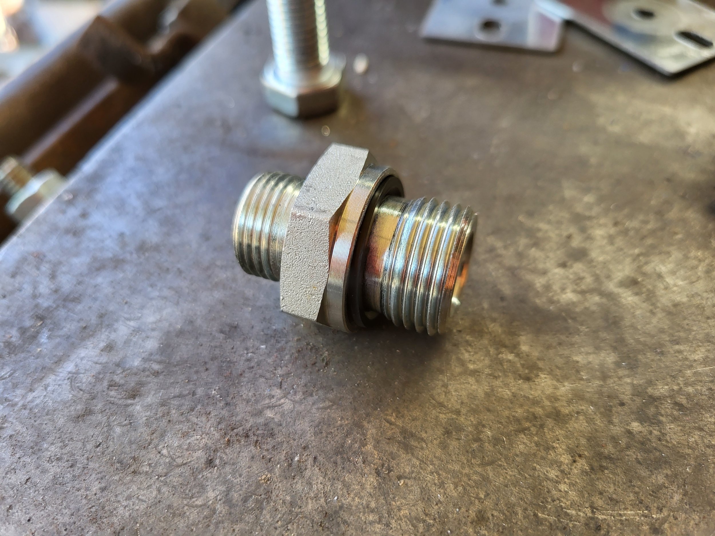

OK, pulled the adapter from the quick coupling and found it measures .819"-14 male, straight threads with a flat rubber washer, instead of o-ring.
Yes, that's an adapter M18x1.5 to 1/2" BSPP. That one has the rubber washer incorporated. Some times they use a dowty washer which is a washer with a rubber ring molded in it that takes care of all the sealing it needs.
