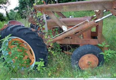

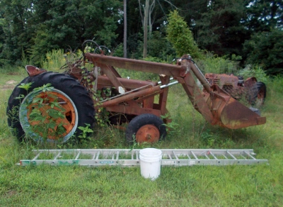

Hi, was wondering if anyone might help me identify this tractor. It's an old Case with a front end loader. I'm guessing it's anywhere from late thirties to forties or thereabouts, but might be a later model than that. May be a SI Industrial type or SC-4 with fixed tread width axle?? Haven't been able to locate anything with a serial number or model number etc. Have attempted to look in the normal places for something that would help identify it, but not having much luck locating a plate that has a stamp of any kind of serial identification. Just wondering if there are any Case enthusiasts that might have an idea just from looking at it. Thanks!

If its a Case the serial will be on a plate on the dash and also cast into the bell housibg flange behind the air cleaner. To find the year take the firts 2 numbers and subtract 4.
My Case starts with 49 so 49-4 makes it a 1945.
The model will also be with the serial.

Thanks Mike. I'll try looking again to see if I can find any kind of model number in those places. Sorry the pictures are not real good. I'll try to get some better ones. I downsized them a little, as I was afraid I might be overloading on the uploading.

I looked a little close at the pictures. It looks like a SI. Note the flat grill not the curved one like on the regular S series tractors. The rear wheels look to be the wrong ones for it. Those look like 11.2-38 but the tractor should have 12.4-28 rears on it and the center wheel is different than the ones used on the SI.
/ Help Identify This Tractor.. #5
I'd guess an SI also. I had one about 15 years ago. The rears were a heavy cast solid hub type rear wheel, kinda' matching the fronts. Looks a though someone switched out to a set of Ag. wheels.
A guy and his son saw it, and made me an offer I couldn't refuse on buying it. Supposed to be the son's project in College, to restore. Sure would like to see it if he ever finished it..!!

Hi and thanks very much for the replies. I've been getting home late from work all this week. Unfortunately I haven't had a chance to get back out there and get any better pics or look for the serial/model #'s yet. I will probably have to take a brush or something and do a little clean up job to have better luck locating the id plate for it. I did find out that Case made some of the SI types for Airborne use back during WWII. They also made a Model 30 Powerloader? supposedly based on the SI form, so wondering if mine might be of that type.
