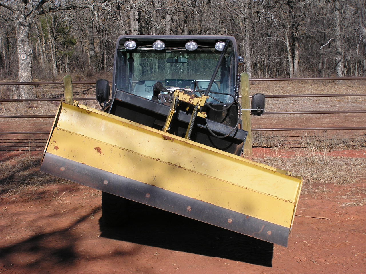

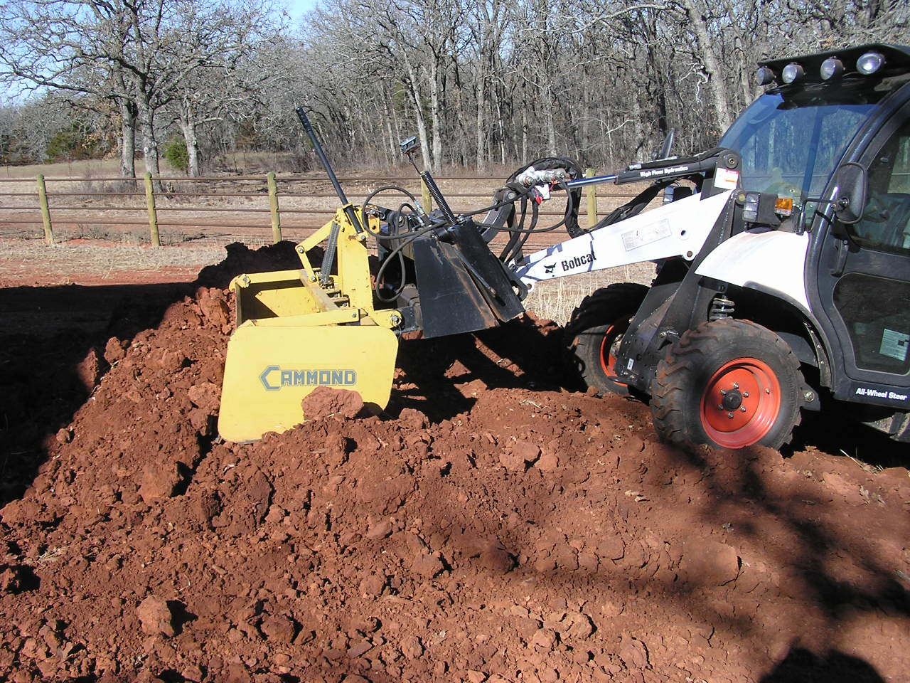

Thanks, Thanks a lot now theres something else on my must have list. lol
I even use a box blade on the Tilt-Tach.
