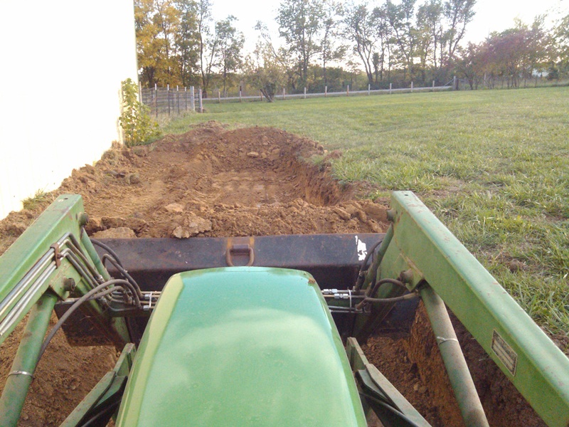

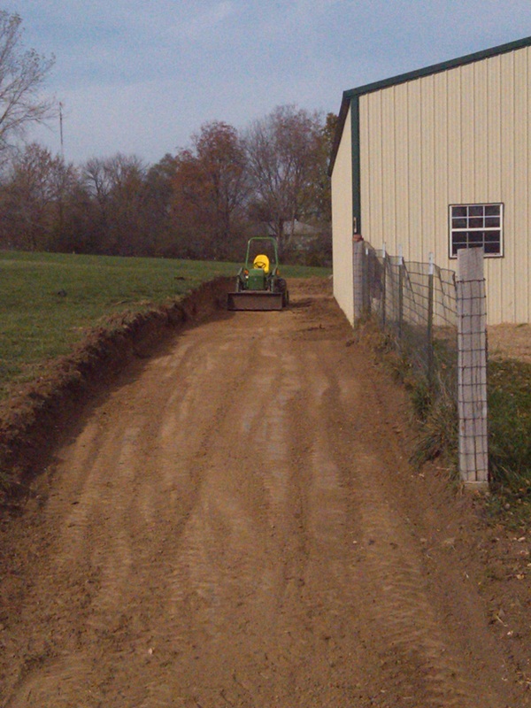

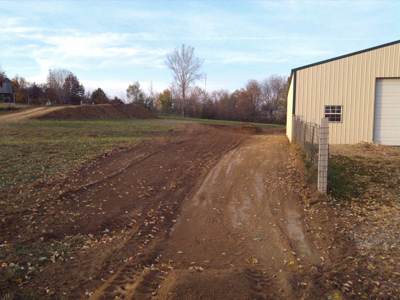

/ Help: How to level with a front end loader #31
Thanks, Thanks a lot now theres something else on my must have list. lol
I even use a box blade on the Tilt-Tach.
P2100029.JPG P2100032.JPG P2100035.JPG P2100038.JPG P2100039.JPG P2100041.JPG
/ Help: How to level with a front end loader #33
I have a FEL, brush hog, and 12" auger. So not much of any of what you used.
Not so, Mate. The only thing you don't have, that I do, for the job that I described is a tiller. You can easily hire a walk-behind tiller from a garden centre... Actually, your Mate that you're doing the job for can hire that! :laughing:
Then it becomes a two man job.
