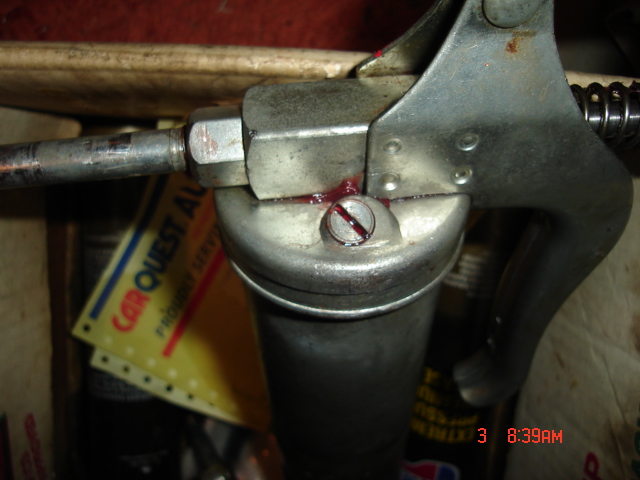

Concerning the grease gun, jbbcd-- ditto what others have said-- most likely culprit is an air bubble. My standard small gun has an air bleed, but my mini doesn't-- patience and a willingness to get your hands greasy definitley help here! :D:D You kinda hafta be quick at pulling back on the spring-handle and stuffing the bleed plug back in before lubing the whole shop....:rolleyes:
