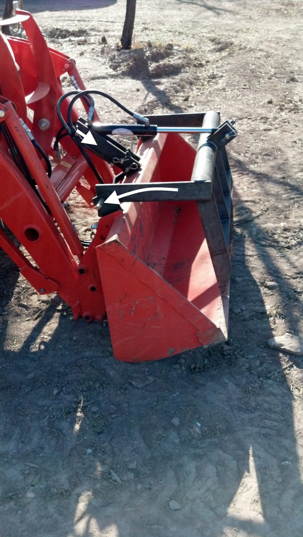

I think you can use the cylinder that you have.
Lengthen the top lid arms, where I added the curved arrow to your picture, at an angle that will keep the tips touching the front edge of the bucket.
Lower the cylinder base pivot to where it is slightly above and behind the lid pivot, with full extension.
The lower base pivot will let the lid open wider with full retraction.
You may have to make the rod end bracket a little longer or drill the hole in the top corner so the rod doesn't touch the lid.
Edit: I posted this in another thread and thought about your modification.
Look at the pivot points in the highest position, this is what you need.

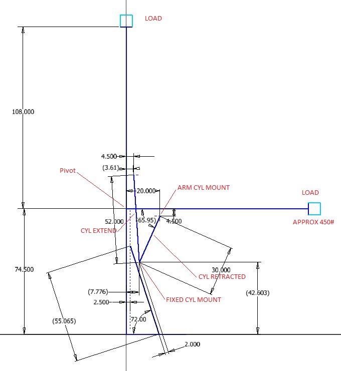

Another way that makes them simpler to figure out, is to use a 2D CAD software or sketch in 3D CAD to mock up your motion.
You don't need to draw your design, just some lines to represent your cylinder, and mechanism at stop and end point, pivots, etc.
What it does for you, is that it'll solve all the geometry formulas for you, and tell you where to put your pivots for a given length cyl, or vice versa.
Here's one that I did recently for a work-related project:
You're looking at the load in two different positions, horizontal and vertical. I've got the vertical fixed mast and angle brace which has the cyl mount on it. The dimensions in parentheses (x) are being solved by the sketcher, and I input the rest.
Basically, I ended up changing the geometry to spec a standard cylinder, but in that example I solved for the position of that lower pivot. I could have hard dimensioned that pivot and asked it to find the other one, or the angle of the brace, or basically anything ....
Without farting around in the shop making mockups, this is sure an easy way to do it. There's lots of free cad out there that should be able to do this simple problem.
