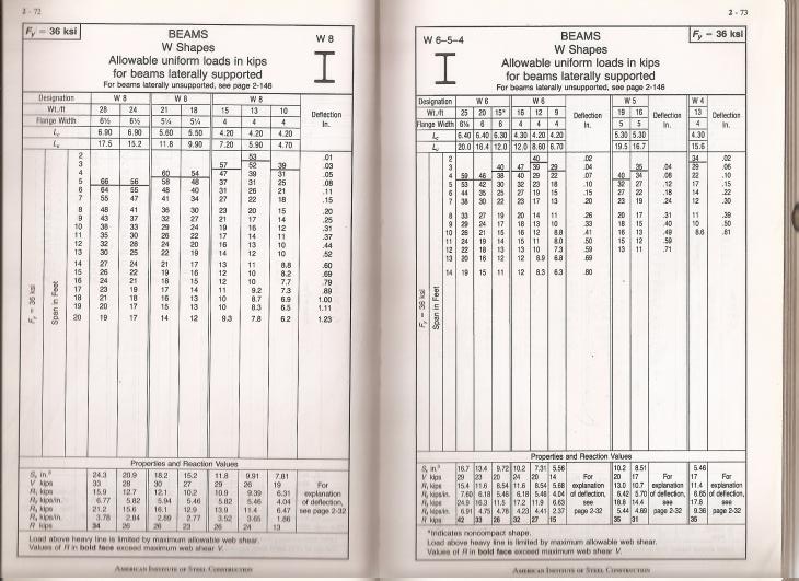

newbury that chart I posted above. I found that on a gantry crane web site. So those are point loads in the center of the span. They are not allowable uniform loads. Generally points loads are about half of uniform loads.
Here is a chart for W shapes, they are stronger than S shapes. They do sell trolleys that will run on the flange of a W shape.
