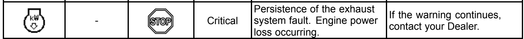

HELP - engine symbol with kW and downward arrow inside accompanied by STOP

UPDATE: So my tractor doesn't have a DPF

If it uses DEF it has a DPF, if it doesn't use DEF they will have a similar device called a DOC. DOC is a Diesel Oxidizing Catalyst, they rely on exhaust temperature to stay clean also, but with usually less problems then a DPF.It may need a dealer reset, or you may get lucky by disconnecting the battery for an hour or so. They both have temperature and pressure sensors.

found this in my manual

Likely an exhaust senor has failed.
   / HELP - engine symbol with kW and downward arrow inside accompanied by STOP #18
Or, regen could have been canceled enough it won't try to regen again. I know you are trying to fix this yourself but I think you're out of luck. It probably needs to have a parked regen done by the dealer.
   / HELP - engine symbol with kW and downward arrow inside accompanied by STOP #19
I'm going to agree on probably having to take it to the dealer at this point. One of my NH tractors would let me do a manual regen but the other would not. I had some issues with it when it only had about 10 hours on it and ended up having to haul it back to them to get the parked regen done. The good news is, it could be worse. This should be a relatively quick fix if the dealer will get on it.
