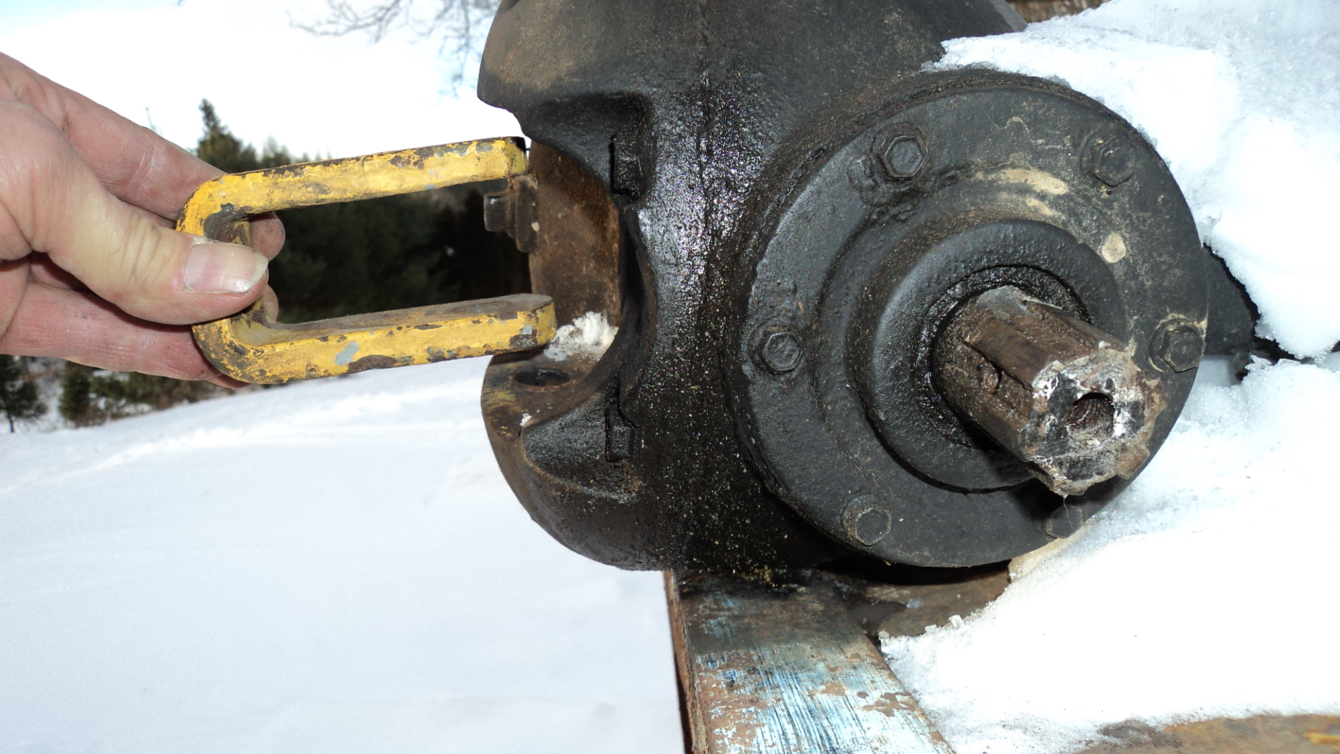

I'm in the process of fabricating a PHD to be mounted on the thumb of my back hoe .The tractor is 45 hp with a 14gpm hyd pump~2500psi. The back hoe is plumbed by a rear remote with 1/2" lines . This project is twofold being that when the phd is not installed my intent is to use the new hyd lines for the new hydraulics on the thumb( as it is now it is mechanical).
Where I could use some help is picking the right hyd. motor?... would this one supply enough... ?
Pump option
7.63 CU IN PTO DRIVE MOTOR
coupler
1-3/8" 6T SPLINED COUPLING 167-02206
Valve ? double solenoid plumbed before the(P/T) hoe's valves with A/B supplying the auger ...?

A couple of critical questions are:
How much torque does this size auger require for the ground you will be working in?
What Rpm do you want the auger to operate at?
The answers to these will help dictate the motor size required.
Hydraulic motor RPM is figured by this equation: RPM = (231 times GPM) divided by motor displacement in CIR (cubic inches/revolution)
Hydraulic motor torque is calculated by this equation: In lbs torque = (PSI across motor times CIR of motor) divided by 6.28
The motor you have selected would operate at around 400 RPM @ 14 GPM & develop 2400 in-lbs at 2000 PSI pressure differential. Depending on line losses etc. you may not get this 2000 PSI.

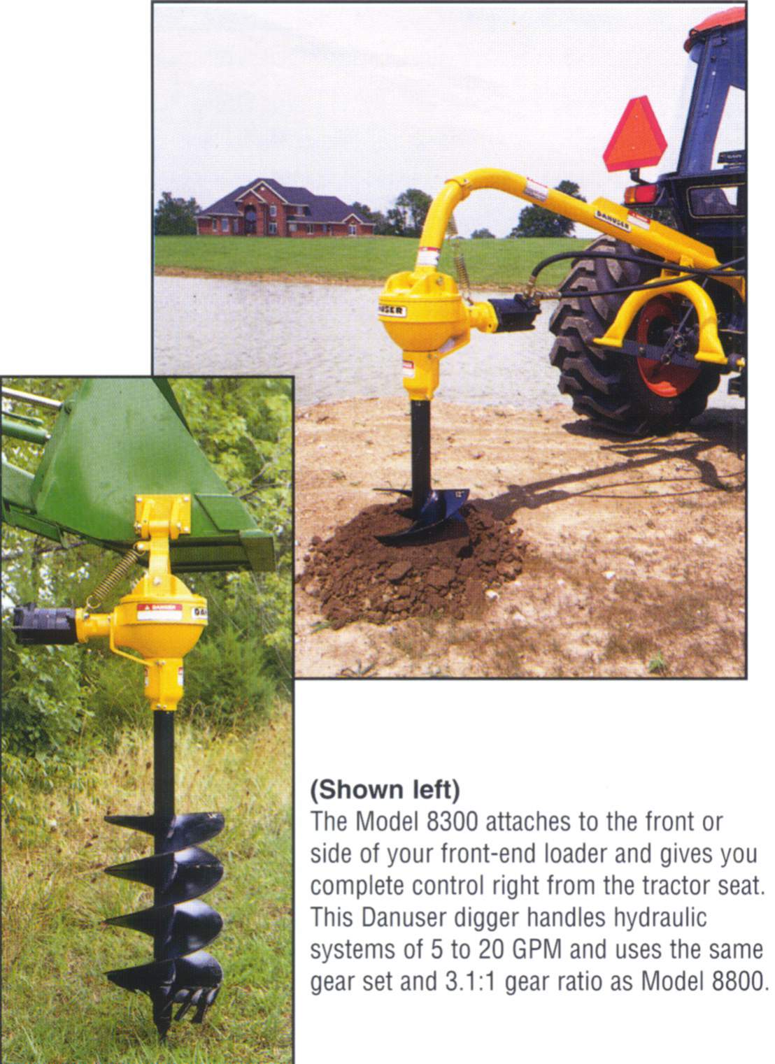

Will you be doing something like below, or direct hyd motor drive?

I am building something like the danuser JJ linked to ...my power head is a 2:1 ratio reduction. Concerning the final rpm of the auger I'm old & slo also so some where @ 100-200rpm would be acceptable with torque@3000 in lbs. it should be good to go ?
