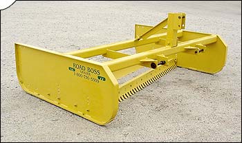

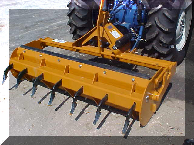

Have you seen those roll over box blades, and some other products? You just pull a lever, and the box rolls over to rip or grade.
